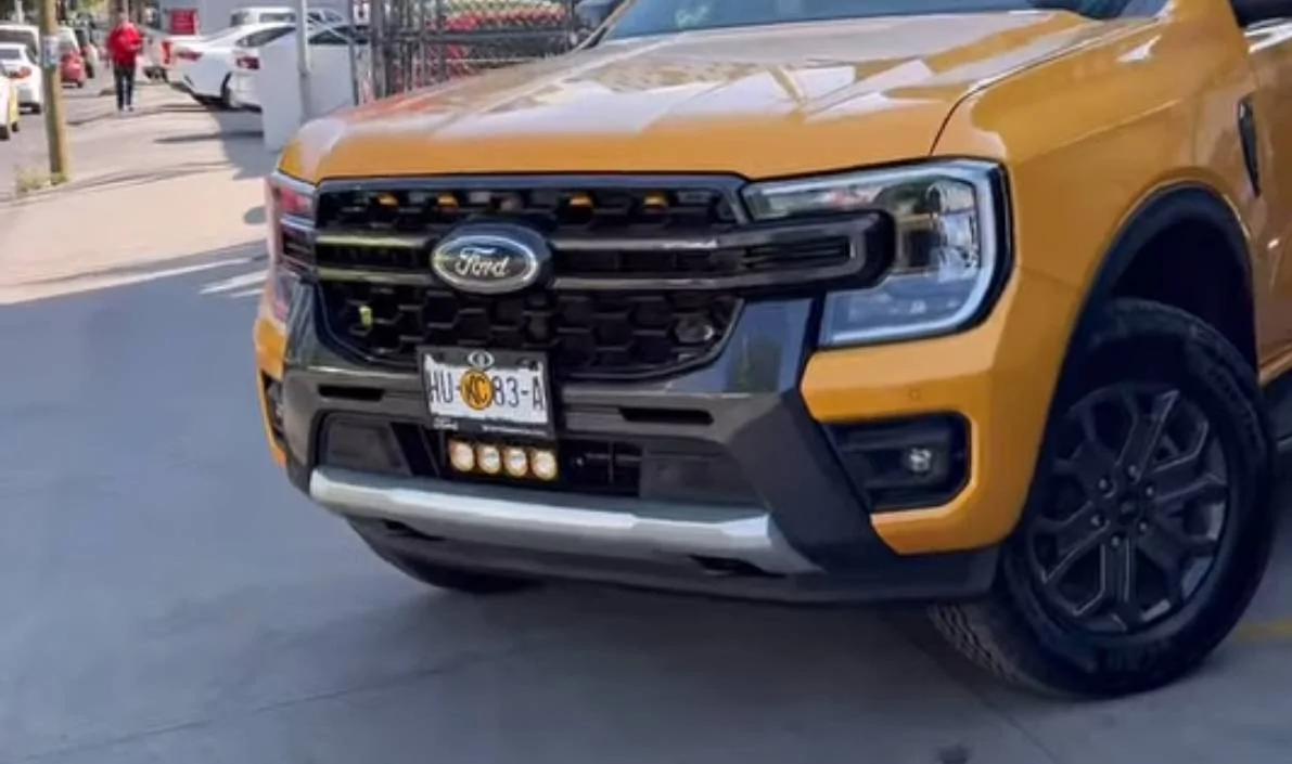

I found that there are people placing lights below license plate, I found that are some thread holes there.
Ford Ranger Fog lights below license plate IMG_8263
Did someone know the screw size?

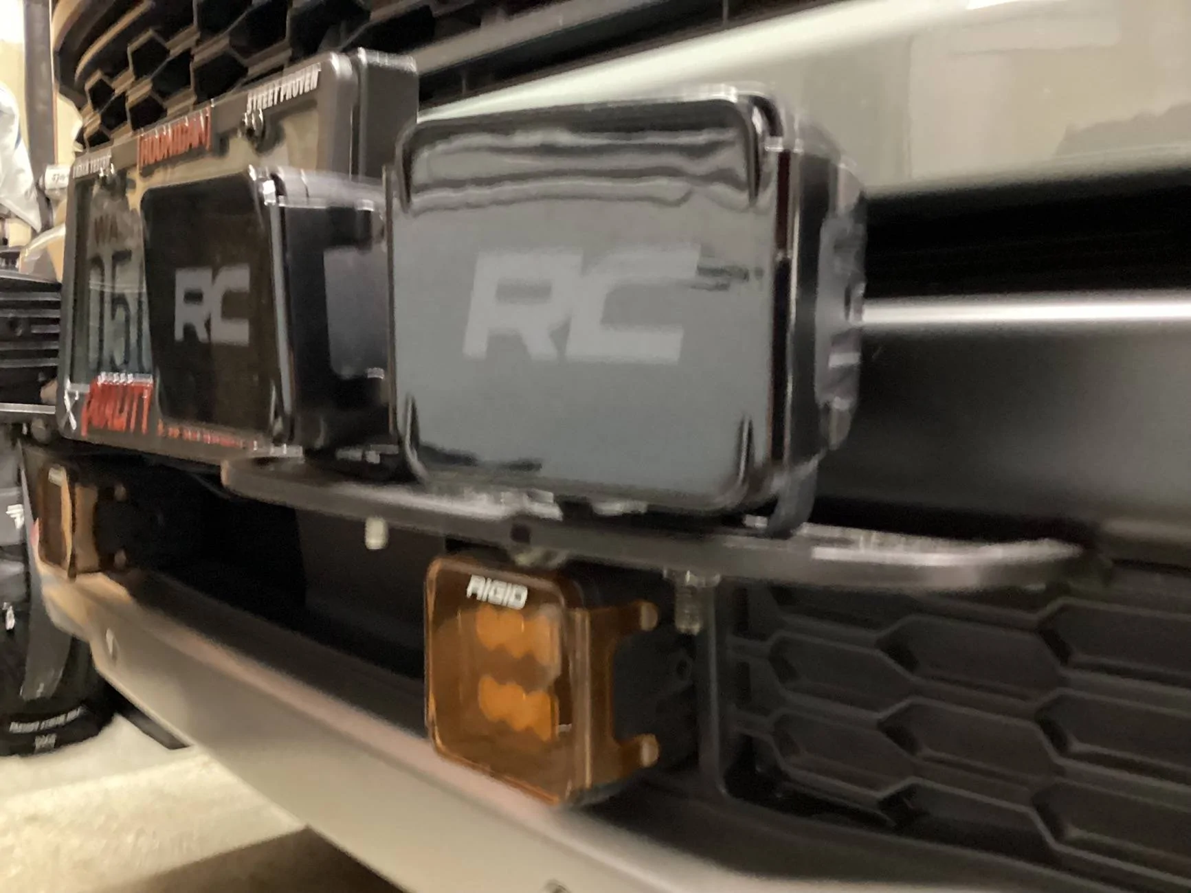

I did this on a 150 and plenty more did as well. I asked this forum and they got on my case saying bad Idea with the turbos, even though many had zero turbo issues on 150s
I'm looking to modify some lower grill inserts or the fog surrounds and put in some SS3's

thank you for your inputs guy. Probably I will make some brackets

I think they are 6mm screw size

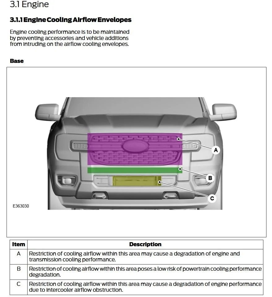

Not recommended as per body manual:
Some companies make grille screens for area "C" on the 24 Ranger. I wonder how much airflow is restricted by the use of screens?
There are companies that are placing the winch I assume they don’t care about airflow

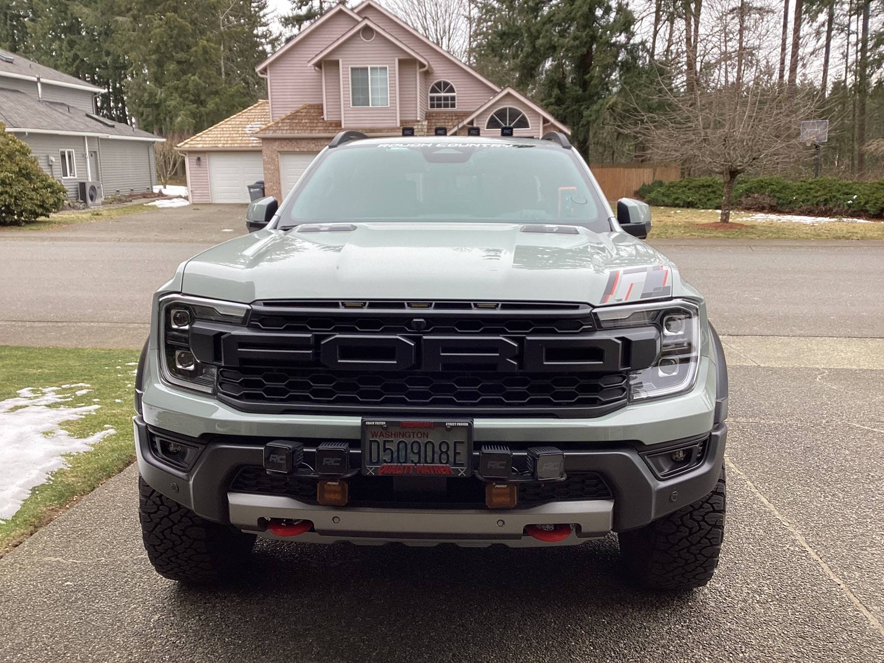

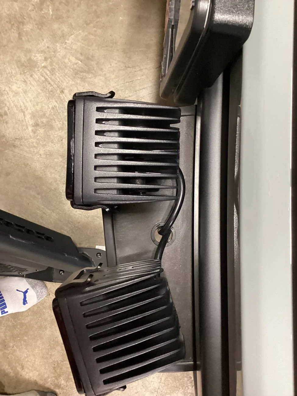

I made a D shaped 1/8” flat aluminum plate, mounted to the bottom of the upper portion of the bumper with rivnut.
Ford Ranger Fog lights below license plate IMG_0167
Ford Ranger Fog lights below license plate IMG_0166
