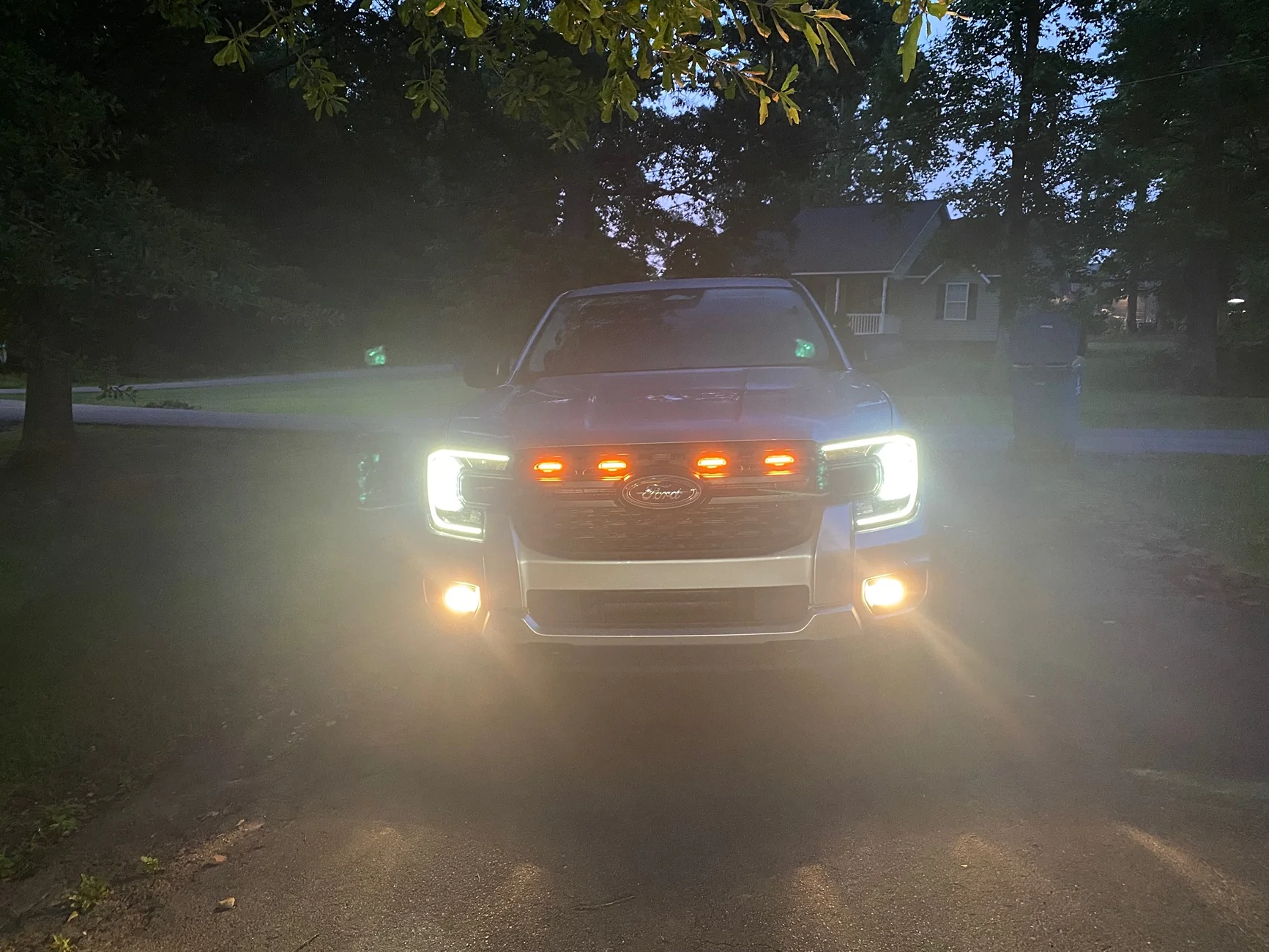

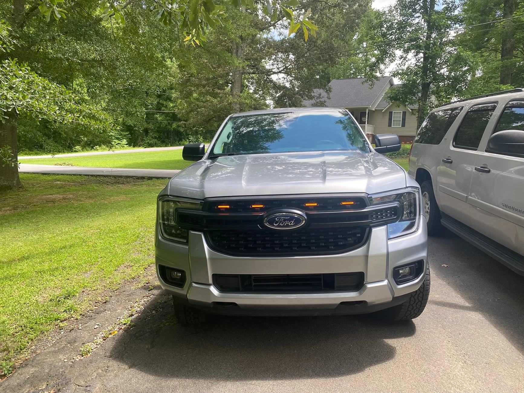

I know you’ve seen plenty but I wanted to share mine!
Ford Ranger F150-LED Grill Lights - 5 light kit fitment IMG_0922
Ford Ranger F150-LED Grill Lights - 5 light kit fitment IMG_0920

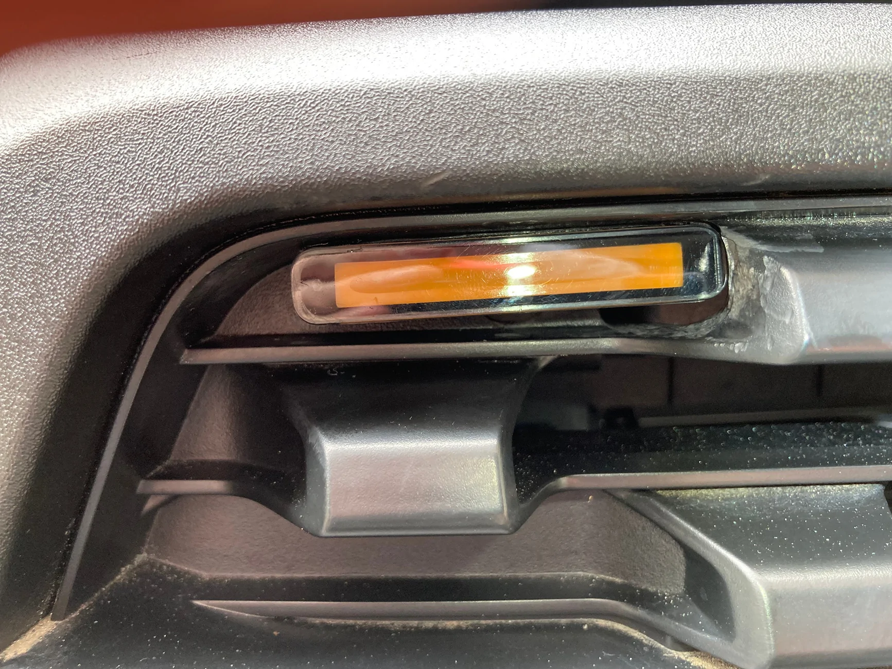

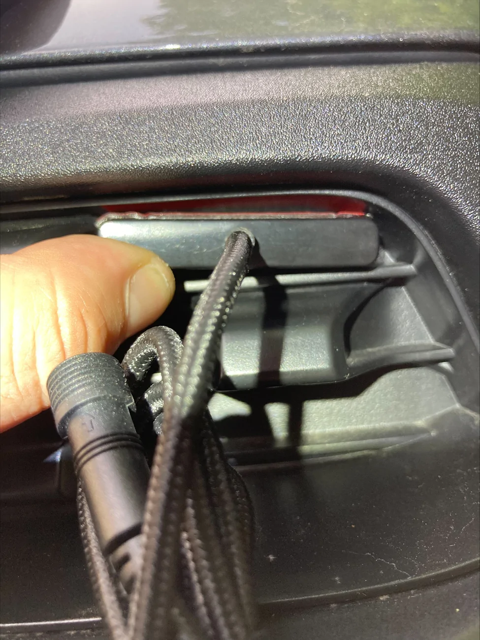

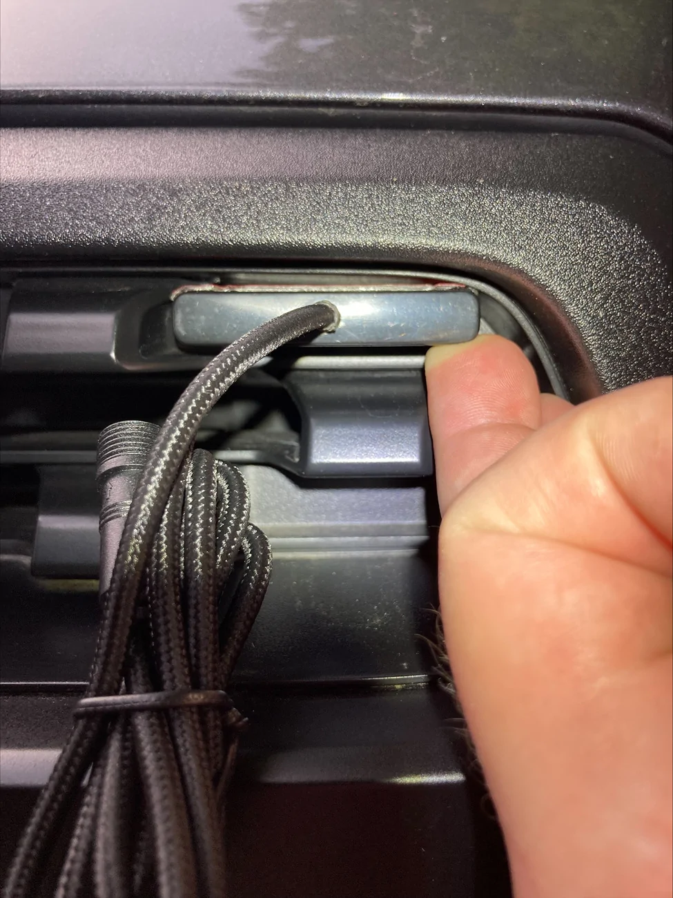

I just received the 5 light set but have not installed it yet. I test fitted them at the end grill slots that are shorter and curved and they do not fit. The sticky tape that holds them to the grill does not make contact with the curve in the end slots. Maybe with some modification to the grill they might work, but im not sure if i want to do that
Ford Ranger F150-LED Grill Lights - 5 light kit fitment processed-493F0134-F1ED-444E-AC00-E24B58439514
Ford Ranger F150-LED Grill Lights - 5 light kit fitment processed-95773EF5-1640-4EE4-8381-BBCB13676BA6

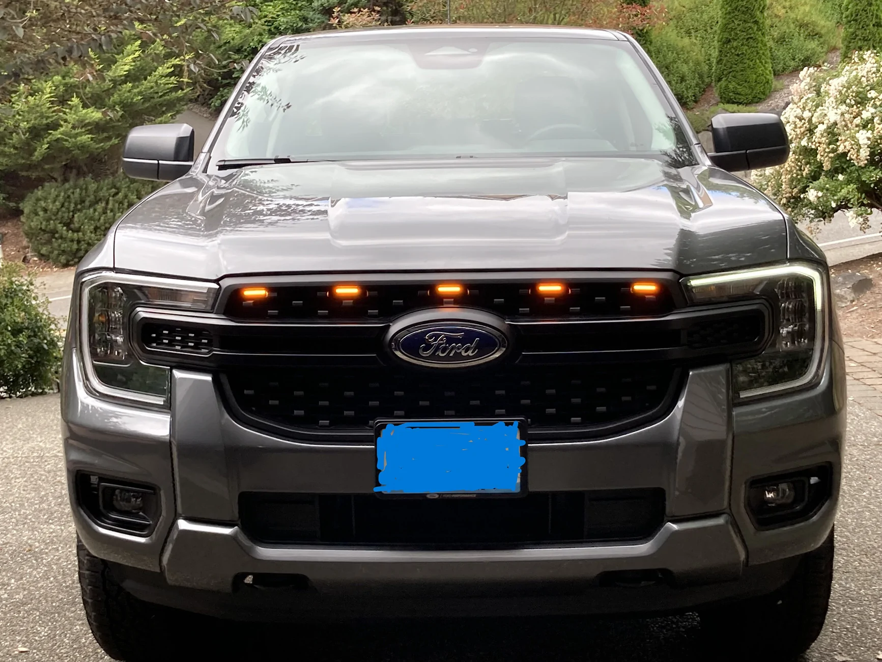

I installed my 5 light kit today. I had to take a dremel to the end slots in the grill to get them to fit. The end lights are at a slight angle compared to the center ones. Only problem I had was that after I was done they didn't work. I used the f150led adapter that plugs into the fender light for power and I soldered and heat shrink a 2 pin connector onto the end of the kit and the adapter so I wouldn't have to use those tap in things it comes with. Anyway the black wire out of the adapter was positive and the red was negative so I re-soldered it with the black to red and red to black and it worked! I'm not that good with the dremel and im sure others can do better work than me on the end grill slots.
Ford Ranger F150-LED Grill Lights - 5 light kit fitment IMG_0486copy
Ford Ranger F150-LED Grill Lights - 5 light kit fitment IMG_0488

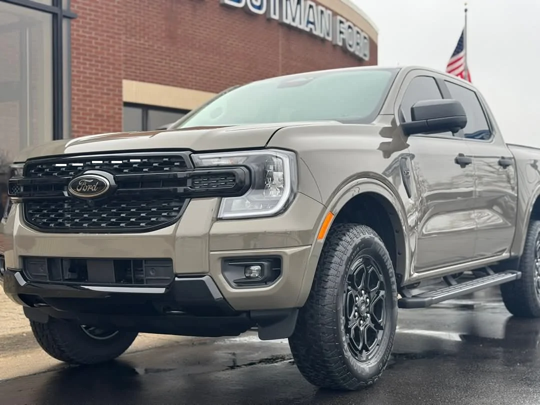

Has anyone done all 5 next to each other rather than spaced out? Kinda like this:

I'm waiting for someone to buy two kits so they have a total of 7 or 9 lights across. :LOL:
Ford Ranger F150-LED Grill Lights - 5 light kit fitment 1785868814470-yf

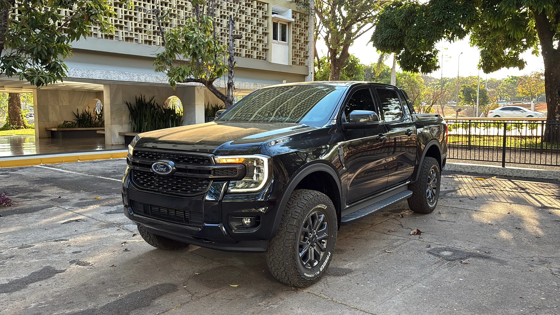

I'm deciding which one to choose. 4 or 5.
If there’s any picture or tip, it would be really helpful.
Ford Ranger F150-LED Grill Lights - 5 light kit fitment 9A6F2702-8557-467C-B9B0-773237196E88
