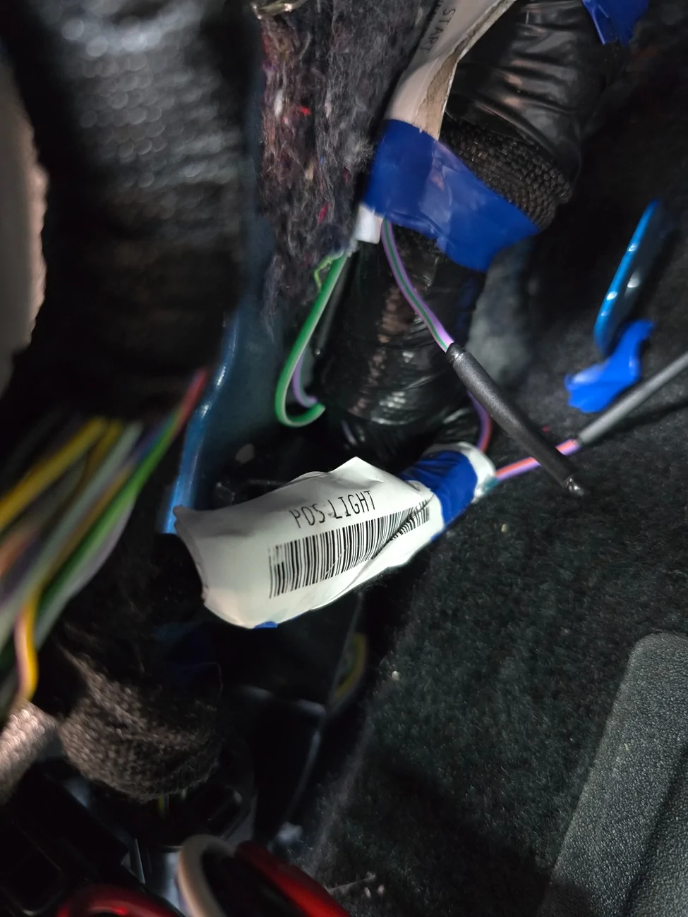

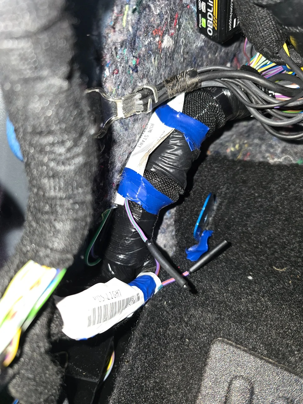

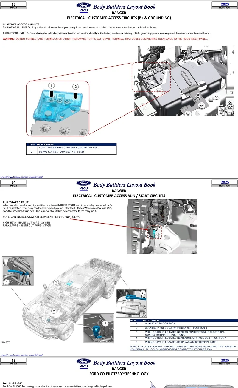

theres a marker light blunt cut wire under the bcm behind the kick panel. you can wire the backlighting to a relay that is triggered by the marker light wire. theres also a highbeam wire, and a ignition run/start wire.
my high beam and marker light wires were physically labeled wrong, and only 1 of them had matching wire colour per thr body builder guide. the labeled marker light wire was my highbeam, and the labeled high beam was my marker light.

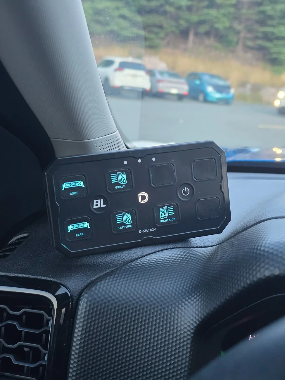

using my Diode Dynamics D-Switch, the high beam wire is hooked up to one the programable trigger wires on the dswitch, right now it activates my 10" Grote light bar. but once I finish my build, it will activate more lights.

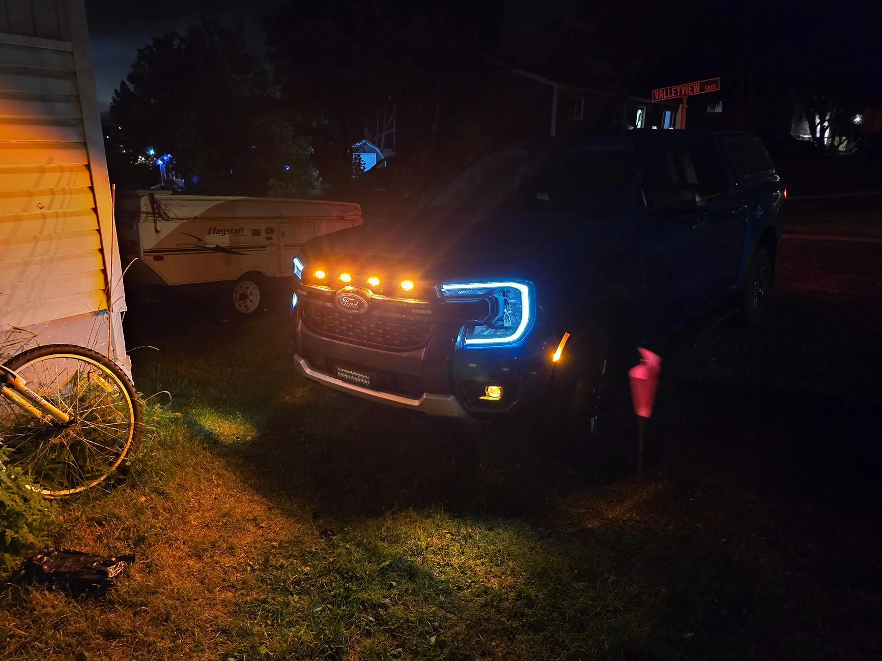

the marker light wire, is hooked up to my nightmode wire on the dswitch, and my f150leds grill lights.
and the ignition wire is hooked up to automatically turn on and off my dswitch(can manually turn it on and off with truck off) and it also powers the back light on my diode dynamics elite series foglights.

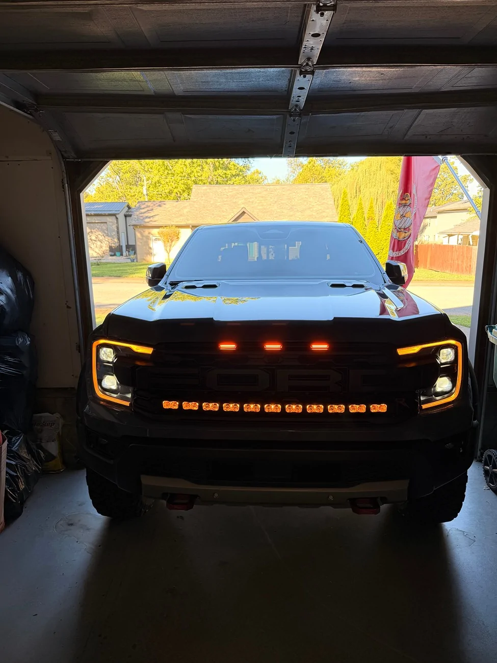

Installed mine today. Definitely a darker shade of amber than the other lights, but they look great. Much better than the old style.

They are bright but look like white diodes behind orange diffuser, that would drive me crazy they are different color than all the other amber lights 😬
