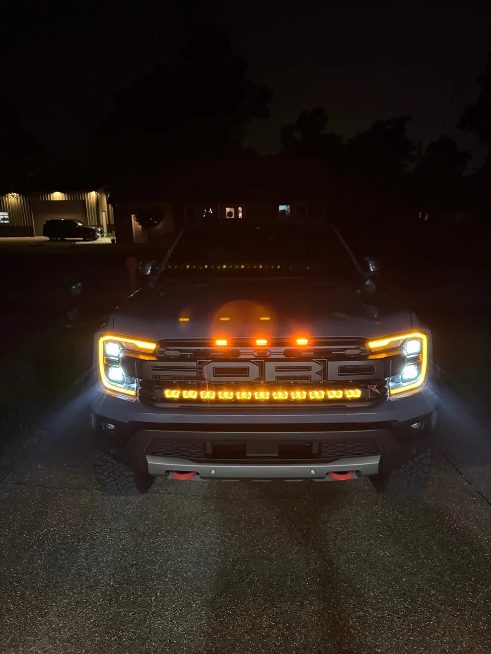

When my turn signals are on they are a dead on match.

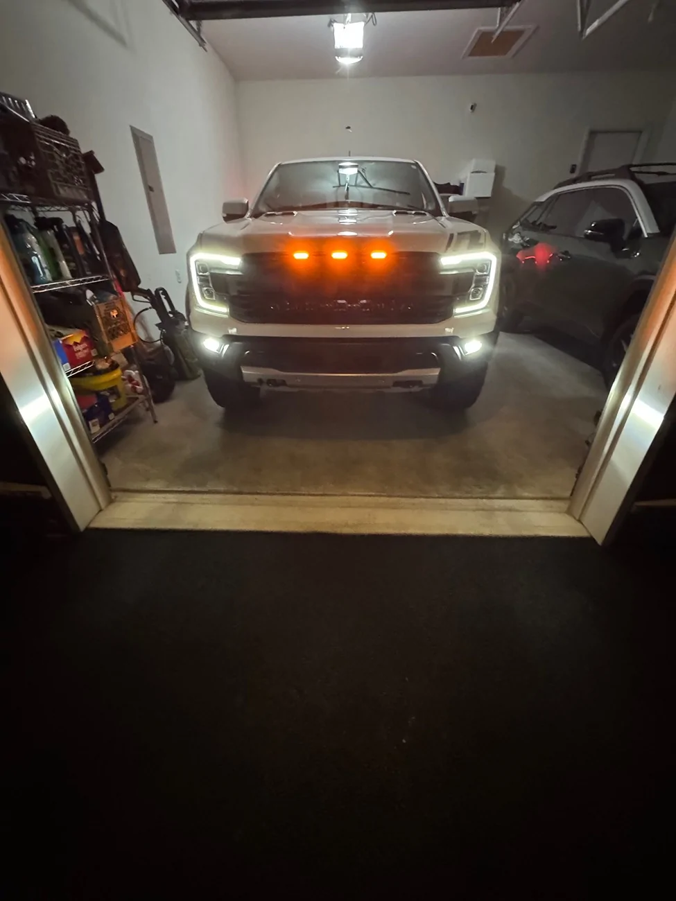

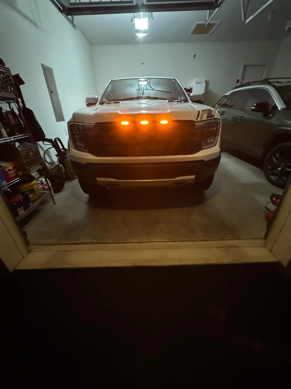

I have both the originals and the new perfect fit versions.
They do not stick out. Not that I can see.
New perfect fit version.
Ford Ranger New Ranger Raptor amber grill lights released by F150LEDs IMG_4489
Old original versions. These really stick out and do not fit very well.
Ford Ranger New Ranger Raptor amber grill lights released by F150LEDs IMG_4492

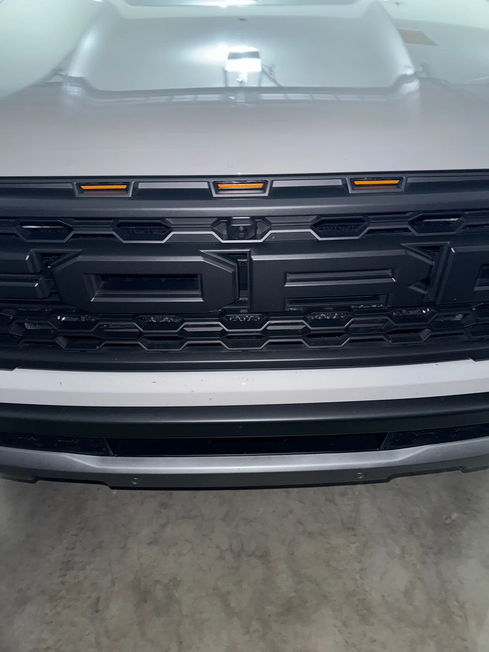

Just bought a 4th light and fitted them below.
Ford Ranger New Ranger Raptor amber grill lights released by F150LEDs IMG_2286

It ended up he had the $100 generic light kit, which does not fit well.
I think he got it worked out to get the correct perfect fit kit.
The perfect fit kit, does fit perfectly into those 3 holes .
