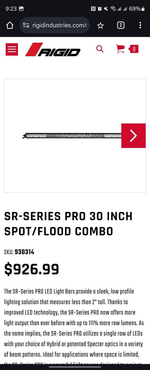

Anyone know if this bar will fit behind the grill without modifications?
Ford Ranger Rigid Light-Bar behind grill no cutting? Screenshot_20240905_092301_Chrom

It won't fit without trimming the vertical center support. My LED bar has a depth of 2.1" and barely fits without modification. The SR Series has a depth of 3"

I actually tried to mount this exact light bar the other day and it wasn't even close. I think MAYBE it could have fit if I started chopping things up but I didn't want to butcher all of that plastic only to find out it still wouldn't work. The brackets didn't line up with those bolts everyone is using either but, I think I could have made that work if I just drilled out new bolt holes on the brackets.
