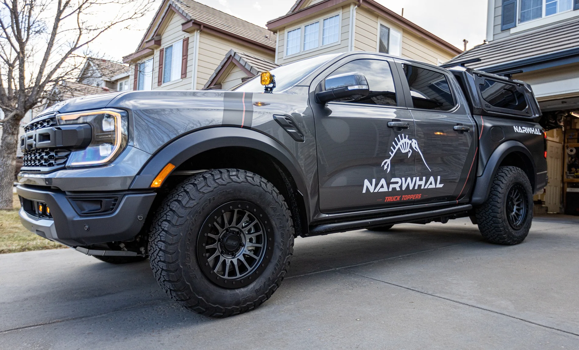

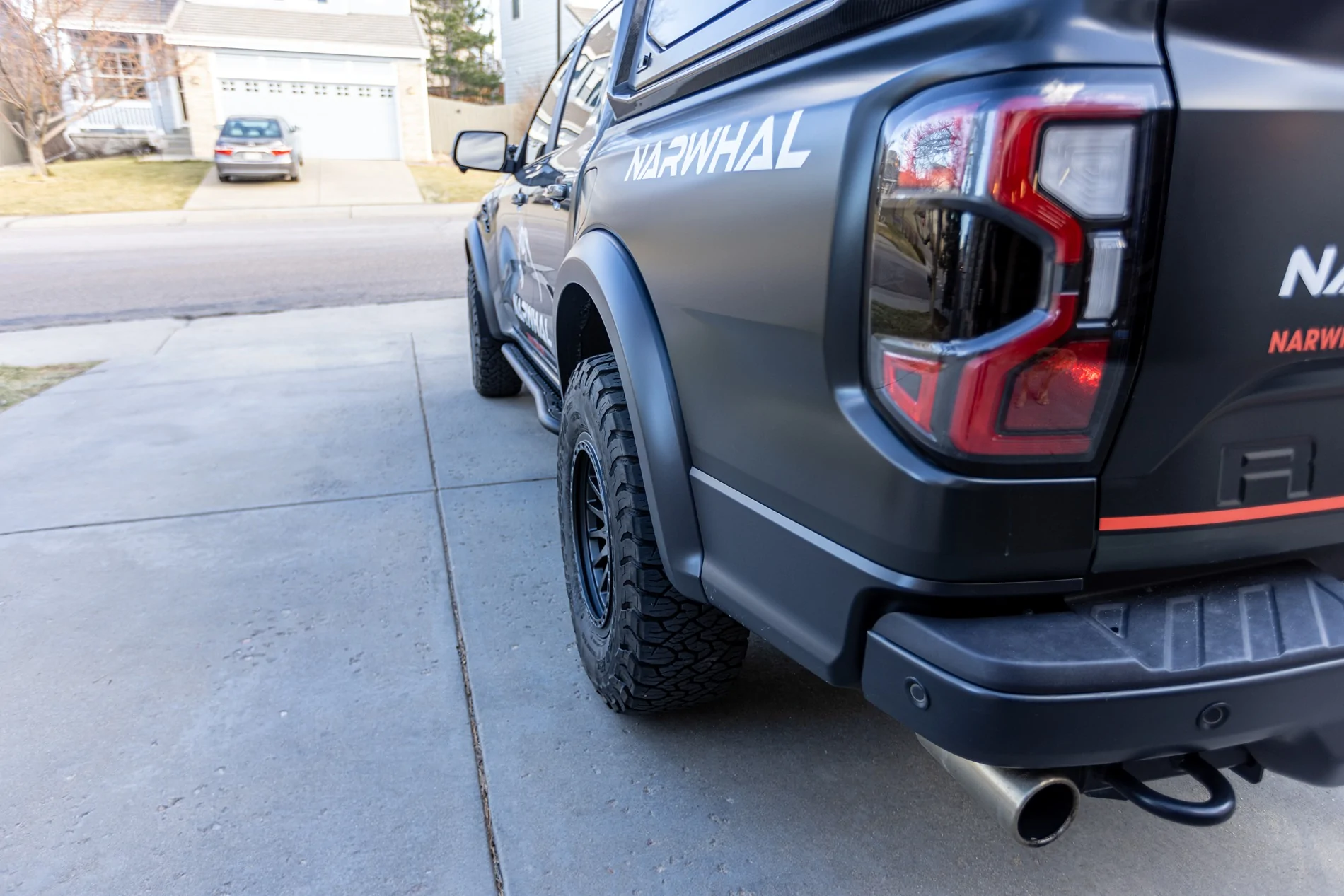

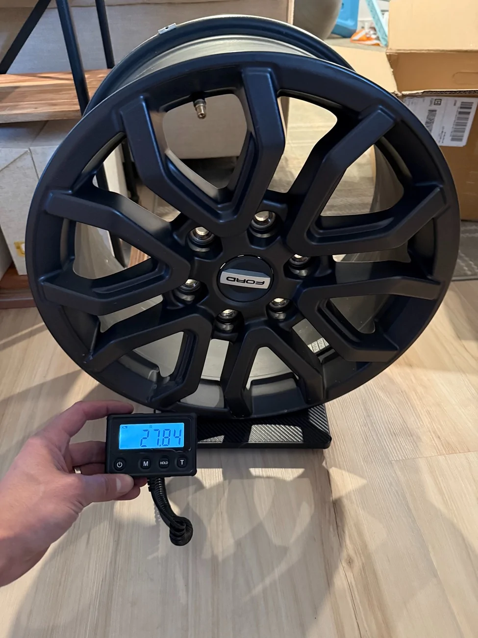

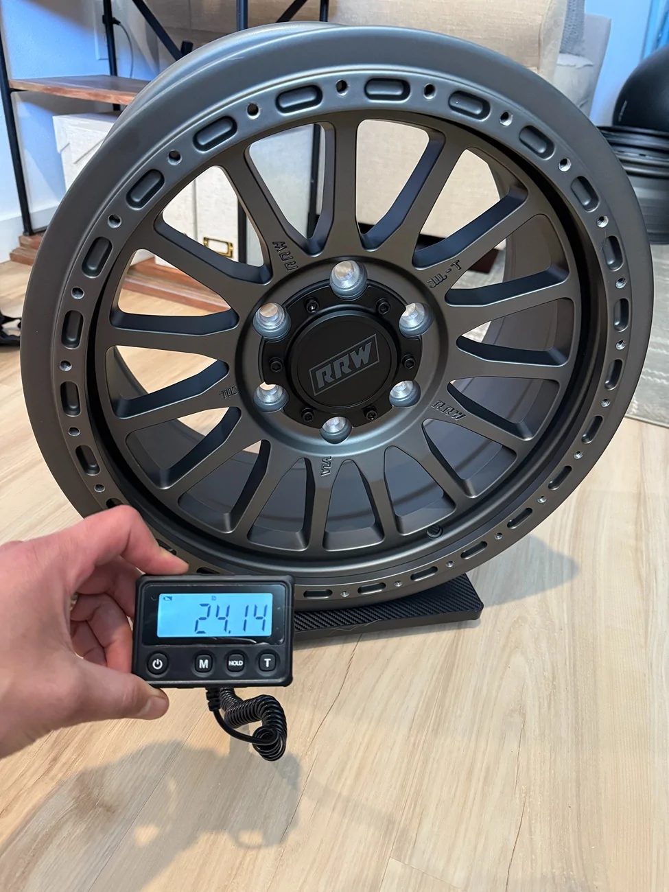

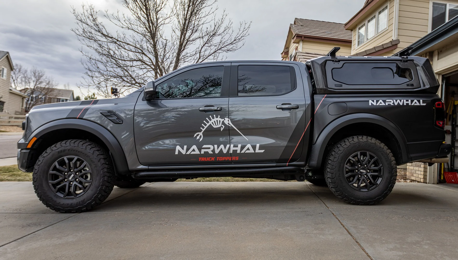

I just had a set of Relations Race Wheels RR7-H flow-formed wheels in matte gunmetal with the black protection rings installed. The wheels are +25 offset and lug-centric for the Ranger. They are not hub-centric and require RRW's lugs ensure lug-centric fitment. The wheels weighed out at 24.14 lbs, compared to the OEM non-beadlock, which weighed just over 27 lbs.

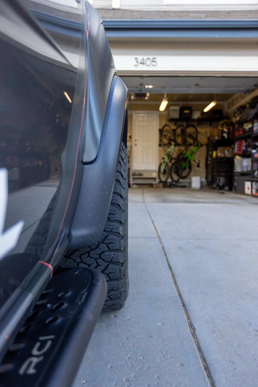

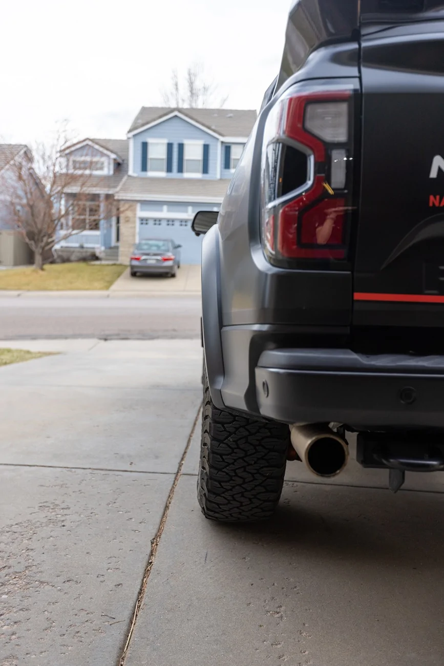

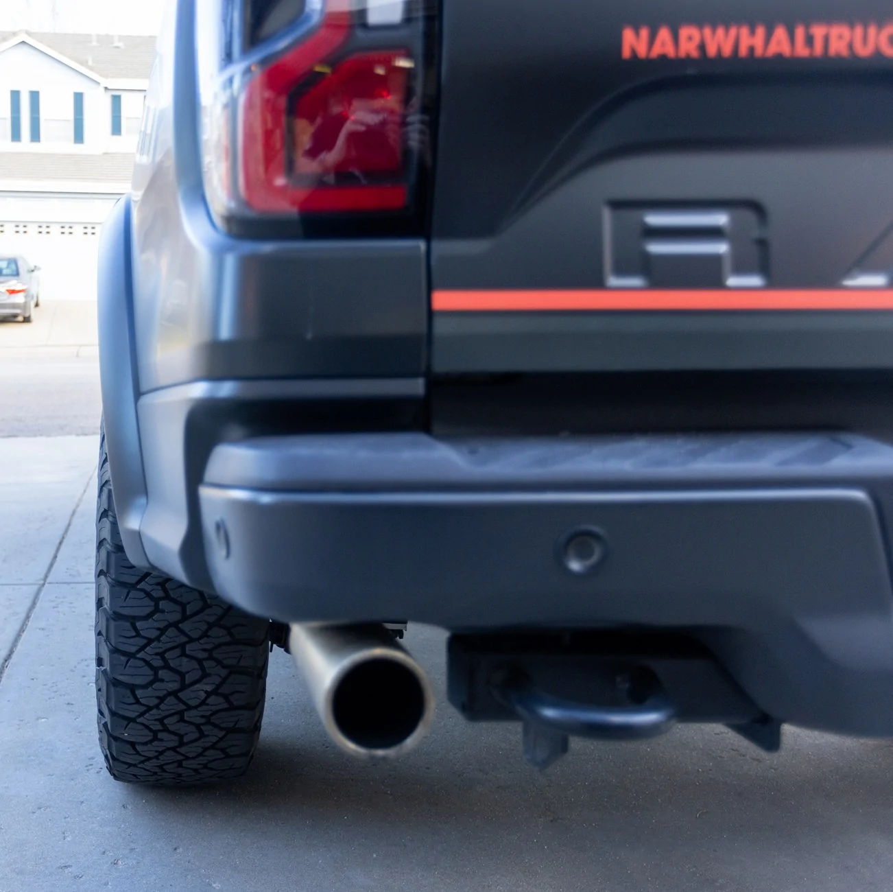

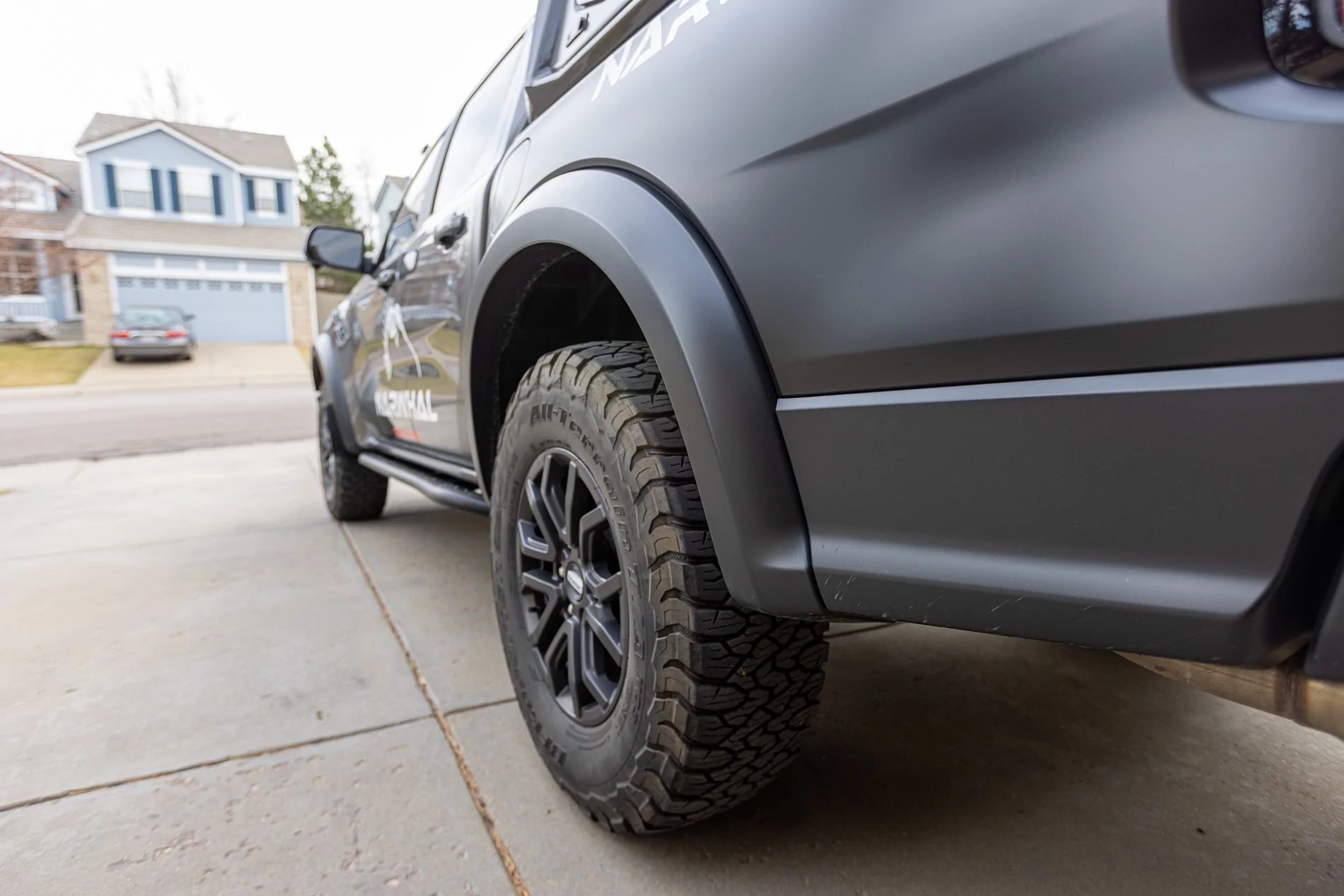

Here are some photos of the before and after. The truck's stance is night and day. It has bothered me from day one how tucked in the stock wheels sit at +55 offset. +25 fills out the wheel well nicely and sits roughly 2.4 inches wider on the track width. From everything I've gathered, I should be able to still jump the truck without rubbing.
Before at +55

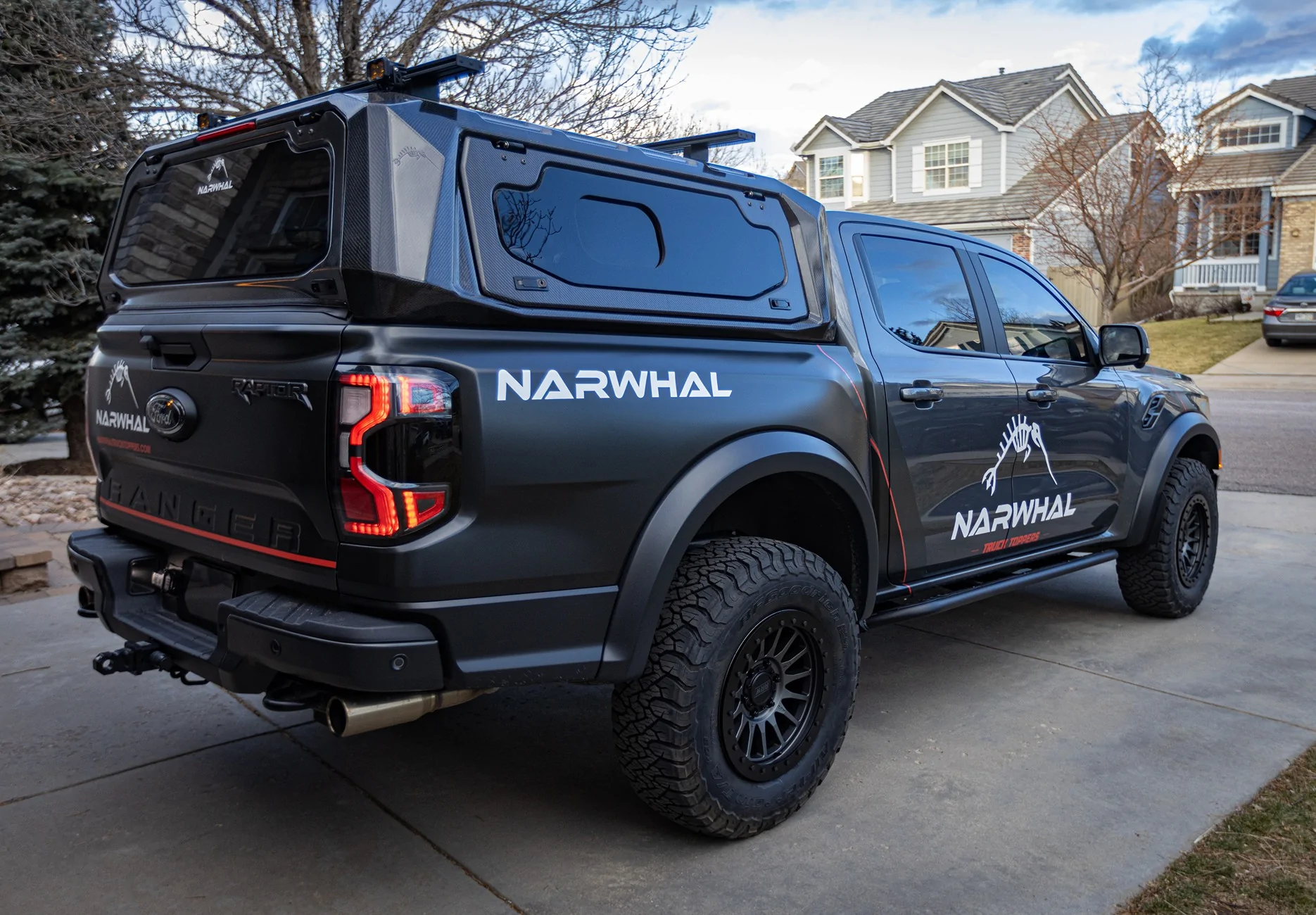

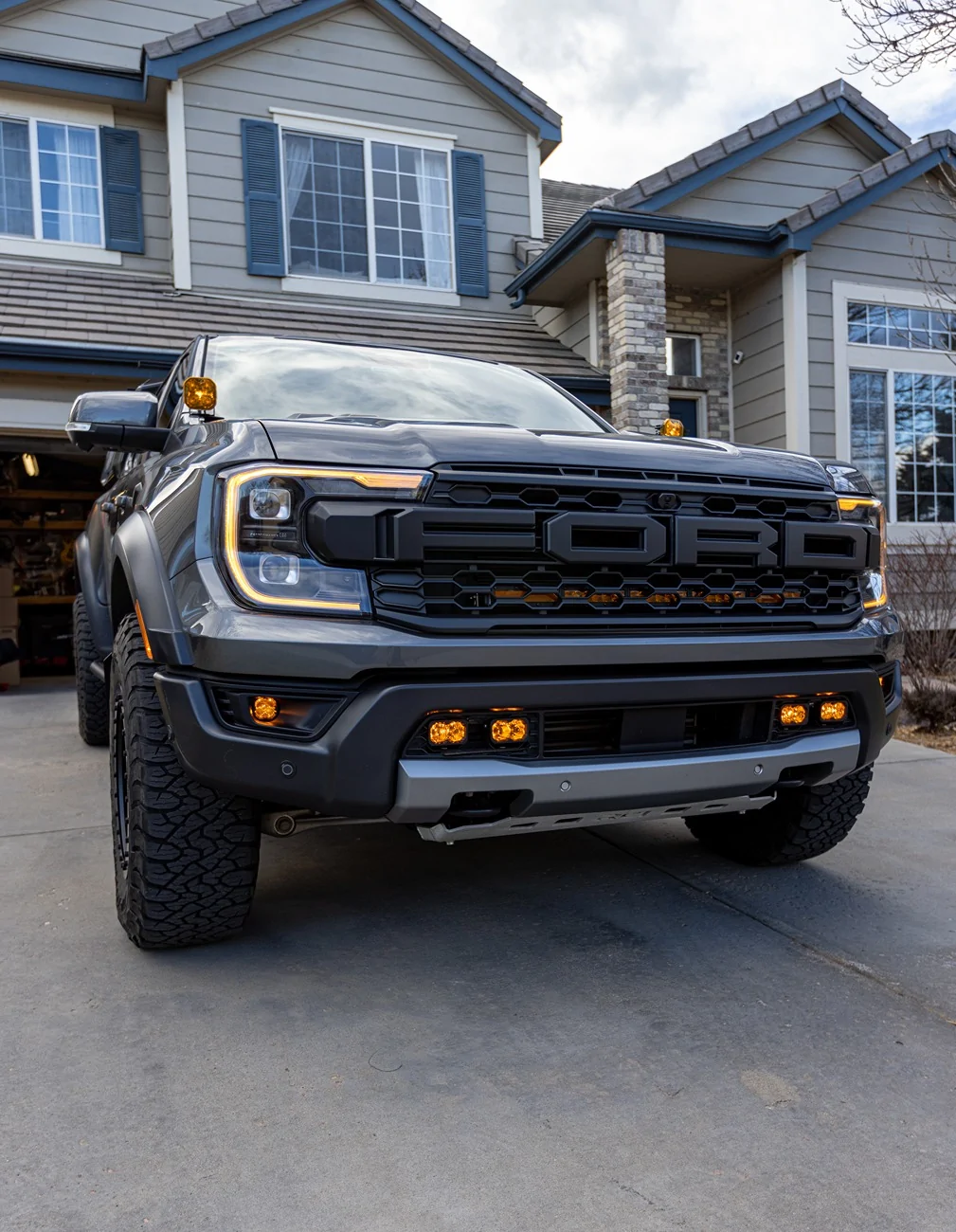

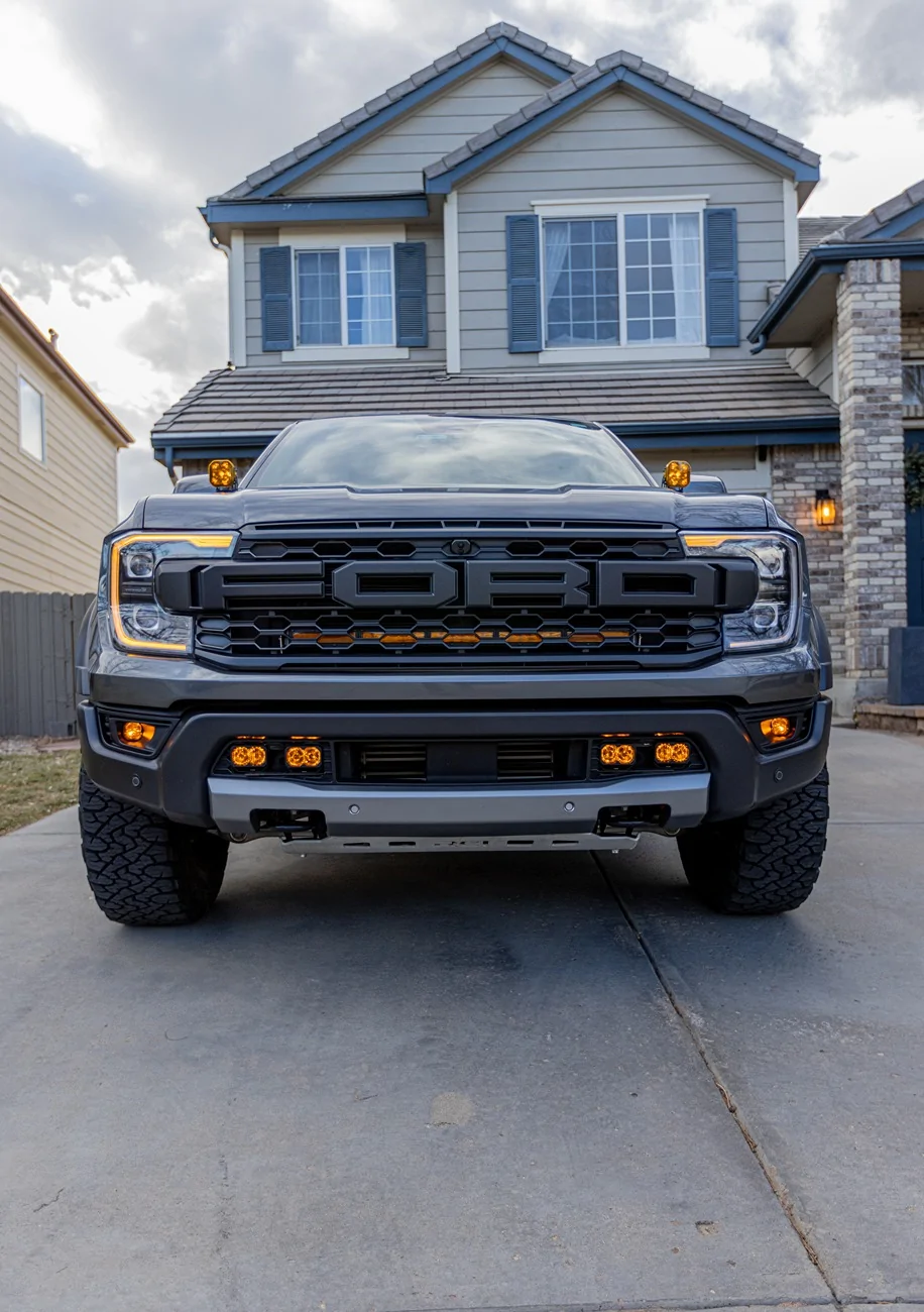

After at +25

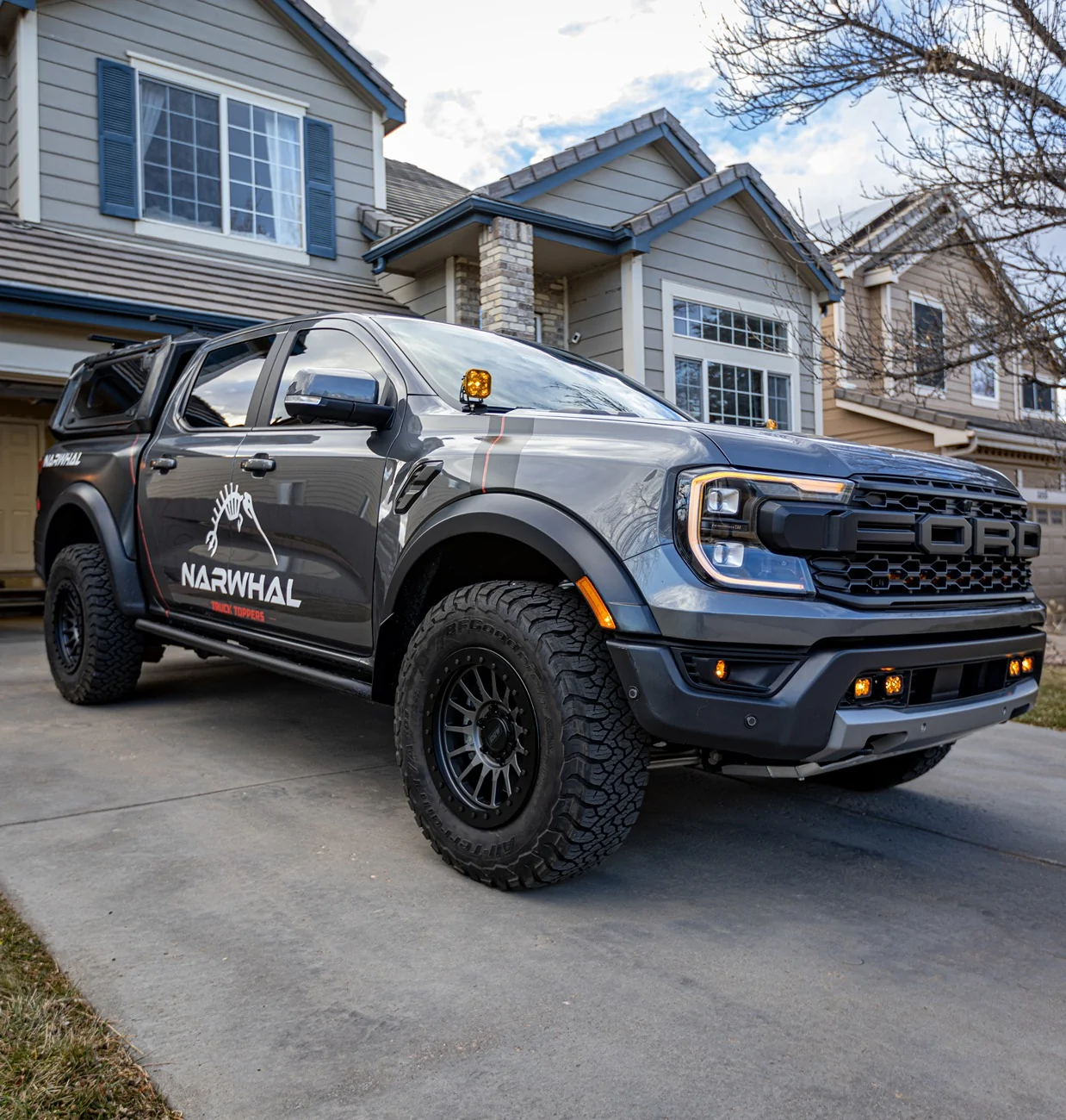

After at +25
