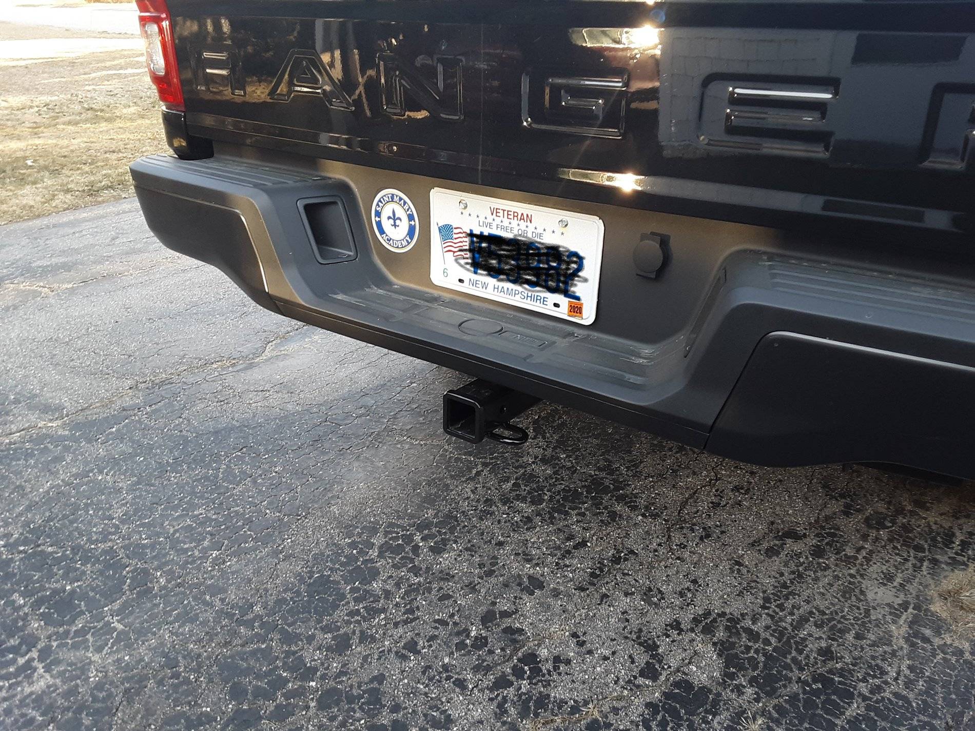

Curt 2" hitch receiver

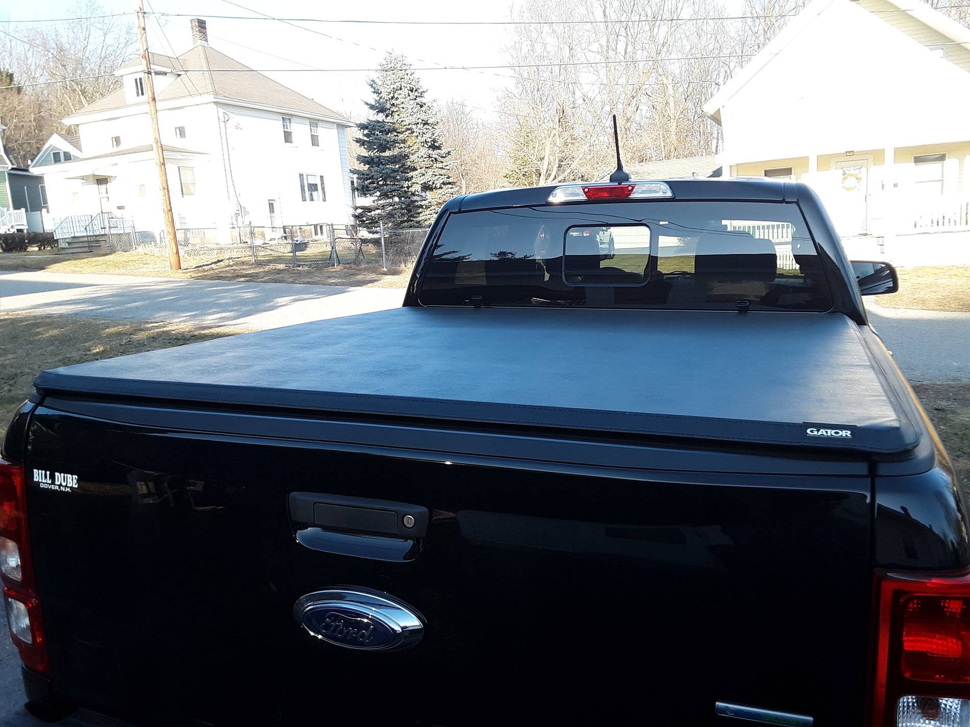

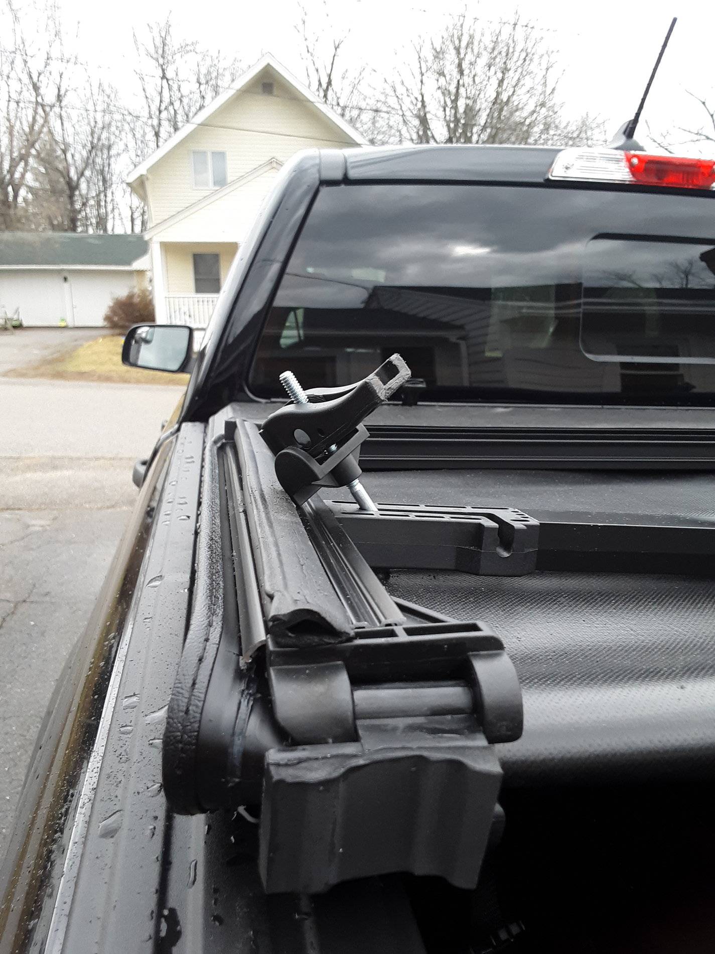

Gator tri-fold soft tonneau cover
Ford Ranger The Black Beast of AAAAGGGHHHHHH! 20200308_172816

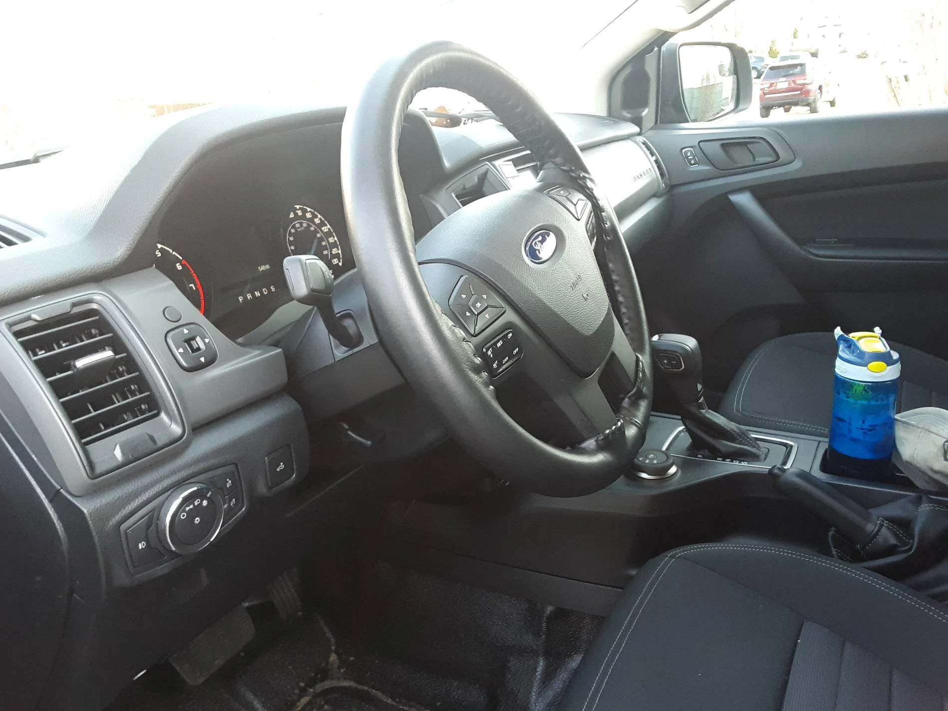

Wheelskins black leather wrapped steering wheel cover
Ford Ranger The Black Beast of AAAAGGGHHHHHH! 20200308_172833

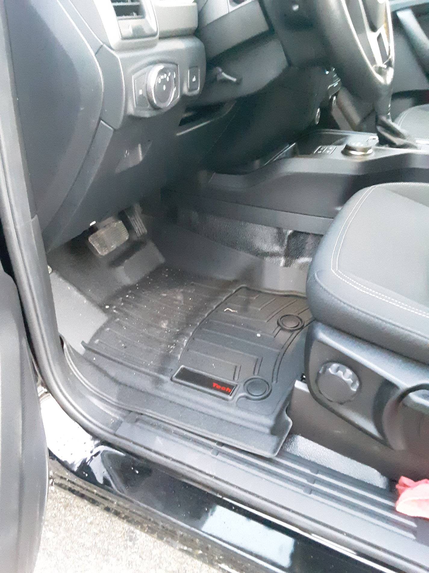

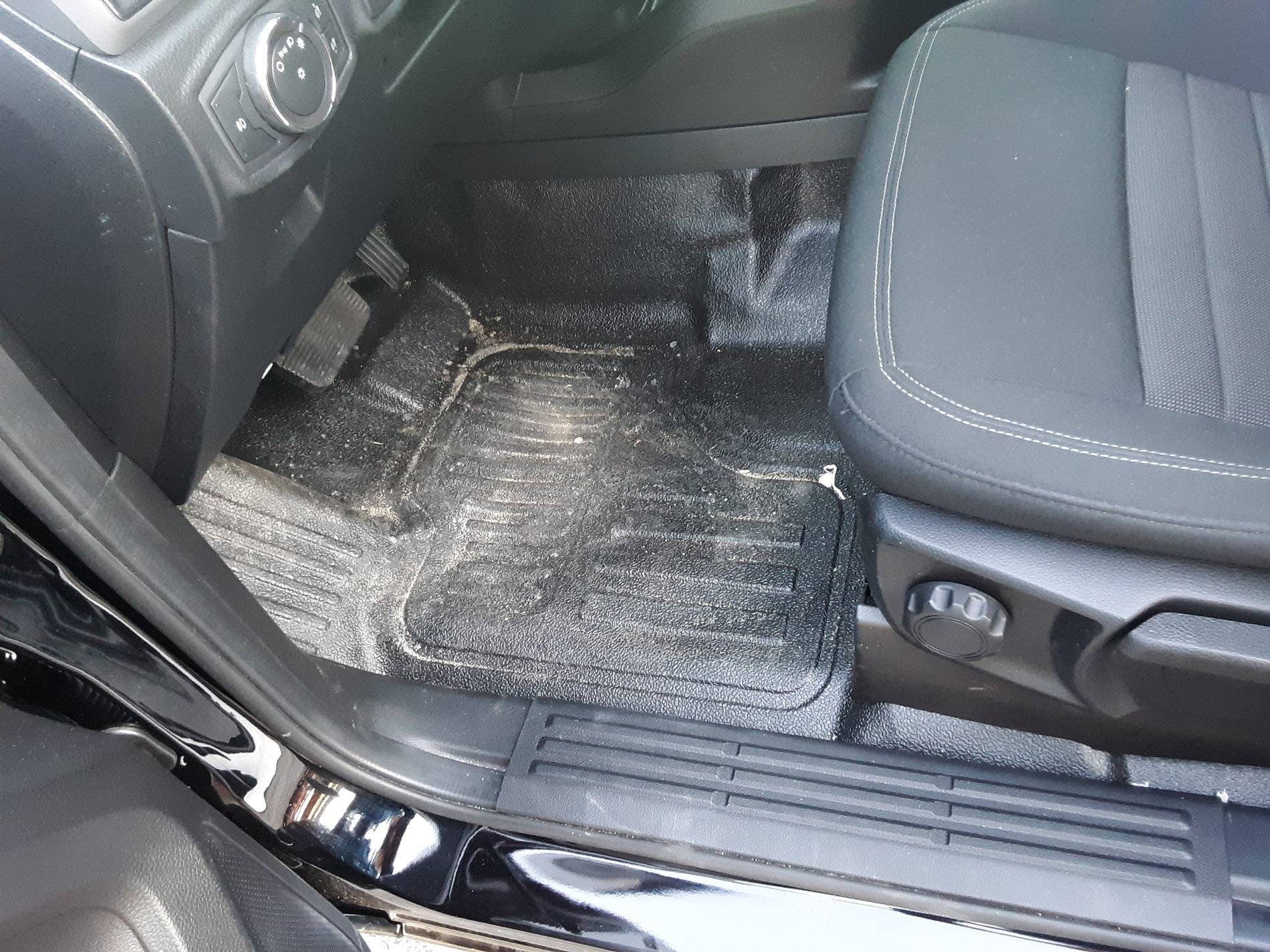

The latest add-on were the Weathertech trays. The Truck came with vinyl floors, which I prefer over carpet for ease of cleaning, though I noticed that the vinyl used for this looks a little wimpy; enter the floor trays, which arrived today! The front trays come with stick-on anchoring nipples which they conveniently pack along with alcohol cleaning patches and vinyl primer ampulle.
Here is the front without trays and with trays:
Ford Ranger The Black Beast of AAAAGGGHHHHHH! 20200308_172828
Ford Ranger The Black Beast of AAAAGGGHHHHHH! 20200313_184139

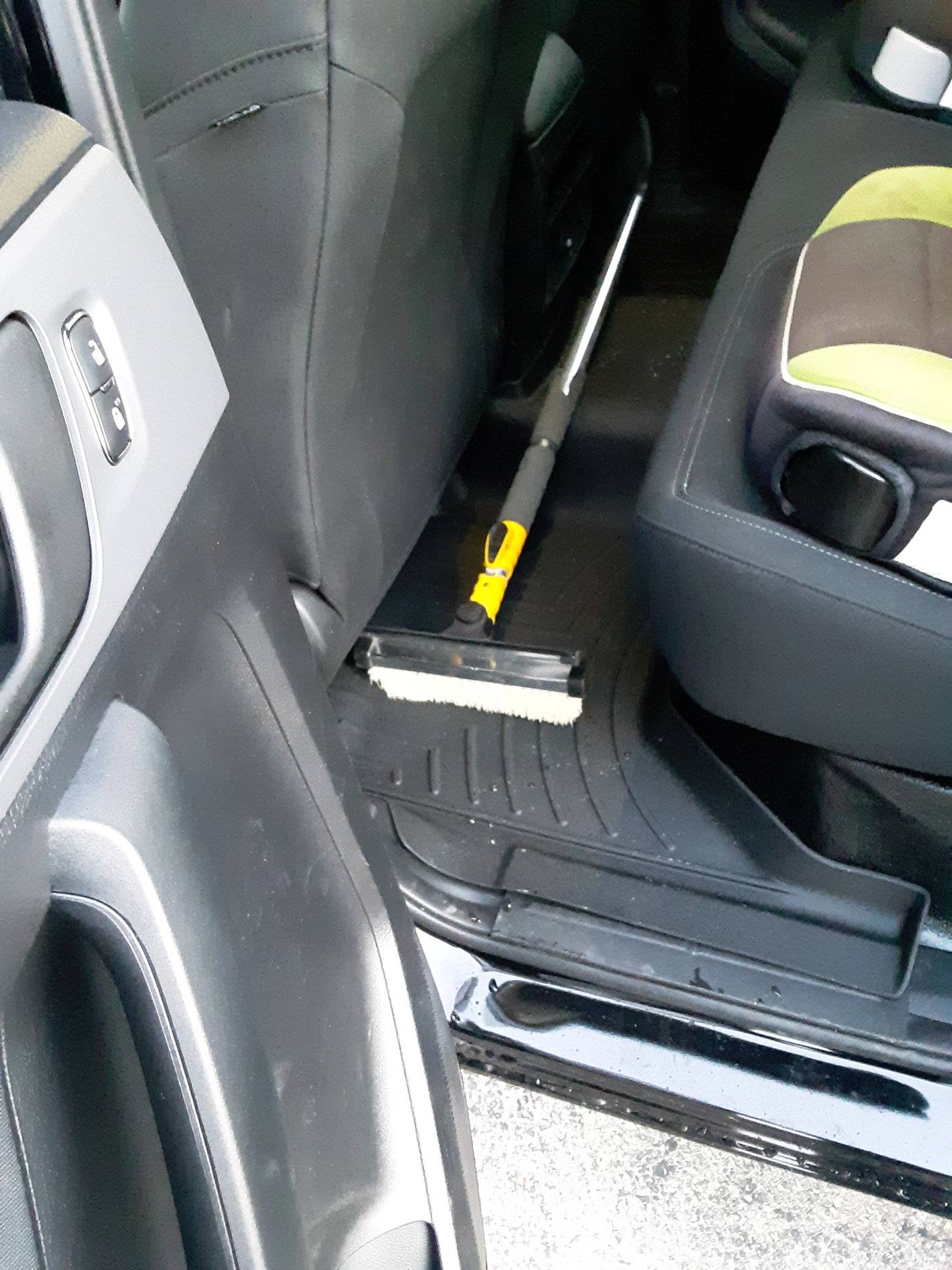

Though they appear to be off a little, the fit is tight and these things are rugged;I had them in my '14 Forester and withstood 7 years of abuse. The rears are also a tight fit and look 10 times better than the stock vinyl
Ford Ranger The Black Beast of AAAAGGGHHHHHH! 20200313_184159
By the way, I ordered them direct from Weathertech for $189.00 plus shipping for the lot of them, and both front trays came with anchor nipples (which was great because the stock vinyl floor has none). Easy to install and they look great. When ordering from Weathertech, you need to select whether your truck is Scab or crewcab and whether carpet or vinyl floors

Of course, the beauty of the 2" hitch receiver is that all my hitch accessories that I bought for my Forester fit nicely on the Ranger, like my Tyger 4-bycicle carrier and especially my Curt cargo carrier, for those occasions when a 5' bed is not big enough for say, a dump run :like:.
I have two more hitch "accessories" that I can't wait to try: my 14-ft skiff and my 17' O'Day Daysailer. THe wife has a couple of 12' kayaks that might me a problem transporting without a bed rack or one of those bed extender doohickeys. I see that Ford Accessories offers a couple of options by Yakima ($$$), but surfing the interwebs I also found some options from THULE, and s similar one sold by Home Depot for $100 less, plus some other, cheaper, more utilitarian models...Hard for me to justify prime $$ for a product that will be used sporadically, like the odd taking-my-20'-ladder-to-my-inlaws trip. One thing about the bed on the new Ranger that makes me miss my old Rangers, where a bed rack made from 2x2/2x4's ran me around $6.00, including hardware.

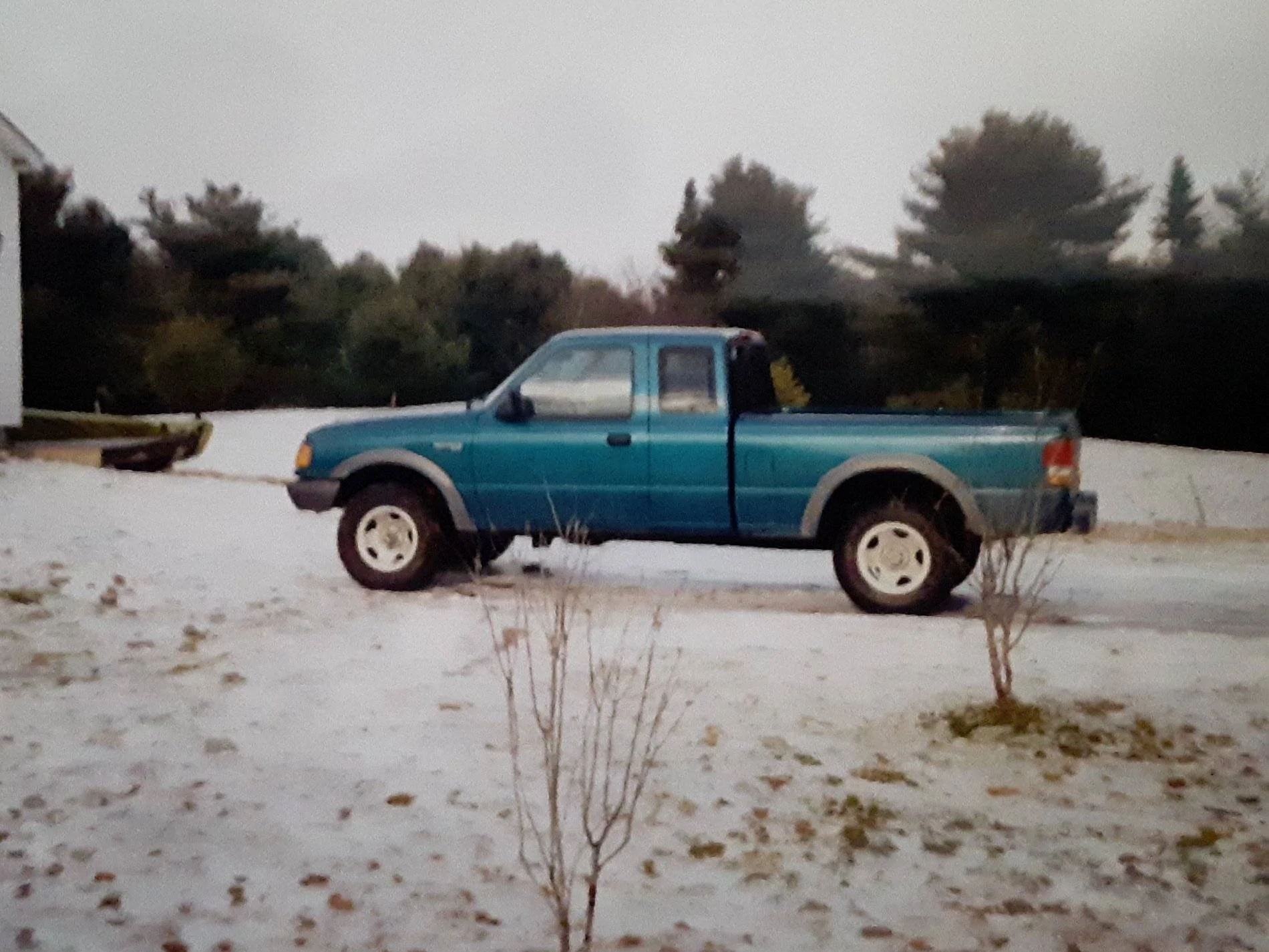

Figured a comparison of what you got back in 1994, 1998, and 2019 might be interesting...especially since I found my window stickers (a.k.a. maroneys-sp) from both my old Rangers:
Ford Ranger The Black Beast of AAAAGGGHHHHHH! 20200317_154350
Ford Ranger The Black Beast of AAAAGGGHHHHHH! 20200317_154603
Ford Ranger The Black Beast of AAAAGGGHHHHHH! 20200317_154534
Look at what we used to get for standard features on those things, especially what they called "off road package" back in 1998...for the record, that truck was an off road beast straight out of the dealer lot; the only thing I did to that truck besides a jump in tire size from 235-70-16 to 245-75-16 (never even bothered with a speedo calibration) was a K&N filter and when the stock shocks gave out I slapped Rancho 5000's and called it good. My green truck came "radio ready" (I forgot what I put there...Pionner deck and 4 speakers I think-cassette player days!), over time that also wore larger tires from the stock 215-75-15's it came with (235-75-15 general grabbers was the tire of choice back then), the speedo correction consisted in changing the speedo cable gear off the transmission from green to brown, I think).
Notice the EPA fuel mileage between trucks, back in the 90's when I drove my green ranger, my combined average MPG was 24 using super unleaded gas and 235-75-15 AT tires! In contrast to my 98 stock with 245-75-16's never gave me over 20 MPG combined...more like 18-19; same engine, same transmission, same rear end....
As far as bed protection, all I ever did to both trucks was a rubber bed mat (In fact, when I traded the green for the blue, I took the bed mat off the green ans slapped it o the new one), but on the black beast I think I will be trying my luck at DIY spray on bedliner...leaning for the Raptor kit. I thought roll-on first but since I own my own air compressor, why not? Waiting for slightly warmer weather for that mod...I'll keep you posted

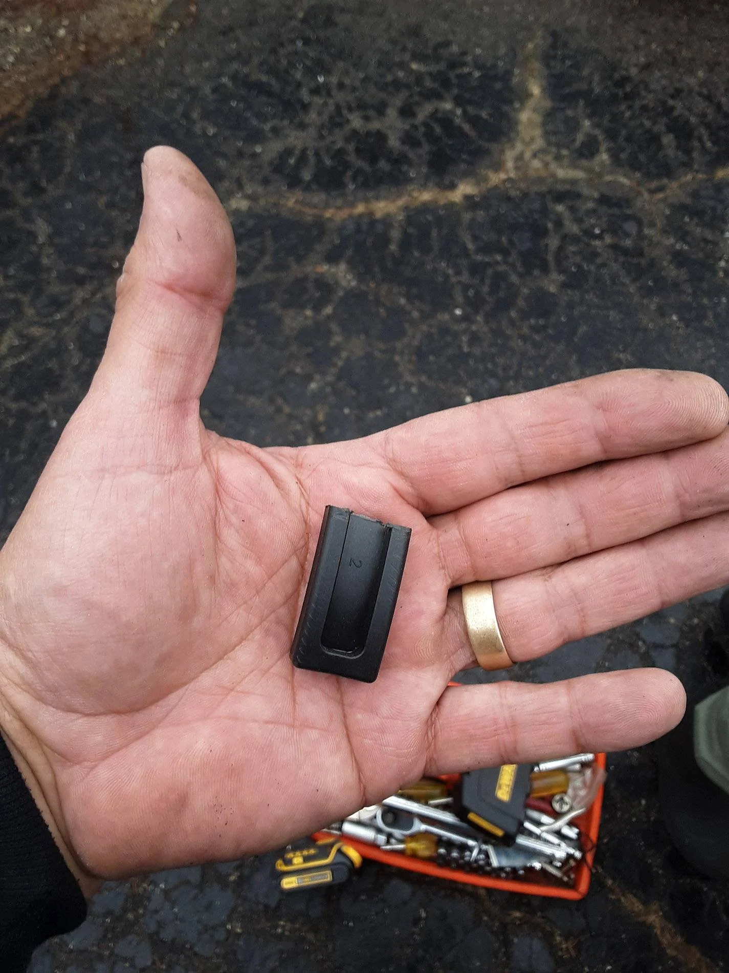

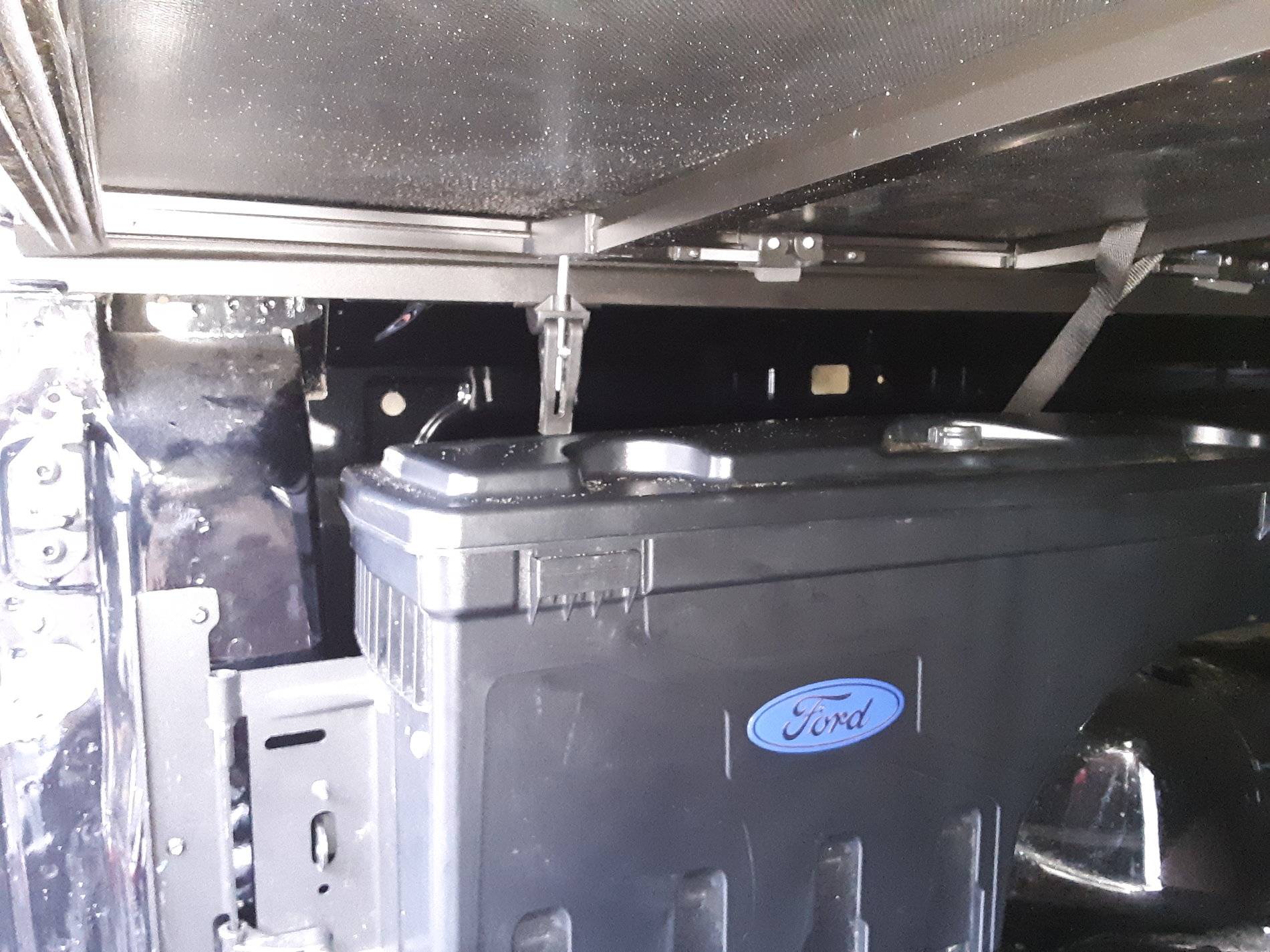

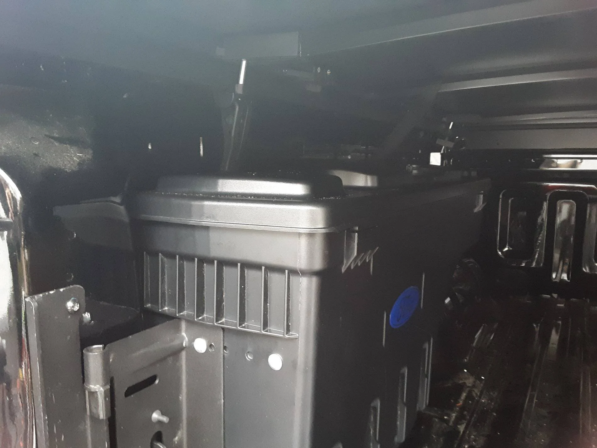

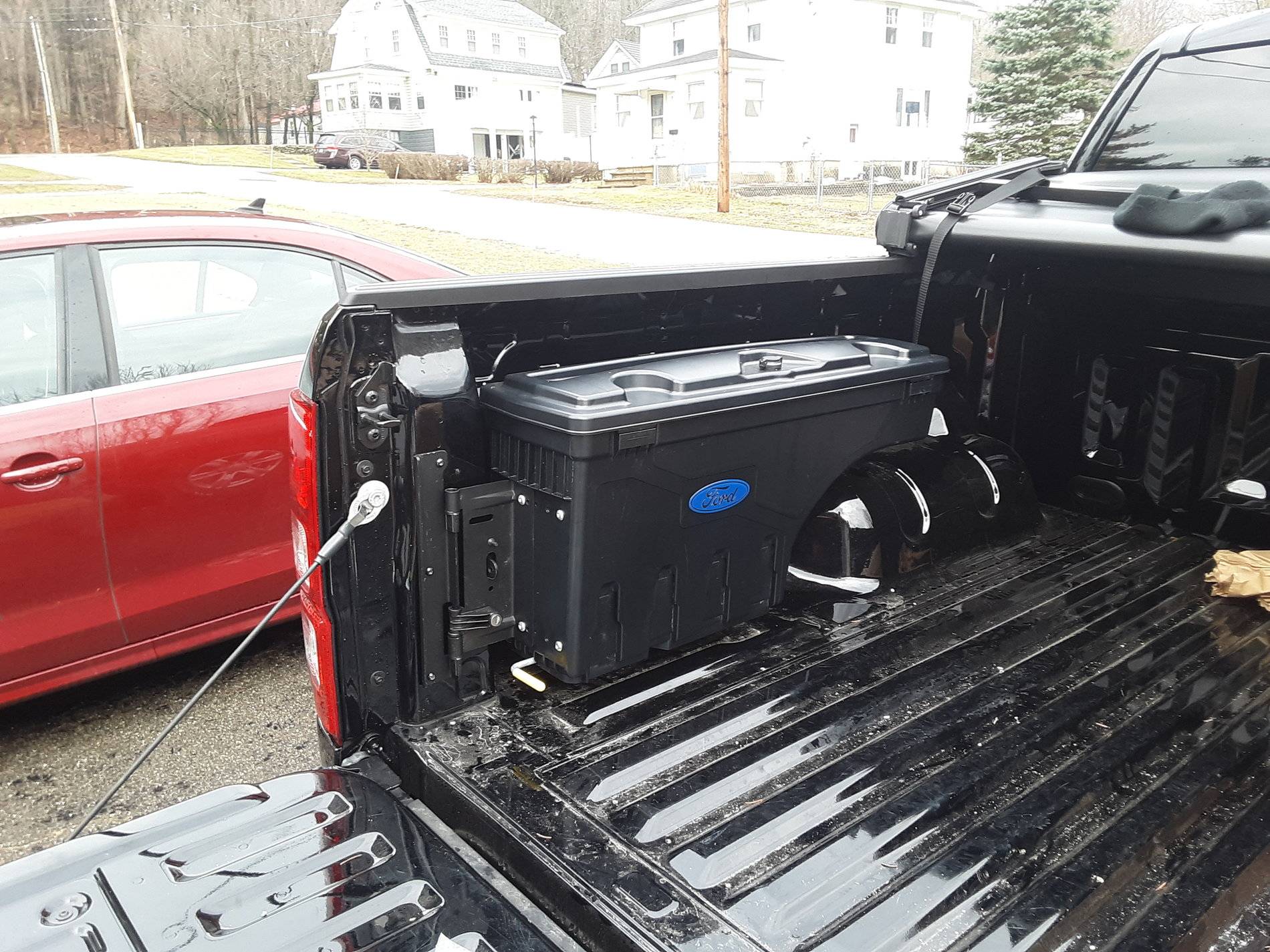

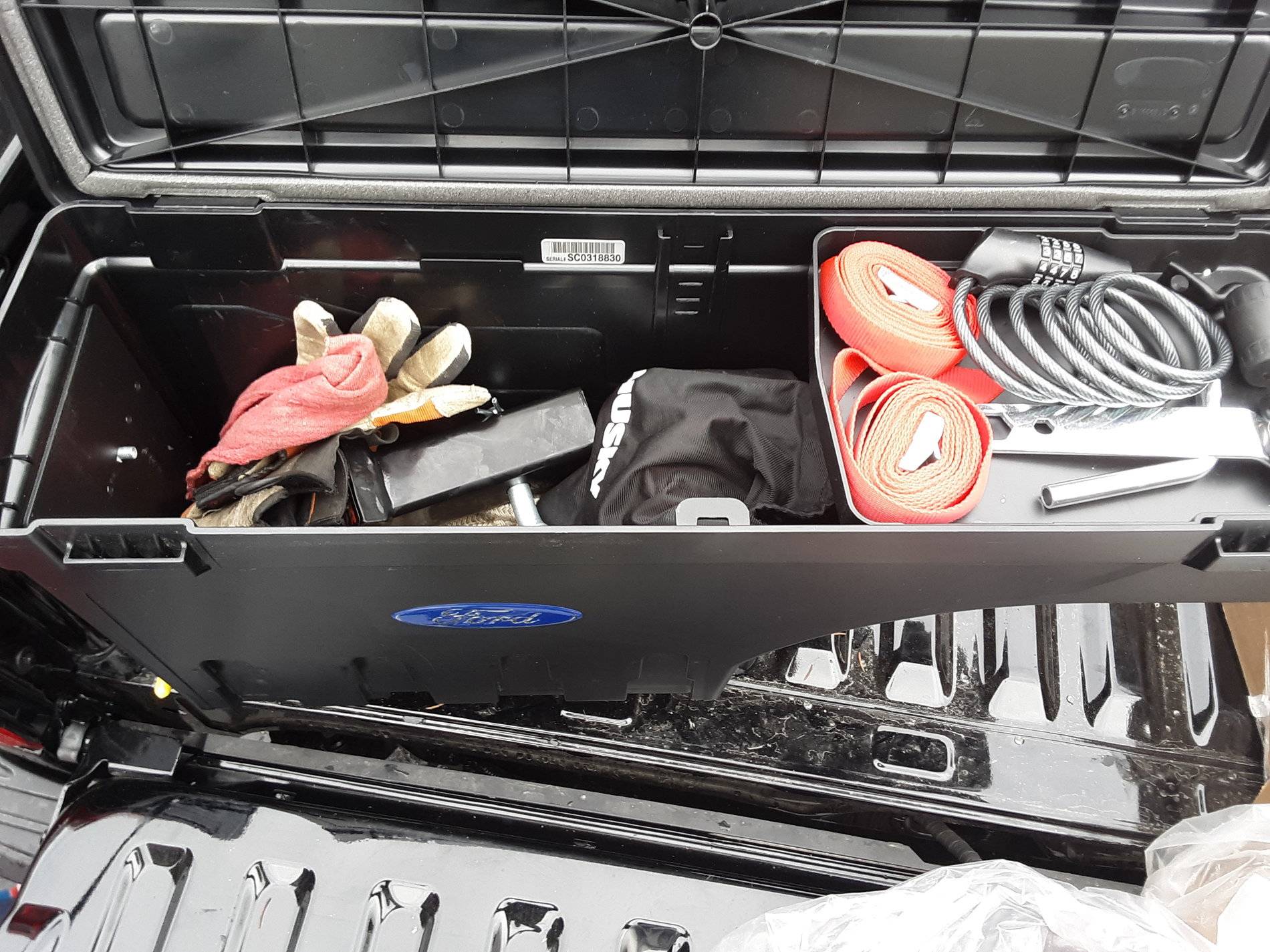

Picked mine up at the dealer today....on in 15 minutes, however; word to the tri-fold-tonneau wise: if you are like me and bought one of those (mine is a Gator), the lock handle on the side of the box gets in the way of the darn box. The solution? chop off about 1-1/2" off the end of the handle and PRESTO! it fits (redneck engineering 101)
Ford Ranger The Black Beast of AAAAGGGHHHHHH! 20200320_154157
Ford Ranger The Black Beast of AAAAGGGHHHHHH! 20200320_155151
Ford Ranger The Black Beast of AAAAGGGHHHHHH! 20200320_155506
Ford Ranger The Black Beast of AAAAGGGHHHHHH! 20200320_155618
Ford Ranger The Black Beast of AAAAGGGHHHHHH! 20200320_154212
Ford Ranger The Black Beast of AAAAGGGHHHHHH! 20200320_155610
They sent me driver side despite having ordered passenger, but I really don't care. I harvested bolts from the forward tie-down because I didn't feel like driving to the hardware store to get some. Apparently XL's only come with four tie-downs; has anyone sourced those things aftermarket?
All in all, a nice add-on to the beast, very convenient place for hitches, tow lines, straps, etc.
