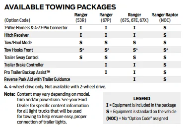

Hey guys, I'm sure there are other threads but I want to differentiate this post based on what's going on with my situation. Essentially last year I purchased a 2024 Ranger Xlt 2 wheel drive for work as it can tow a decent amount etc. The problem is that there is not a stock option available for purchase from ford according to my dealership, and accesories.ford.com website customer service. It seems we've been left out. The update I got from my dealership after paying them for the towing option (third party or stock option prefered) is that third party option such as red arc they installed on one vehicle and they aren't installing anyone elses until they can trouble shoot issues with it. because the computer isn't accepting it? Essentially it keeps throwing codes and are trying to figure out what to do.
They state that they have been working with ford and redarc who apparently makes the trailer break controllers for ford... But they still after a year can't seemt to make it work without having weird electrical issues with the truck. They were even saying that 4 pin installations are also giving issues such as weird issues like lights not working correctly and other things i can't remember...
Has anyone else had issues with an install? has anyone successfully had the red arc installed if so where did you put the knob. I want the most discrete option so redarc knob seems relatively small, and i was thinking on having the knob installed by the traction control area. but I think it might be too big. I hope ya'll were able to figure something out cause this is honestly ridiculous
