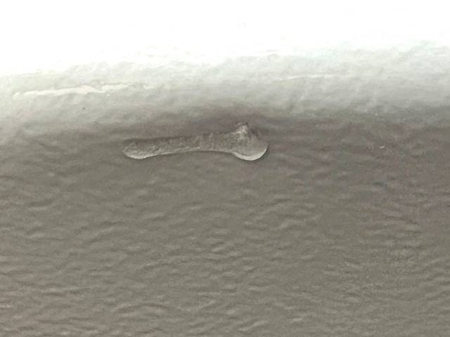

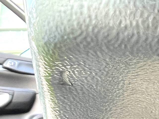

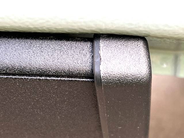

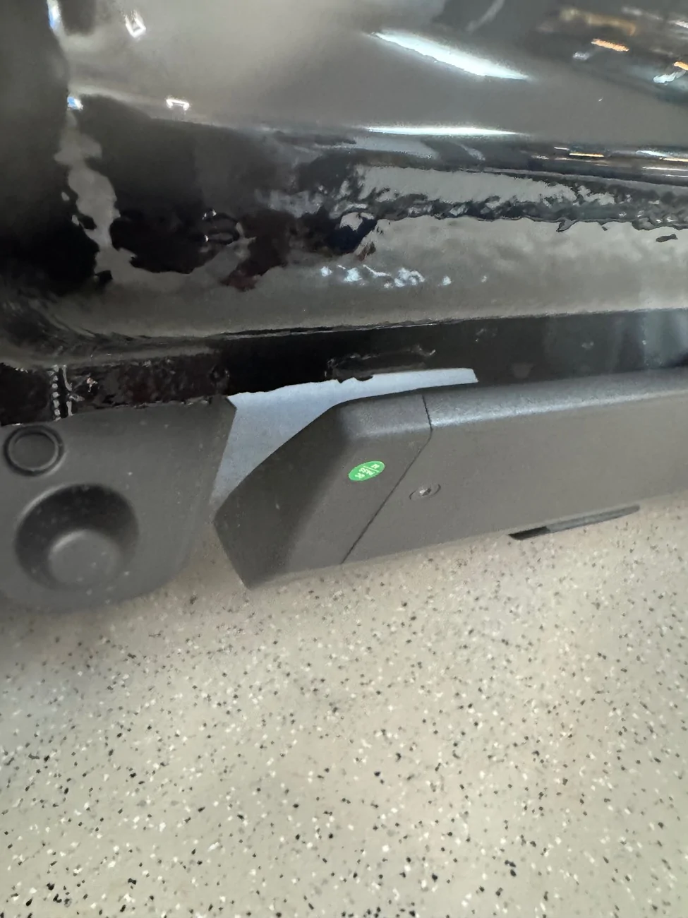

The "Power Step" running boards raise with such force that they slam into the bottom of the rocker panel on the motor side of each board. You can see the marks and dents as a result of this impact in the photos.
RealTruck's response was: "Try jumping up and down on that side to bend them down".
They should have an adjustable stop on that side of the boards.

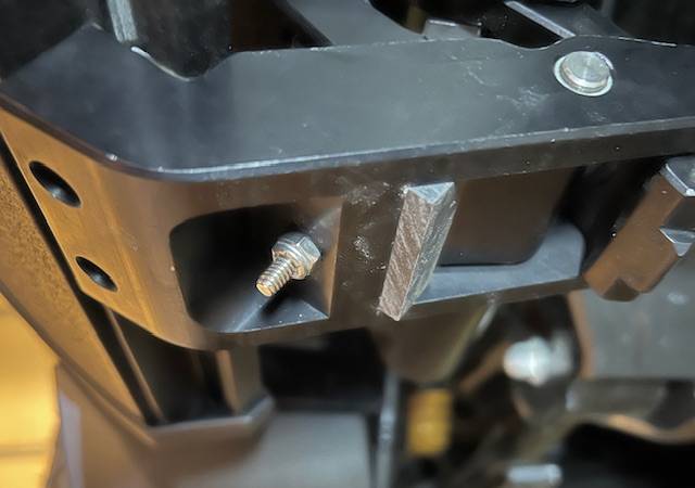

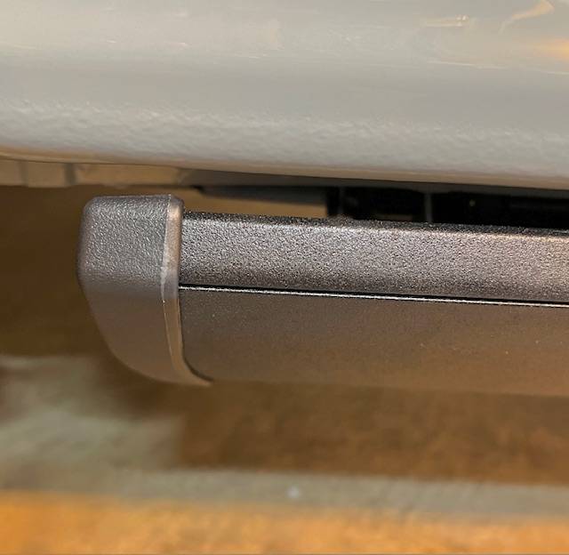

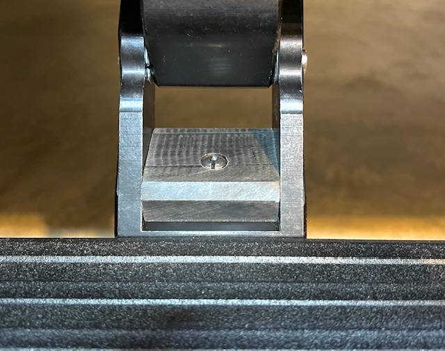

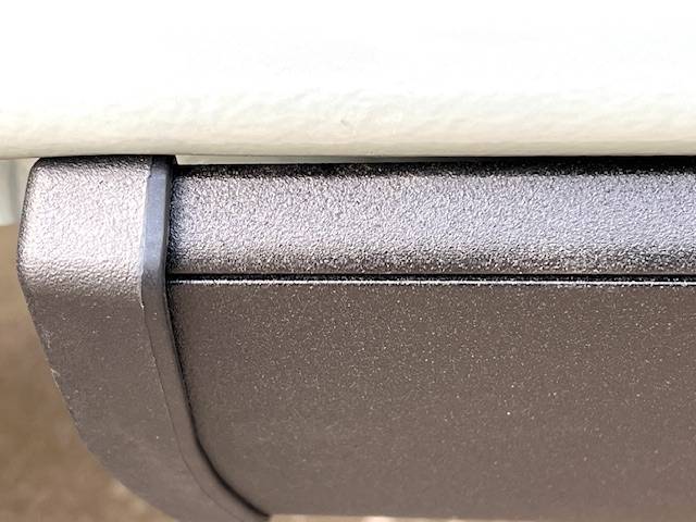

Fixed!
I cut a POM plastic Block 1-7/8 x 1-1/2 x 9/16 from a wear strip acquired years ago and Drilled a 3/16 hole in the step mount. Attached with #10 x 1-1/2 machine screw.
Fits like a glove and stops the step at the perfect height. 1 block on each side next to the motor.

Hello, I realize that I am late to this discussion, but I am curious about limiting the motor bracket travel with this spacer. It seems that the motor would have a “Home Position” programmed into the system and I am curious as to whether your steps still extend and retract the same as before the modification?
Papa
May 4, 2024
Ohio
2024 Ford Ranger Lariat
The running boards have sensors to detect weight and pressure (for safety purposes), they turn off when they stop moving. They are not designed to reach a specific location!

They caused dammage to your truck though. If you attempt to sell it, a careful buyer, or a dealer will notice. Some compensation ought to be discussed.
Papa
May 4, 2024
Ohio
You’re right, I should give them a call.
