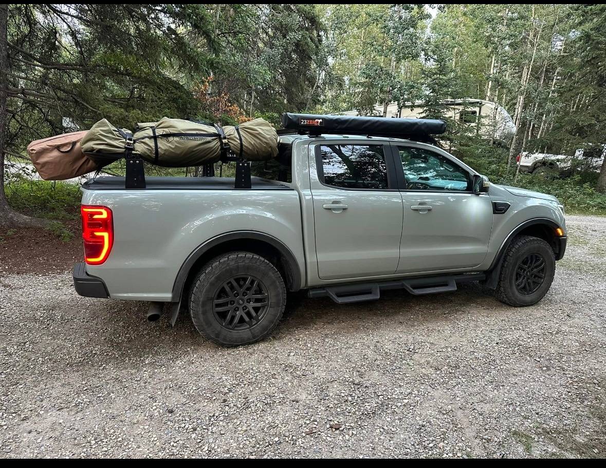

Hello all,
Im about to pull the trigger on the RTT setup for my 2020 Lariat. However, I cannot find any firm feedback on whether the 88lb above rail limitation applies to the 2020? Or just the newest Ford Rangers. The J-Brace websites I've looked at only address 24-25 Rangers.
I'll call the dealership if necessary, but they've been pretty flake in the past, so I figured I'd ask the pros here.
Apologies if this has been covered, I've searched for several days and feel like I am getting conflicting information - youtube reviews are even more confusing,
No braces needed for the 5G Ranger. Make sure your rack our mount is rated for the load of the RTT plus people & gear.
While I never carried a tent, I carried many other things on my 2021.
