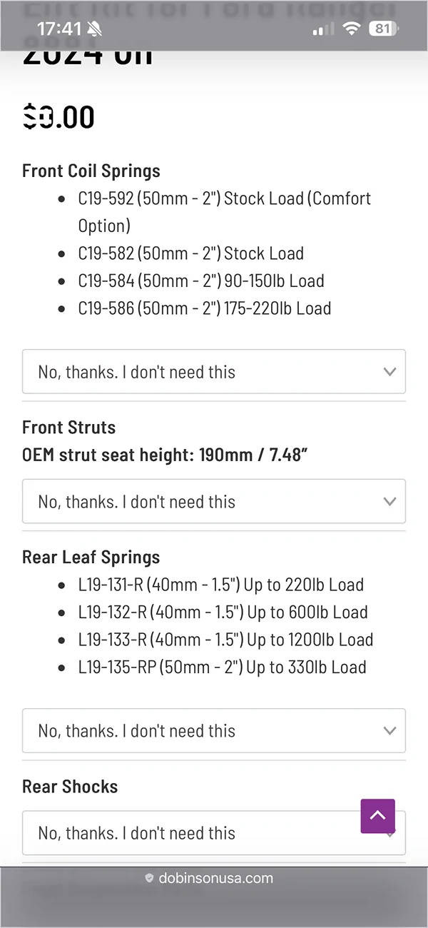

Hey guys wondering if anyone can tell me what a 2025 FX4 leafs and front coils are rated at?
I’m considering dobinsons and they offer several coil a leaf options (attached)
I’d like to know what OEM is rated at so I can make the right choice between too stiff and able to handle my huge load. Last week I loaded the ranger with a single face ( 4’x8’x16” ) of fire wood and was sitting on my over travels.
Not 100% I want to swap yet as I had good luck hauling 1700lbs across the US this summer but exploring options thanks.

I’m not having much luck finding the weight from the spring codes I’ve seen online. At least for the front springs. Got bored & frustrated with the search and didn’t look for the rear
My 25 xlt fx4 has a front dpring code of HHAA and a rear spring code of ULC.
