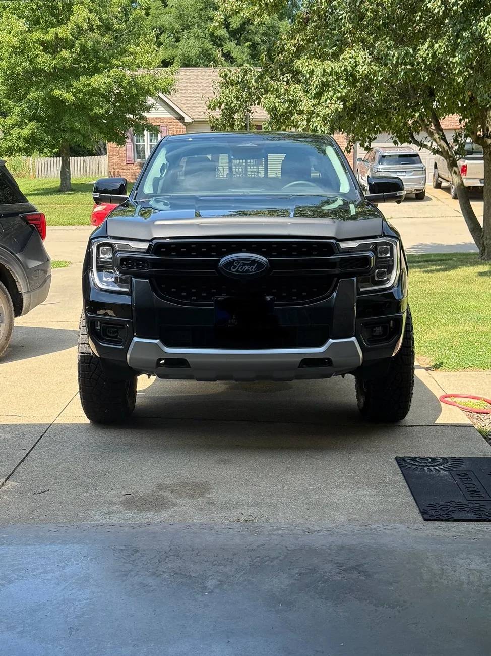

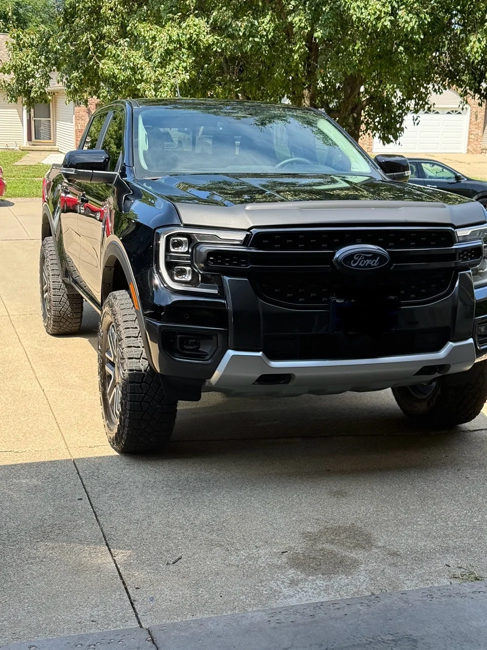

The dealership aligned mine this past saturday with a 2.5 and said it came in perfectly with no control arm swap

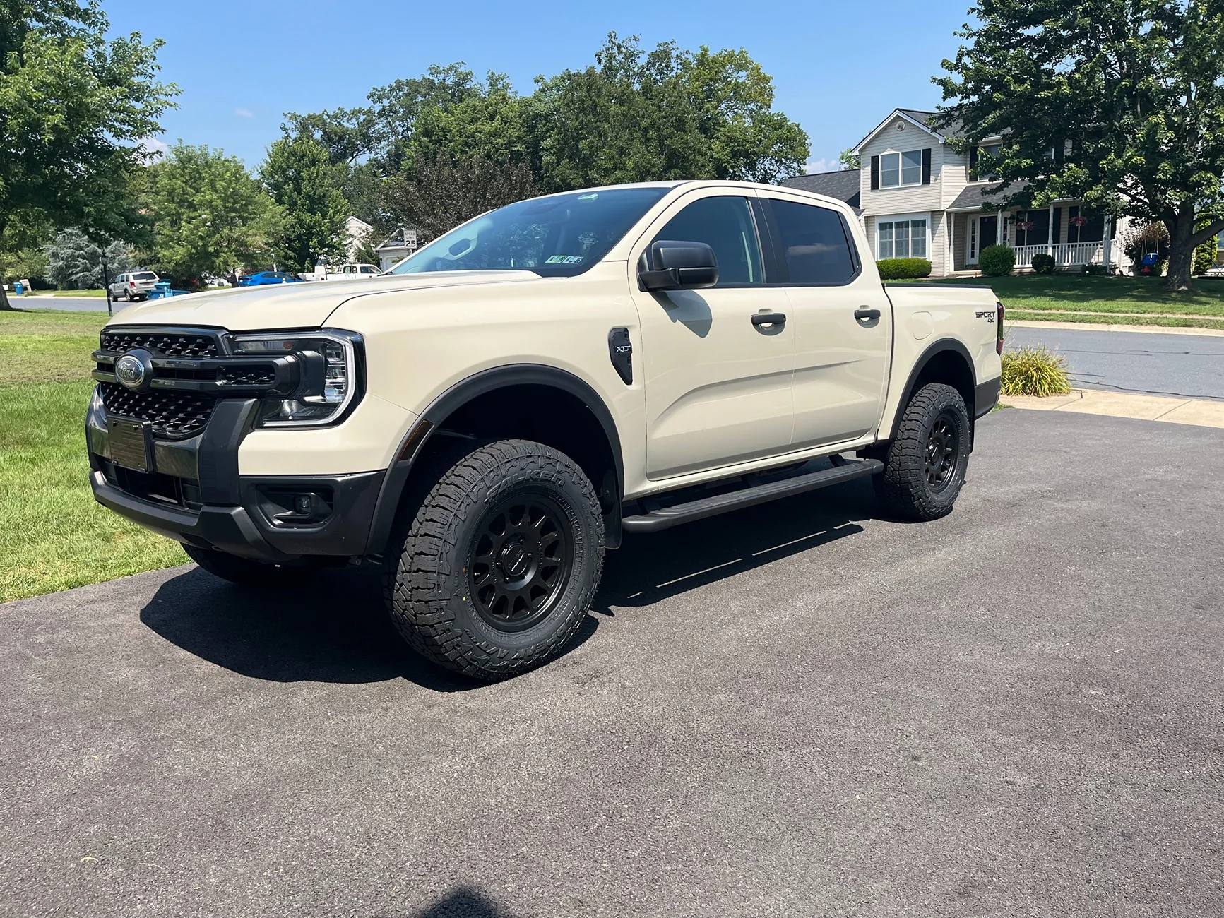

What level kit did you end up going with? Also, are those Method 305s?
RealTruck SUPERLIFT SUSPENSION 2.5"
Method MR703 17x8.5 +35 Matte Black
Falken WildPeak A/T4W LT275/70R17

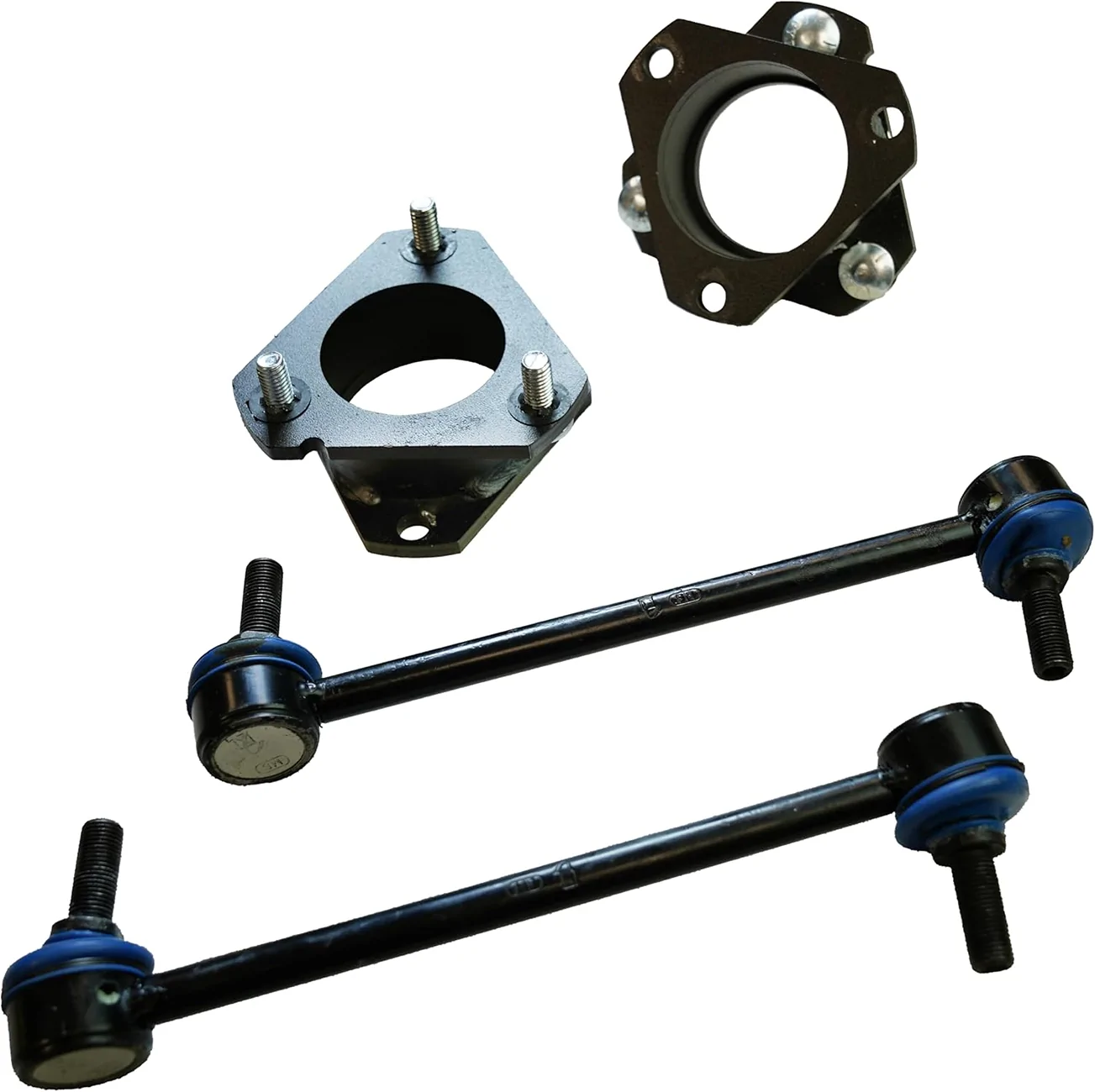

Those are on my list. AFAIK they are the only ones that come with the stab links.

Hello, great looking truck. If I can ask, I'm going to have similar setup, same level kit, and I'm going with fuel recoils with +1mm offset, I was debating between the 275/70/17 and 285/70/17 wheels, do you think you could have gone with a bigger tire? And I see you have the sport model (same as mine) Did you have to trim the air dam at all on the bottom? I tried to take off and it's a pain and leaves a gap. Was just going to trim it down if it's needed.

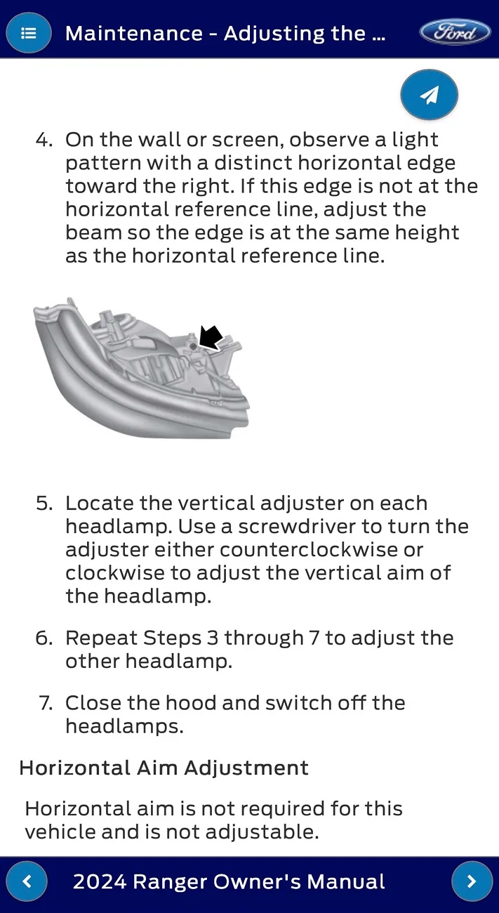

After buying my 2025 lariat ranger I was inquiring about a lift at the dealer. They sold me the 3.5” rc lift but once doing some research on my own I saw that it wasn’t compatible with the adjusting headlights on the lariat. When I asked them about it they said it shouldn’t be a problem and they will be able to make it work. My truck goes in to get the lift installed in a few days, but I’m having some serious doubts about the outcome. Anyone think they will actually be successful?
skytrucker
Andy
Dec 14, 2025
98
152
Illinois
2024 Ranger Lariat
AFAIK- the headlights auto adjust to level when a load in the bed/trailer pitches the rear down. But I think there is a manual adjustment that can be made to bring them to level with a lift, and they would still auto adjust to find level if the rear is pressed down by load…
I.e. the auto adjust is only a few degrees, and the manual adjustment as standard (“dumb”) headlights can be made in a wider range.
