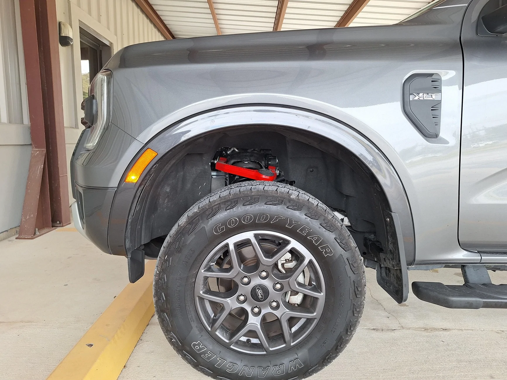

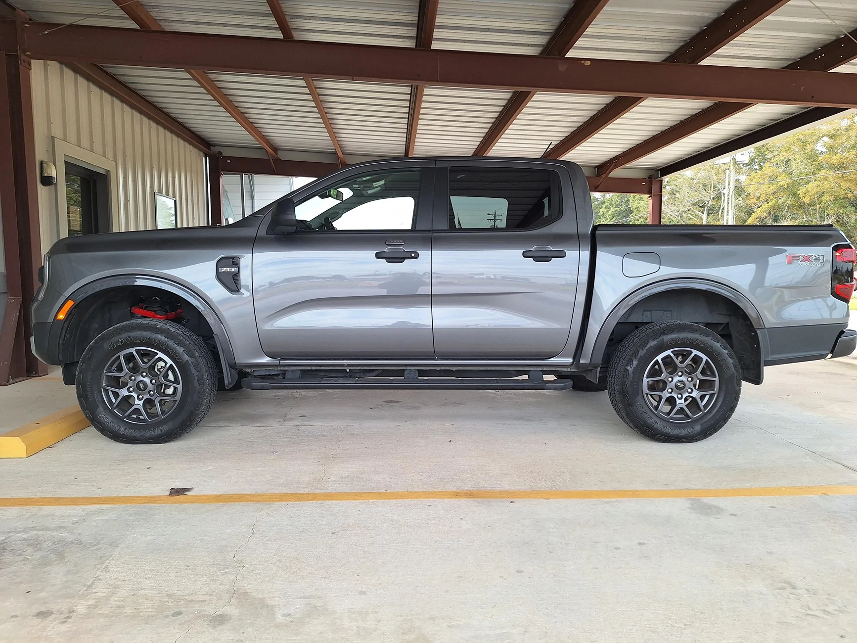

Yup, that looks high in the front, so hopefully a 1" rear block will help. Going up a tire size or two to 265/70/18's will look better too.
Future plans, bigger tires.

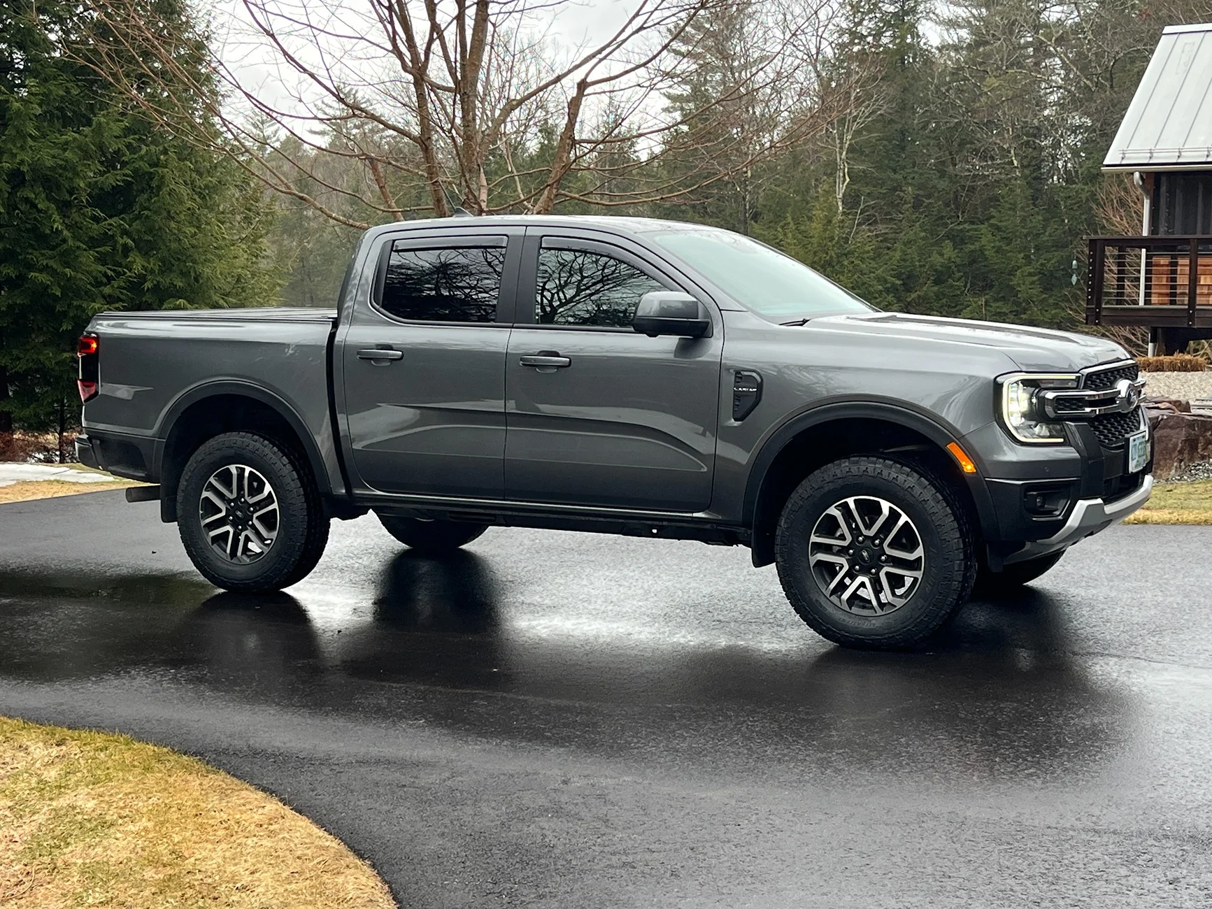

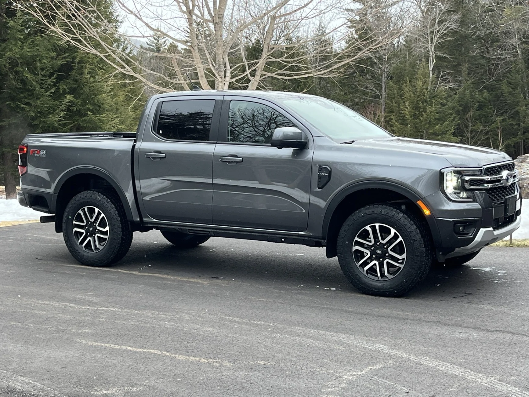

Here's the before & after shots of the 1" Rangerlifts level I put in yesterday. By the way, the Ready-Lift 1.5" level actually has about a 1.5" spacer, so that's why it adds more like 2.5" to the front. Supposedly for every 1" spacer, you get 2" of lift. It's not an exact science, however.
The 1" spacer measured about 1/2" and actually added about 1". My front end is still raked forward about 1 1/4", which I like so it still has a little rake.
Ford Ranger 265/70/18 anyone running this size on 2025 Ranger? Ranger Befor
Ford Ranger 265/70/18 anyone running this size on 2025 Ranger? Ranger After
