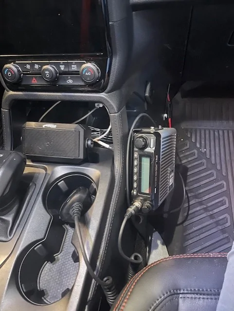

I installed a Rugged Radio 55 watter using a Rugged Radio bracket specifically engineered for Ranger. It mounts to existing passenger seat bolt. There is no cutting or modification of any plastic. It holds up great in rough terrain. Antenna mount is third brake light mount from BulletProofDiesel, again no holes drilled in body of truck for coax. Power for radio is from AUX 2. Since it is in open, no heat issues. Does not interfere with passenger.

Is that the Rugged Radios mount? What are your thoughts on it? Seems like it doesn't intrude too much on passenger leg room. I'm probably going that route for mine.

I am really happy with it. Very easy to install, it does not require any drilling or cutting of plastic. It comes with bolt and spacer. You remove front passenger left seat attachment bolt, and bolt on bracket...one mounting bolt holds it in. Have not had any problem in rough terrain, very secure.

Sorry, yes the mount was purchased from Rugged Radio $95 retail. Call them directly they will give you 10% off first order...

Ok.... So it appears that the Rugged Radio mount is far superior to the one I suggested and I intend to get one. I wasn't sure that it would fit my radio but I ran across this on their website.
"Radio Compatibility:
GMR25, GMR45, M1, G1, G4, RDM-DB, RM60, Icom F5021, Kenwood 7360, ABM25, or use your factory U-bracket and bolt it to the universal slots on the mount."
I also think that their antenna mount may just be the ticket if you don't need a ground plane and the extra range it offers. More research is needed for that part.
