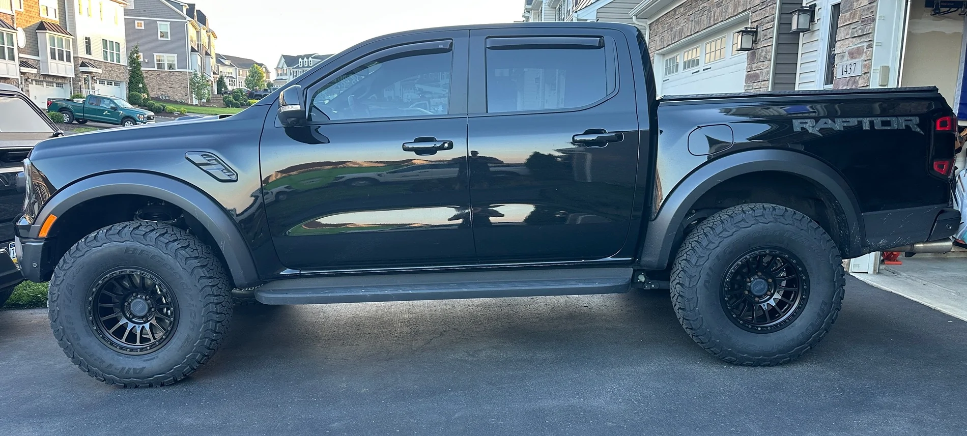

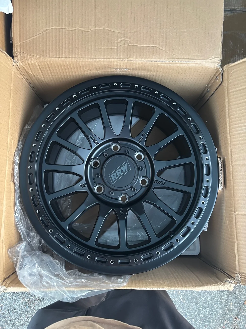

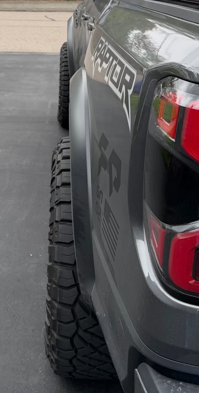

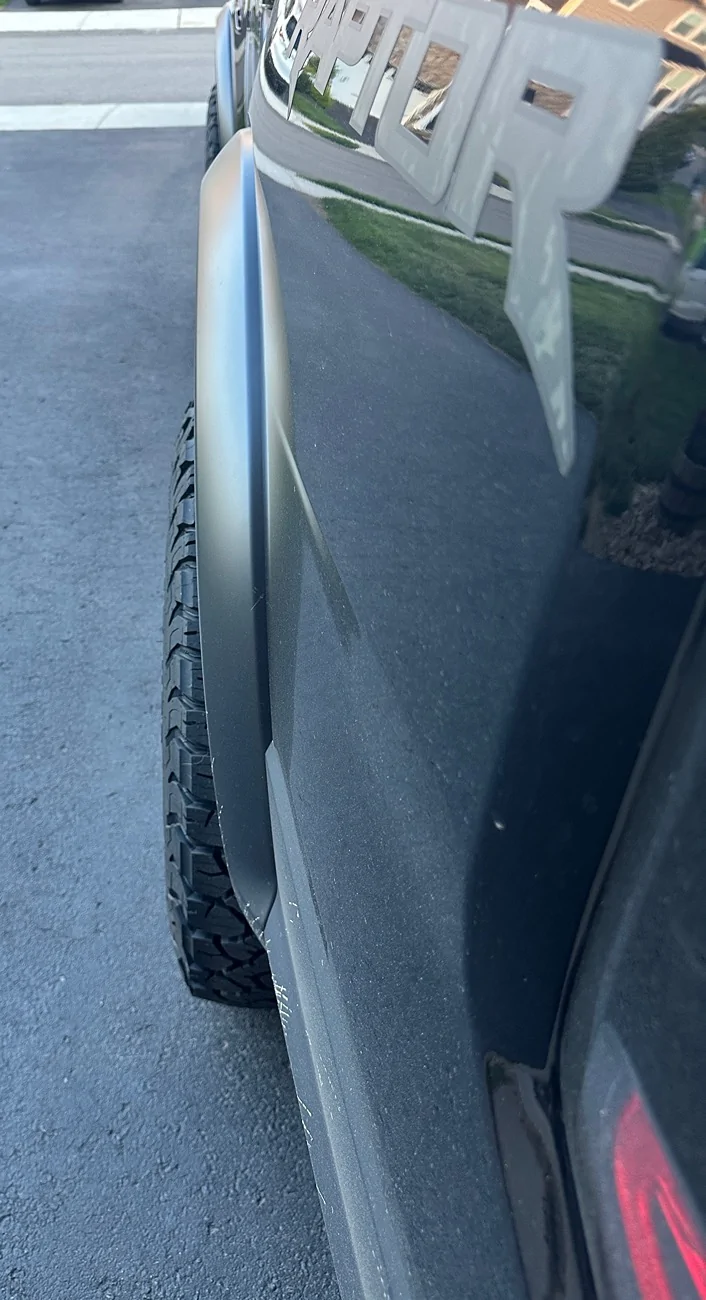

Specs of the truck are as follows:
-2.5” Foutz Leveling Kit
-17x8.5 RRW wheels with a 0 offset.
-35x11.50r17 BFG KO3

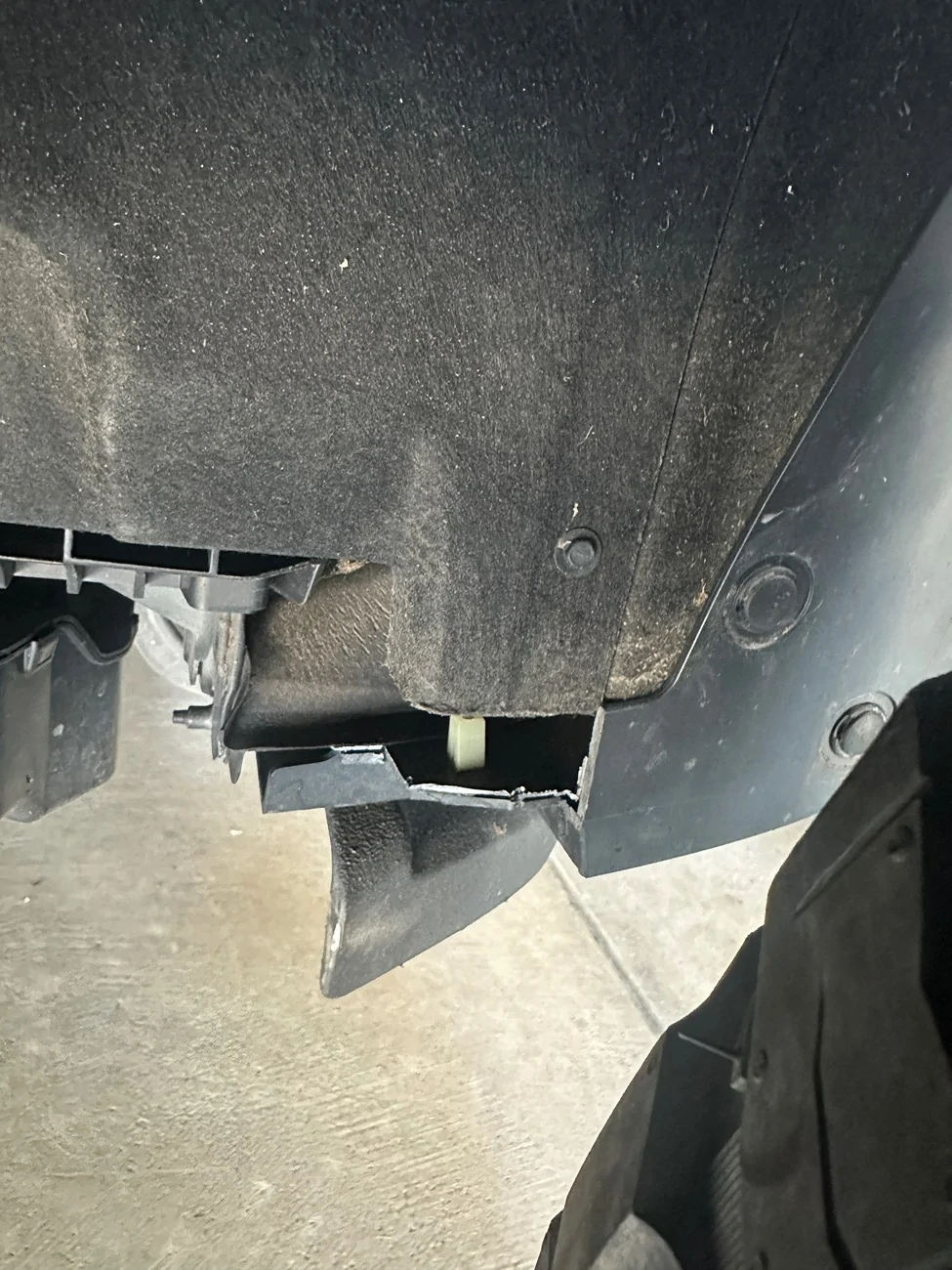

Crash bars were removed as well as some very minor trimming. No rubbing at full lock either direction.
Ford Ranger 35's KO3, 0 offset wheels, 2.5" level kit IMG_5048
Ford Ranger 35's KO3, 0 offset wheels, 2.5" level kit IMG_5049

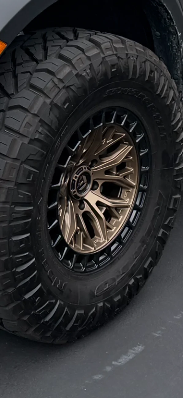

Nice choice in wheels. Did you fill those threads with some bolts?
Ford Ranger 35's KO3, 0 offset wheels, 2.5" level kit IMG_0510
Yes

How do the tires ride compared to the stock 285s?
Honestly it feels better. But my factory tires were cupped pretty bad. I almost forgot what a smooth ride felt like.

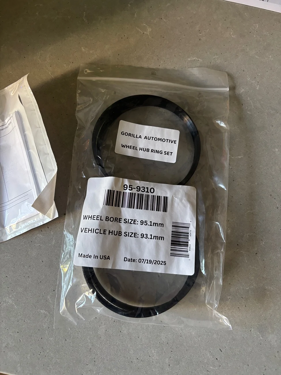

OP if you have any vibrations, which you probably dont…These might help.
95.1mm to 93.1mm hubcentric rings. WAY overpriced after shipping for a 2mm ring lol.
Ford Ranger 35's KO3, 0 offset wheels, 2.5" level kit IMG_0751
Got a set already. Never ran the wheels without them.

Not to hijack the thread, but donkey can you explain why / when these are needed? Ive been wondering about some vibrating since changing out stock wheels for +25 offset (not 0 like OP).

if the wheel isn’t advertised as lug centric then they are needed. Some are hub and some are lug using ET style lug nuts.
