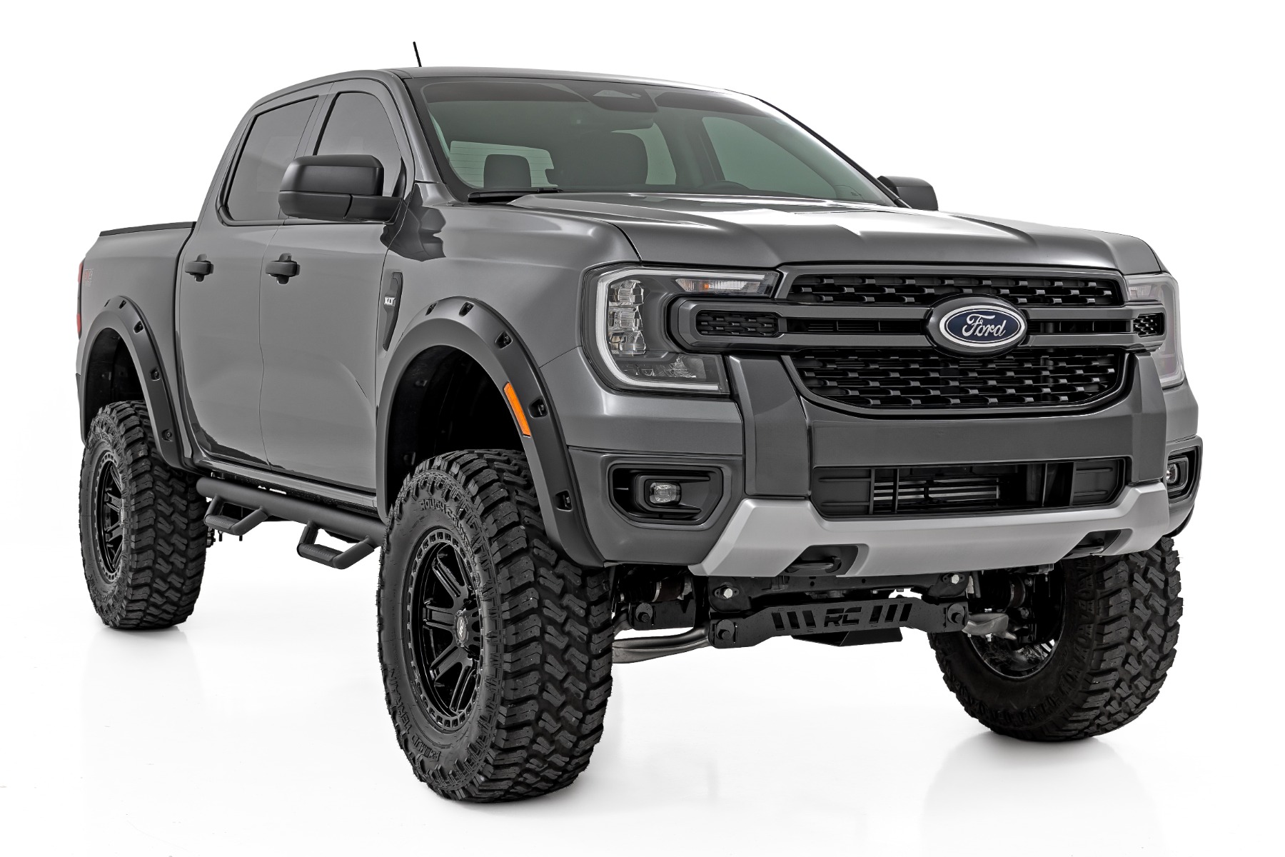

There's always the Rough Country 6" lift.....
