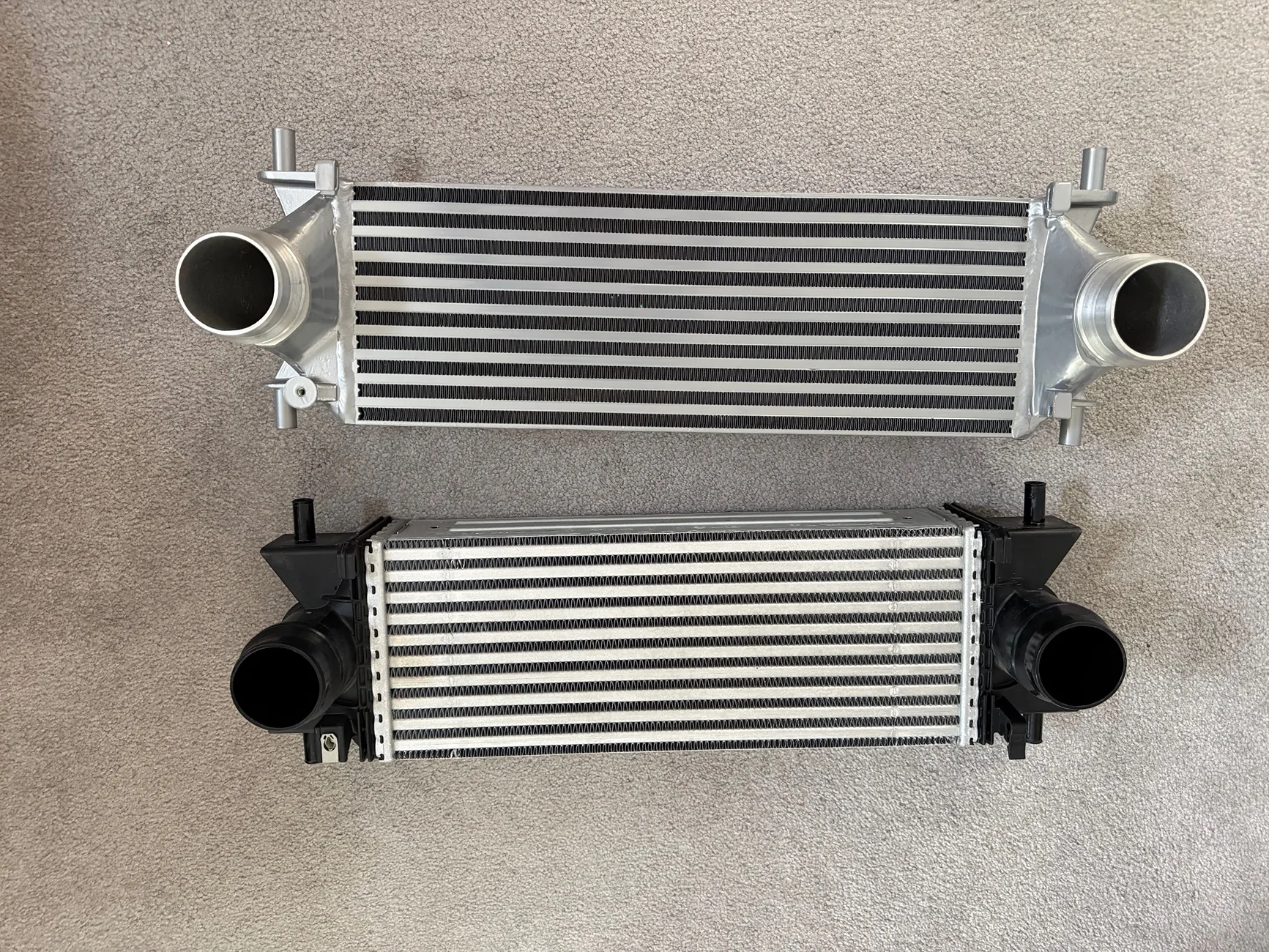

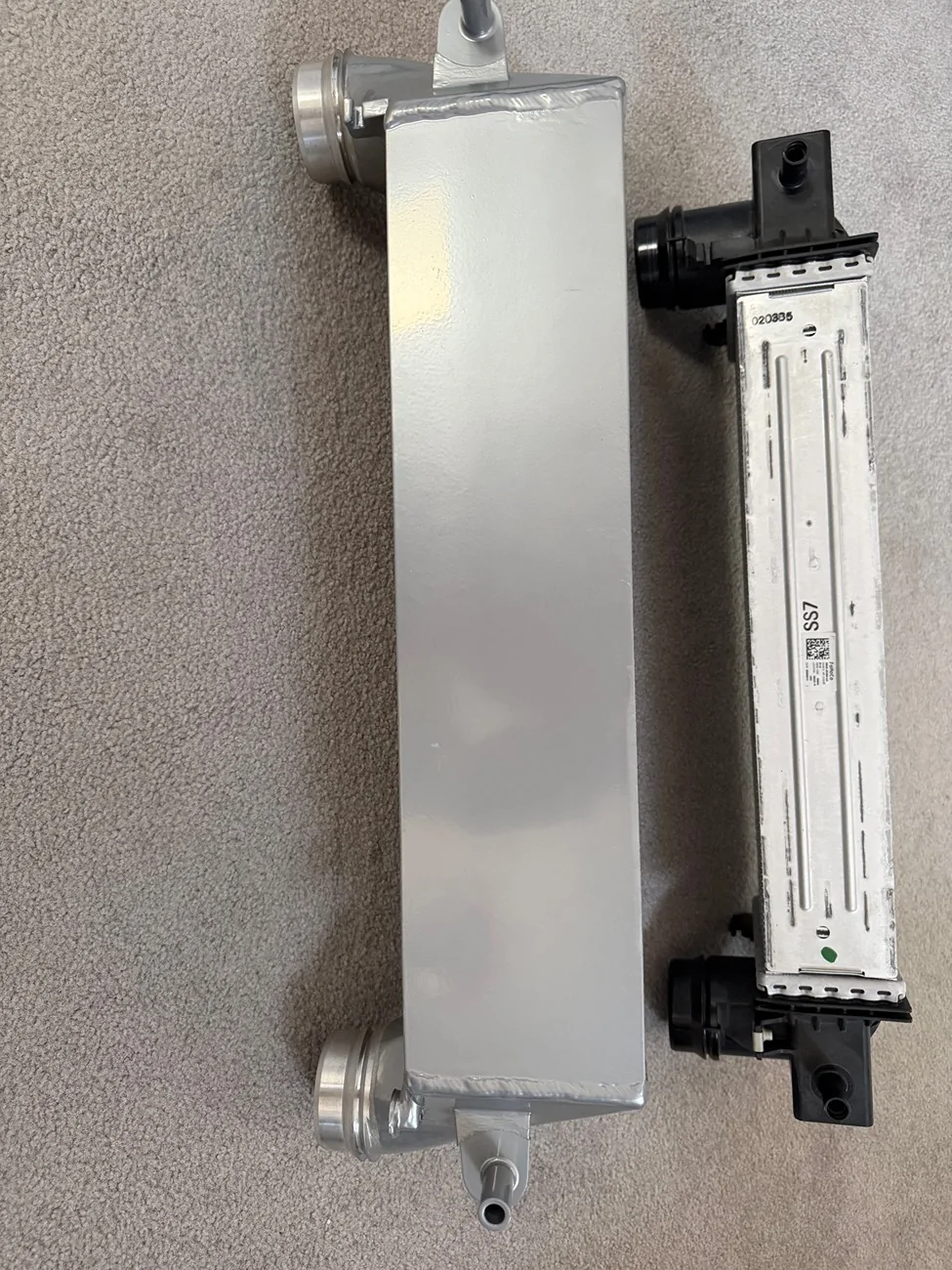

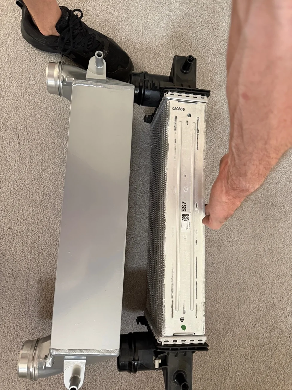

Can confirm,the CVfab air to air cooler does indeed fit with no issues what so ever.
Install took less than an hour laying on the ground,no lift needed.
Everything on my STX can be done from below,including removing the lower air shutter.
Sorry I’m not a big picture write up guy,but once I removed my front skid plate (I have aftermarket skids installed),access is very accommodating.
I chose to remove the motor from the ASG so I could plug it back into the harness and tie it up under,out of the way so as to avoid any codes etc.
Now I wait for Livernois to write my tunes.
Apparently my truck is a newer strategy they have not written any files for to date.
The difference in size,and im sure efficiency between factory and CVfab should be a nice improvement.
