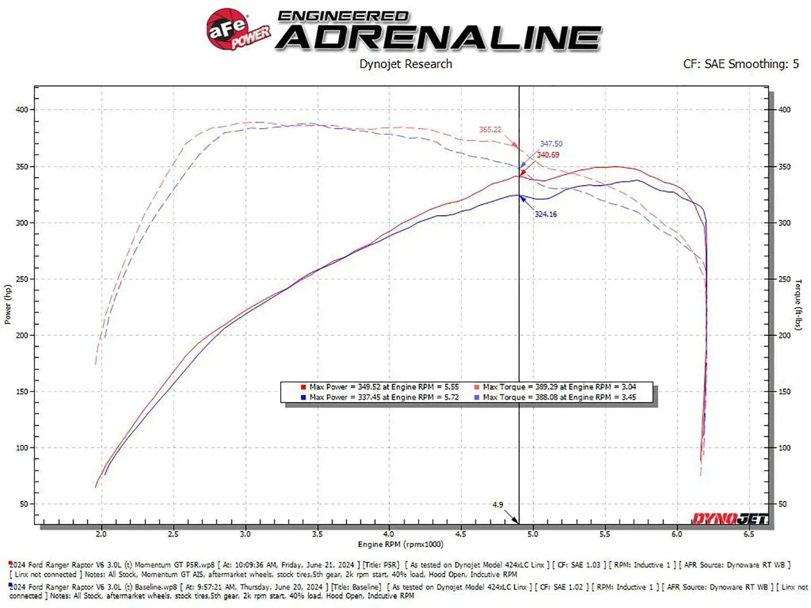

That would be contrary to that dyno on OEM. Appreciate the feedback.
This particular dyno is measuring crank horsepower. Converted 18 hp gain for the intake over stock from crank to whp; is around 11 whp gain taking in parasitic loss at the wheels.
Just to clarify and I can mathematically factor in FPT as well, to give an approximate overall whp gain if needs be.👍🇺🇸
