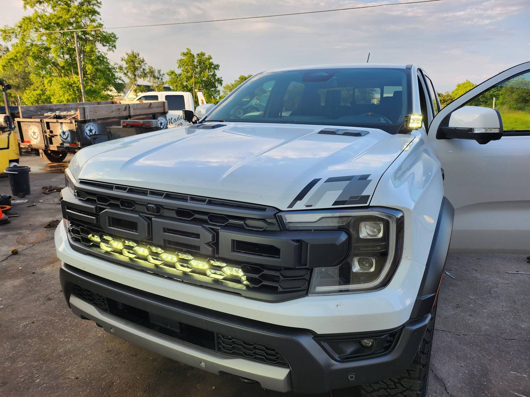

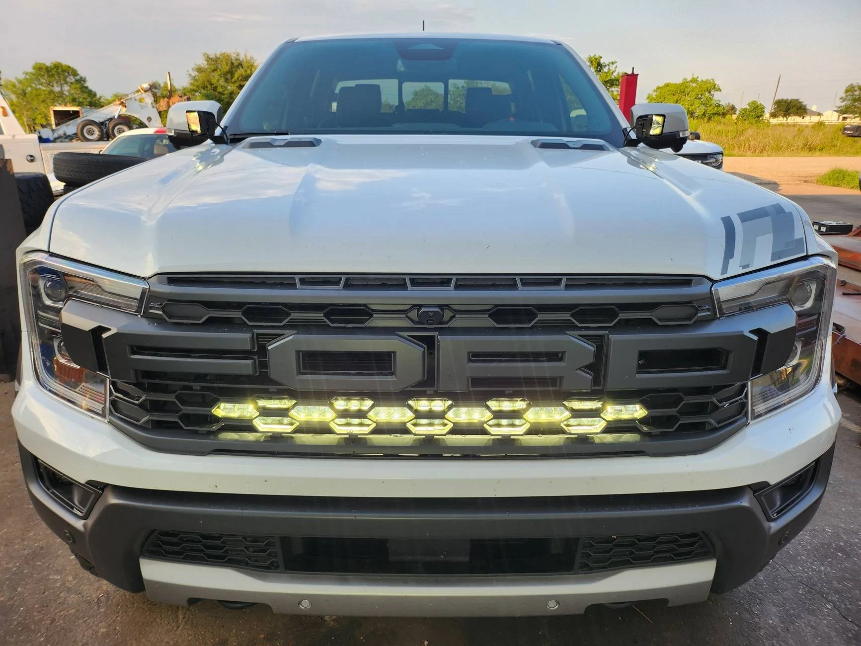

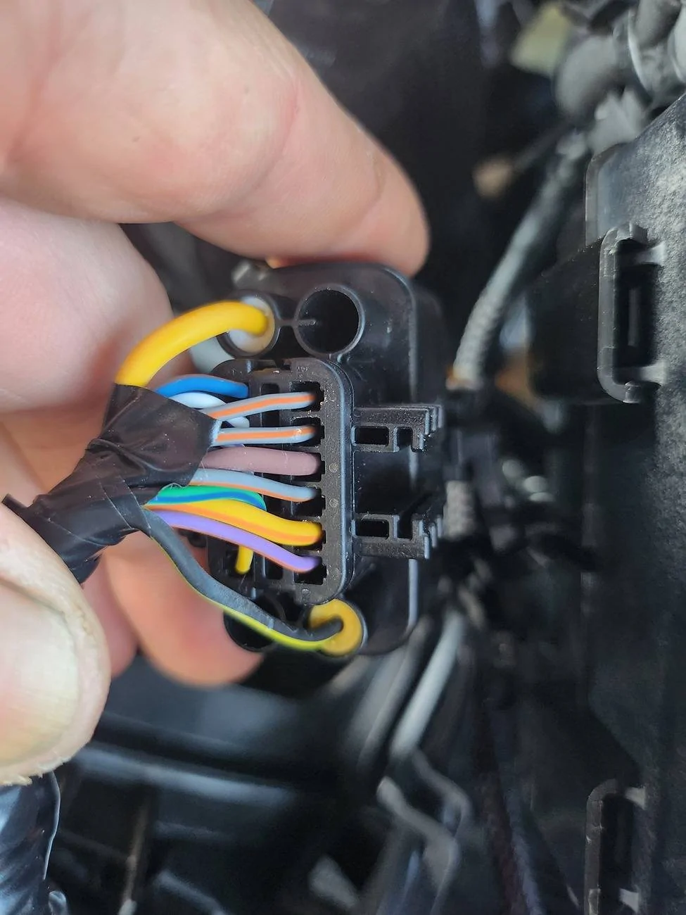

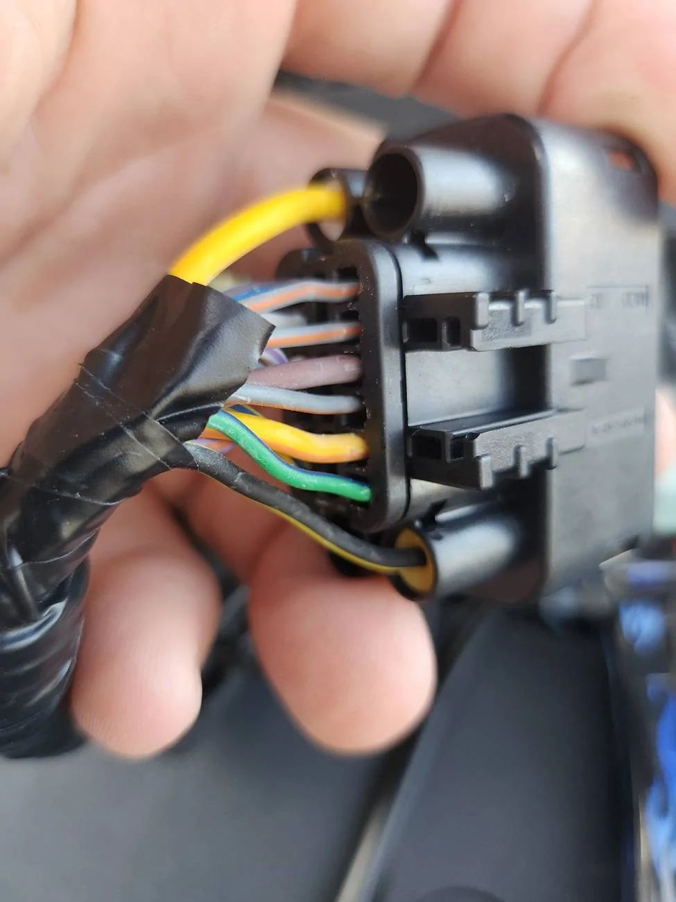

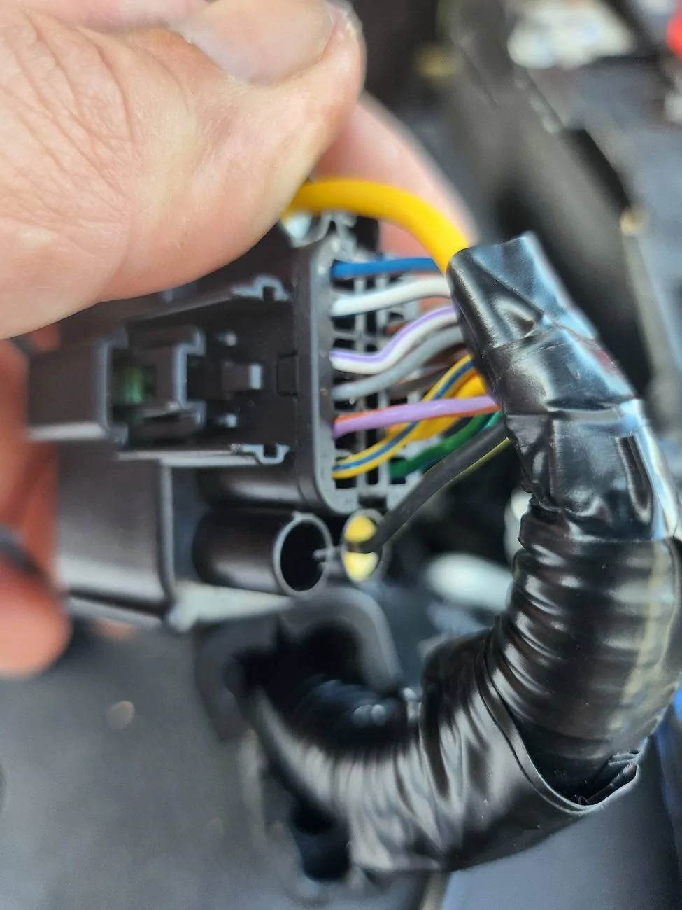

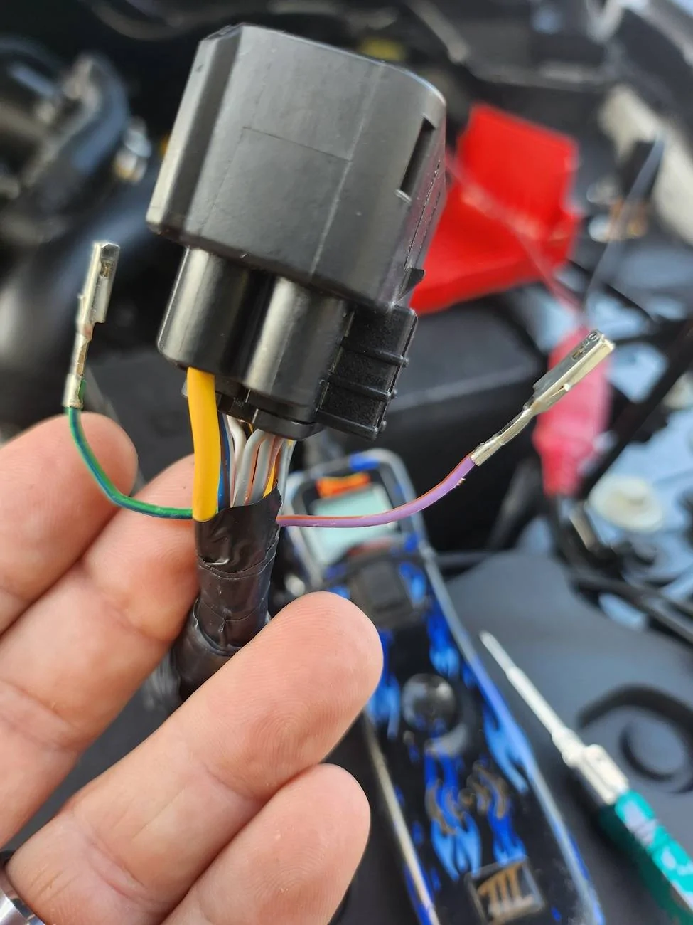

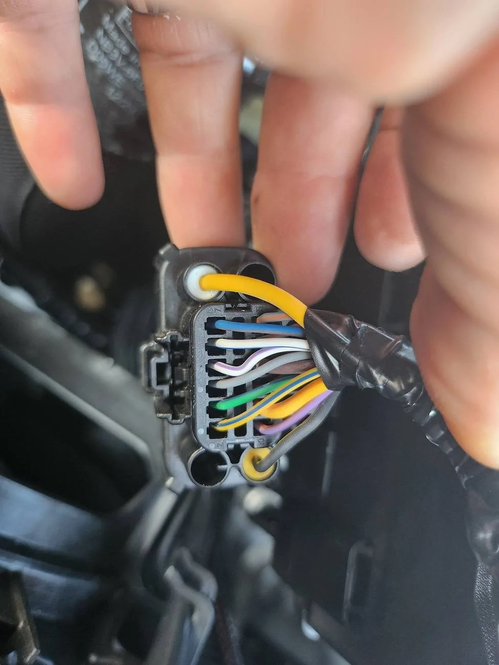

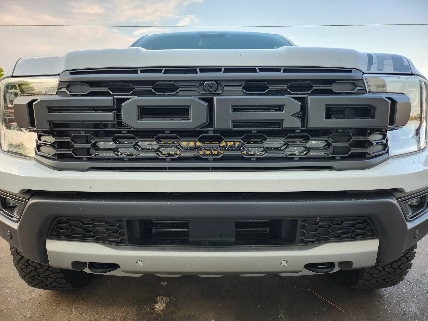

So I installed ditch lights yesterday along with a 32in dual row behind the grill. I went with Rough Country Spectrum series, I like the semi smoked look and they've been tested on my company trucks for several years with no problems. The pre wire harness for Aux 6 was used for the grill light and i used Aux 2 for the ditch lights. I tested the amp draw on a single 2in pod and it was a little over 3 amps so aux 1 was a no go. The 32in draws about 12 amps but i know ill be adding more light in the bumper in the future and I'd like them to be on the same circuit. Here is where my OCD kicked in. I cant stand having the switches for the lights on the front end of the truck so far apart and Alldata doesn't have the wiring diagram for our trucks yet so i did some testing on the truck to find what color wires were assigned to the switches. by swapping the Aux 6&1 pins i moved the 25 amp circuit to Aux 1 and now I can sleep in piece. I figured I'd put the wiring pinout on here in case anyone else would want to do it.
Main color/Trace color
Aux 1=Green/Blue
Aux2=Grey/Brown
Aux3=White/Violet
Aux4=White/Blue
Aux5=Blue/Brown
Aux6=Violet/Orange
