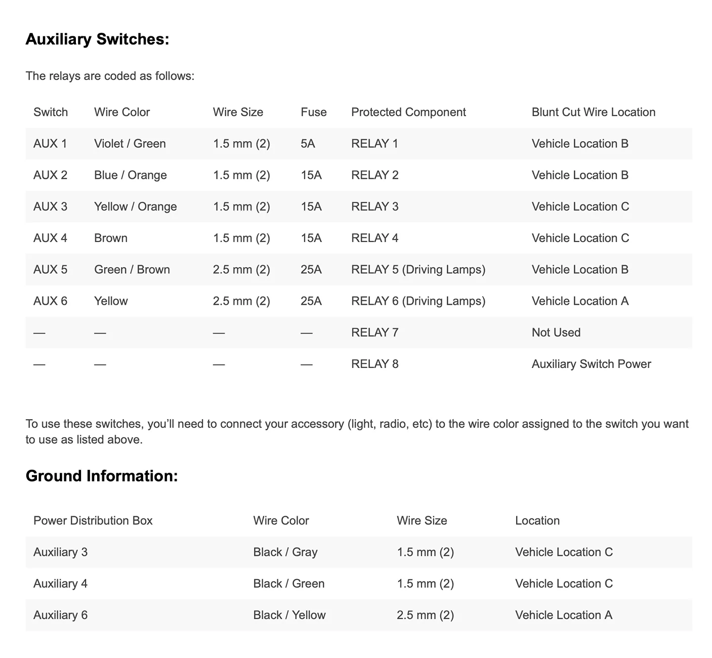

I’m considering wiring in raptor lights to aux 1 on a 2025 Ranger Raptor. I know the power supply is violet and green. Is there a corresponding ground wire color to be used?
GLW
May 26, 2024
480
538
Missouri
Not with 1. Ground to frame.
Not on 1. Ground to frame

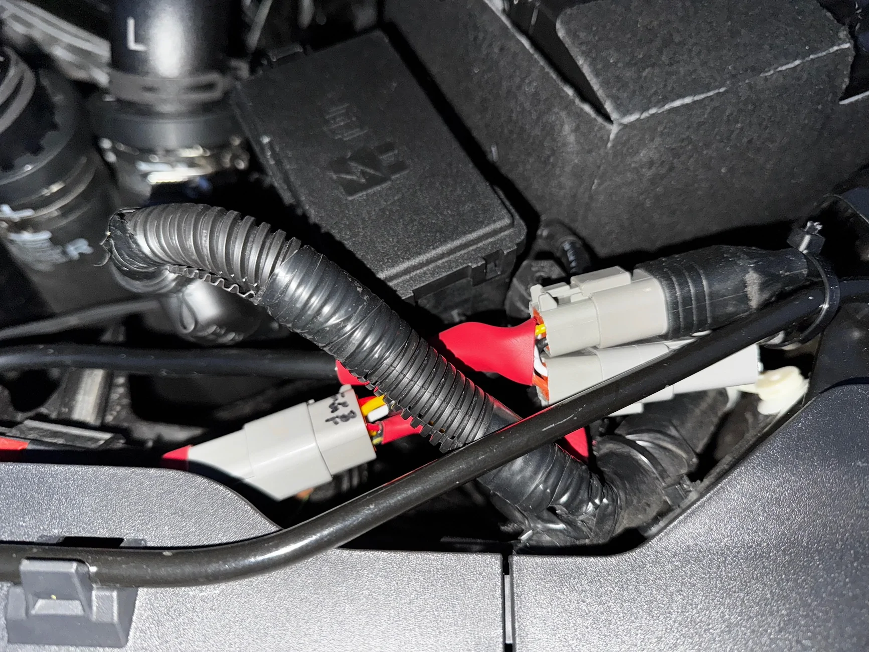

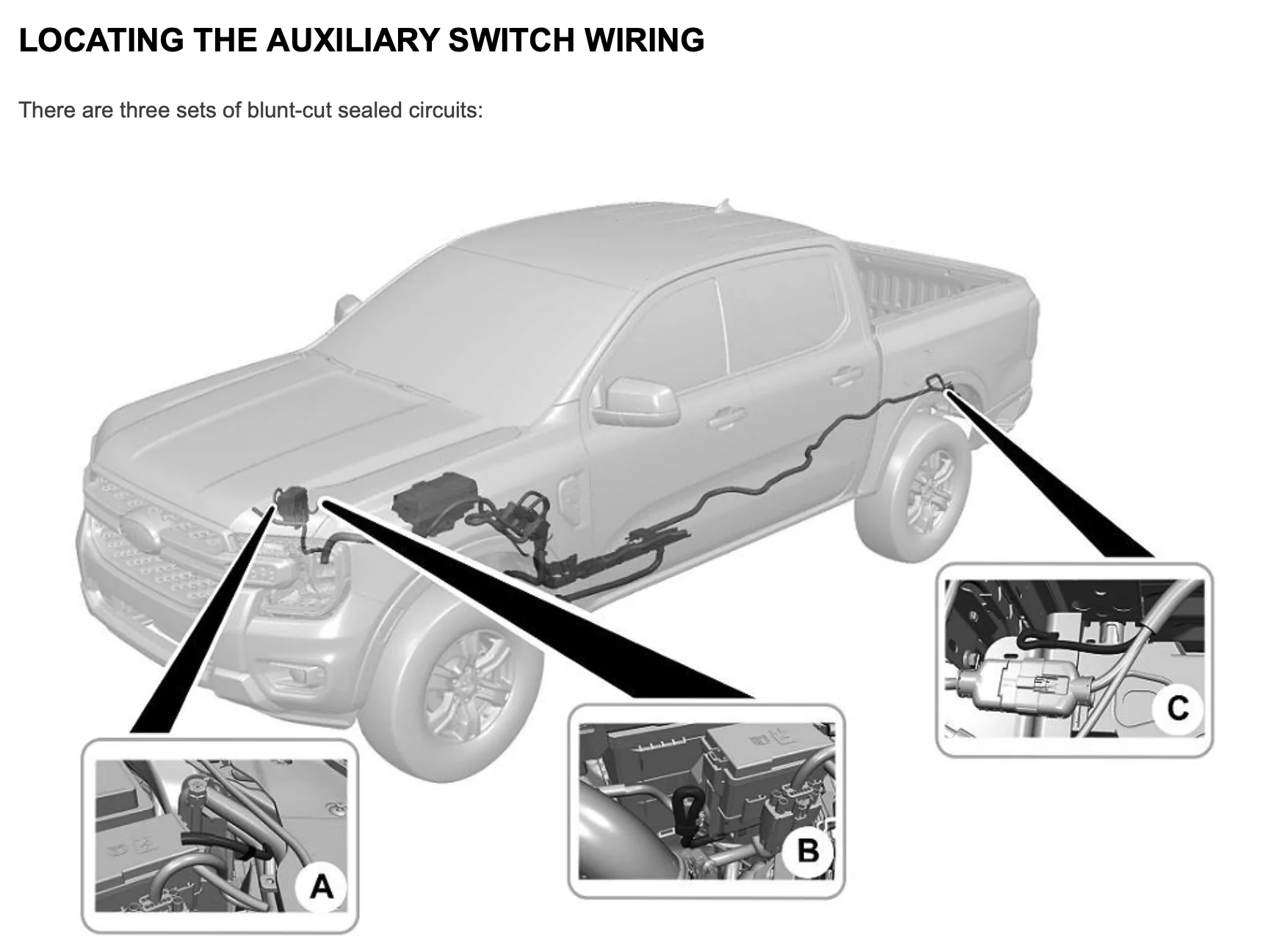

Whichever wire you are using sounds like it is permanently energized, not one of the outputs from the AUX switch box. We need to a see a photo of which wire you are using to energize the LED.
What I did to simplify this process was wire all the underhood outputs ( 4 AUX wires, ground, plus a DRL tap) into a single DT6 Connector.
This way I can add\subtract LED circuits using Y-splitters without having to rewire\solder\crimp
If you then use DT-4 Connectors for the splitters you can run two circuits plus a backlight, or three independent circuits with no backlight to each Light location on one 4C cable. This saves a ton of cabling and allows you to power your various lights independently if you have different colours\lenses or amperage demands for each circuit.
Im running the following circuits with diode dynamics pods on a single 4C cable and 2 Y-splitters
2 x SC3 Driving (hood)
2 x SC1 Fogs (OEM location)
2 x C2 2.0 spot (intercooler vent)
2 x C2 2.0 combo (intercooler vent)
all with DRL backlights
Ford Ranger Aux Switch control 1760322569580-5a
Ford Ranger Aux Switch control 1760322553027-mc
Ford Ranger Aux Switch control FullSizeRender 2
Ford Ranger Aux Switch control 1760323897793-wv

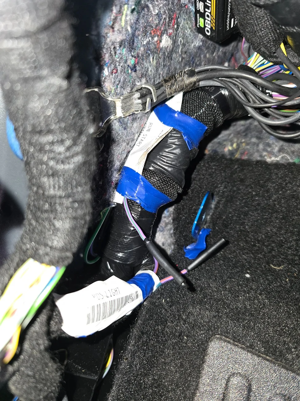

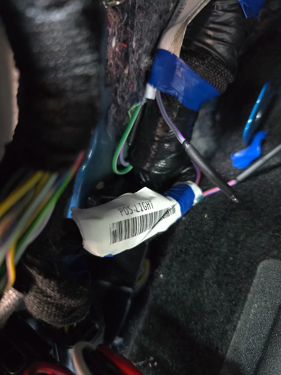

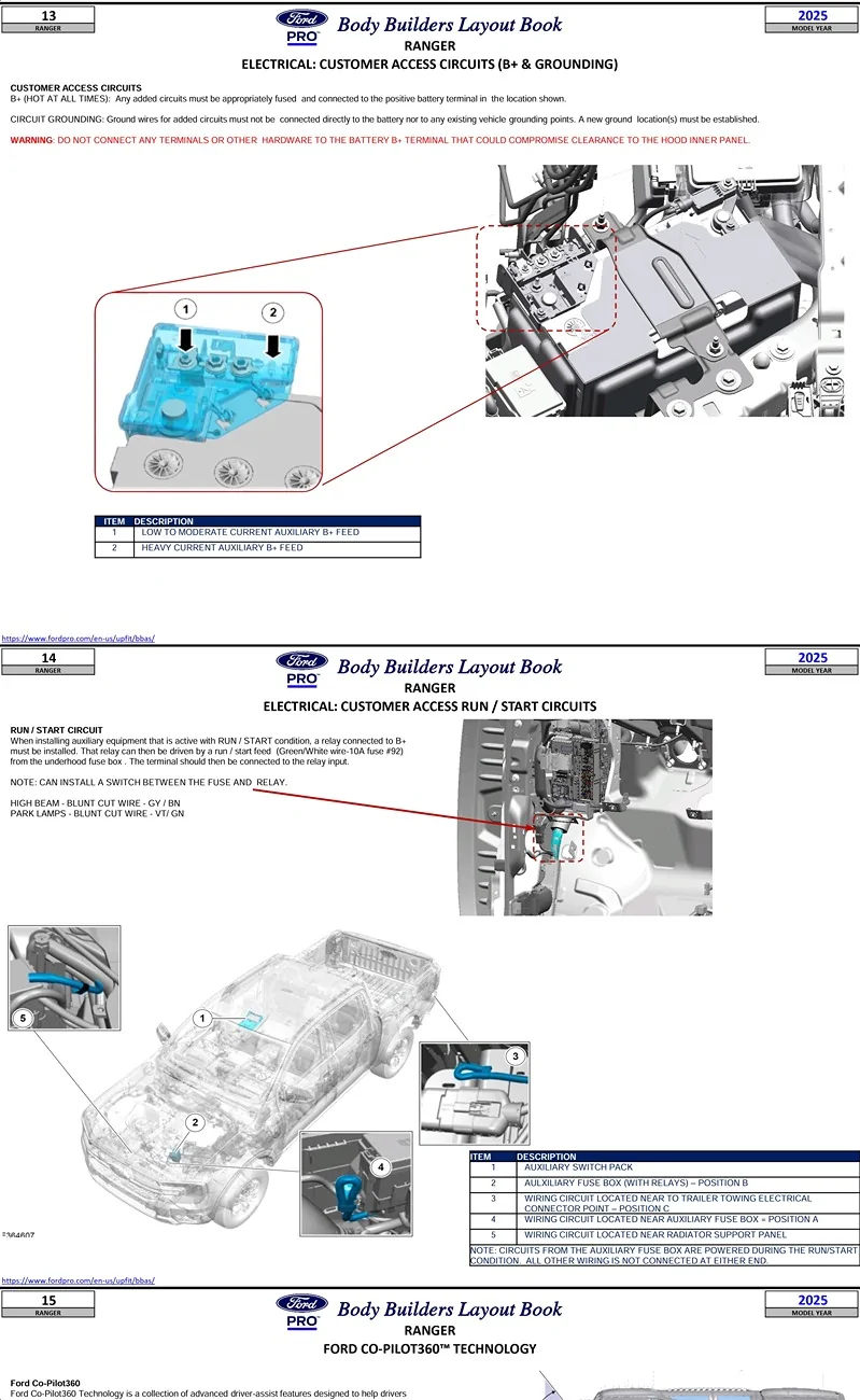

theres 3 blunt cut wires under the bcm. a marker light, highbeam, and ignition run/start wire. behind the kick panel

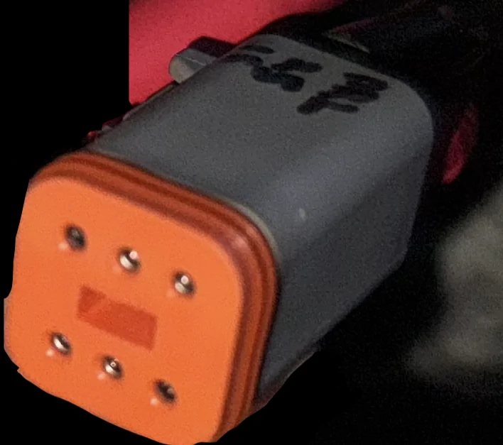

Hi, I am interested in your approach to wiring everything and I think I get it, but not exactly sure on some of the components. So it seems like you were able to get all of the leads at A and B (plus the b/y ground and DRL tap) into one DT6 like this style? https://www.amazon.com/JRready-Waterproof-Automotive-Electrical-Connectors/dp/B0B124YC4R
I guess the part I'm missing is what are you doing between the female DT 6 connector you just made and the 4C cables you are running to each area you want to add lights?
