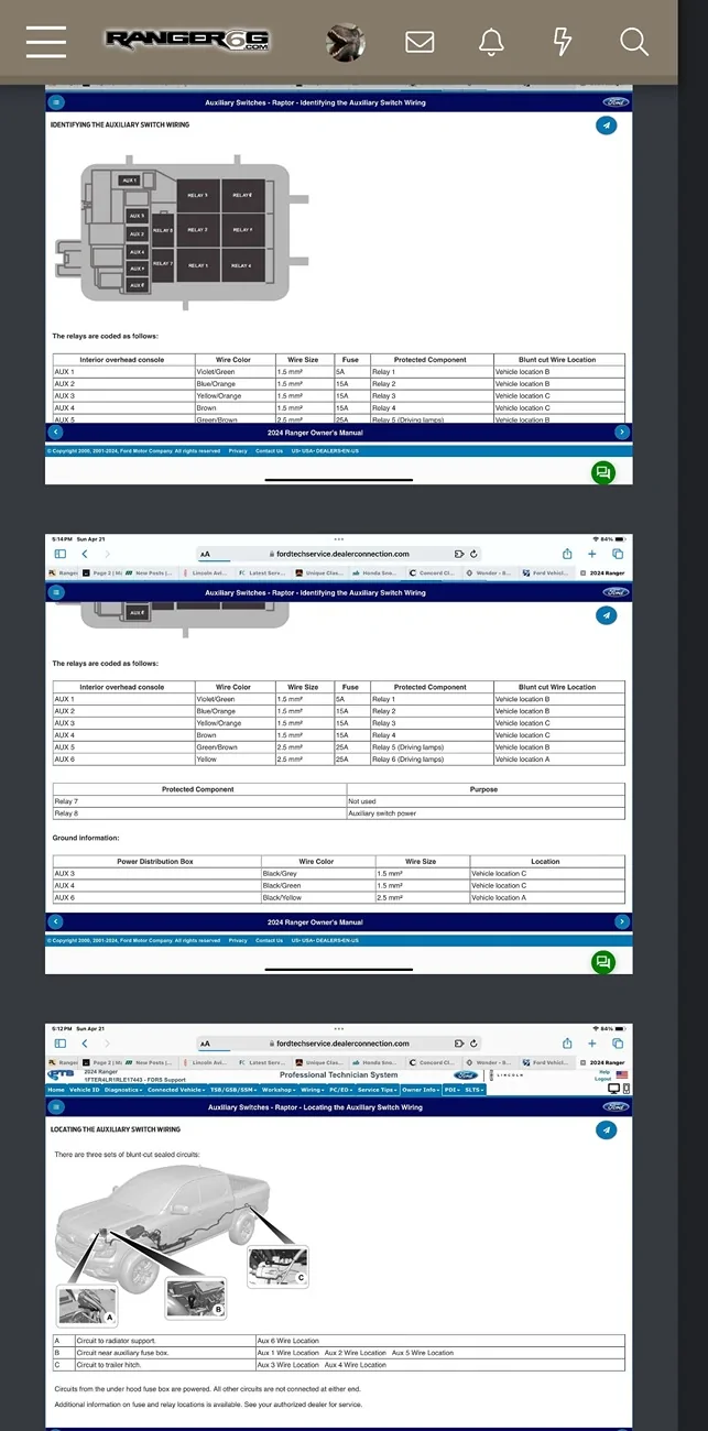

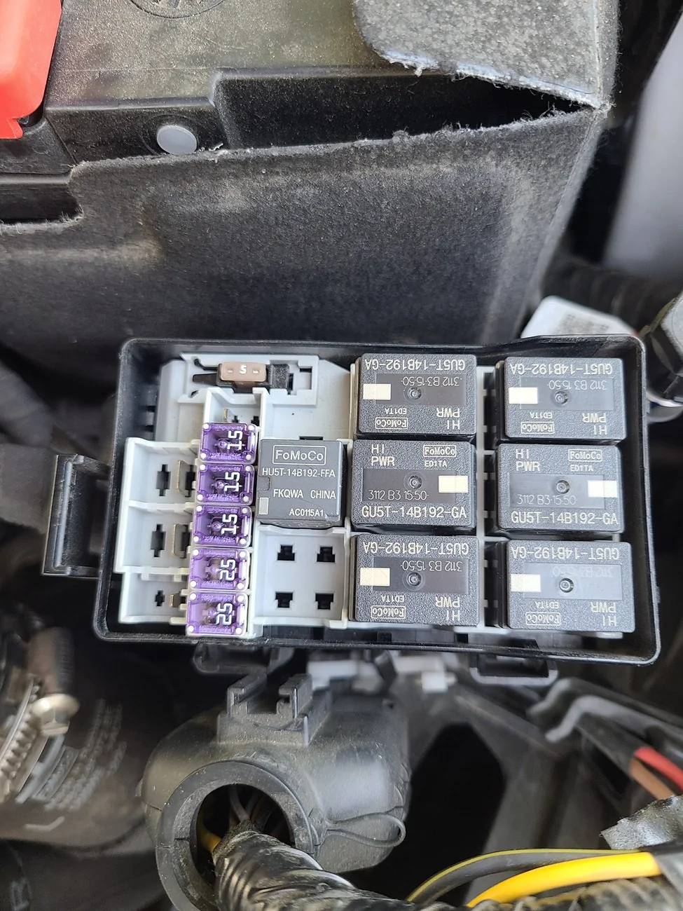

After looking at the relays in the junction box for the upfitter circuits, 1-6 appear to use the same relay part #. Do y'all think we could simply swap fuses around, say aux 3 with 5, to upgrade one of the rear circuits to 25A? This assumes the wiring is the correct guage, which I'm not 100%.
All this came about because I disliked using a 15A circuit for maybe 3A of chase lights, and thought maybe aux 1 and 3 could be swapped. Thoughts?

The fuses are paired to the wiring gauge. So those lower current circuits have thinner gauge

The 15 amp fuse are on approximately 16 Gauge US equivalent wire. The wire can safely handle about a constant 13 amp load and a surge of around 18 amps but will blow the fuse. The 25 amp wire is approximately 14 gauge equivalent and can handle a constant 20-22 amp load and a surge of around 28amps. That's why the fuse ratings are used accordingly to the wiring capabilities. There are variables such as wire length that also plays into an overall situation but stick to the fuses rating on that particular circuit to avoid issues! The fuse size does not determine the amount of current flowing in a circuit at any given time, if the load does not require it. It protects the wiring from too much current flow. Hope this helps! :like:

Well, y'all have answered my question. Guess without repinning the junction box, it's not going to happen the way I want. Next best option, splice into the aux 3 circuit near the junction box with a T-splice, which worked perfectly and, once the electrical tape is removed, can easily be disconnected if I need to run something off aux 3 in the rear.
I'm now debating chase lights on aux 1 and a long wire run to the back of the truck, or aux 4. Thoughts?

Just a quick update and FYI: both of my rear circuits used a solid brown wire for 12v, but had the correct wiring (black/green, black/gray) for the aux 3 & 4 grounds. Of course I cut the one for aux 3 first... 🙄
