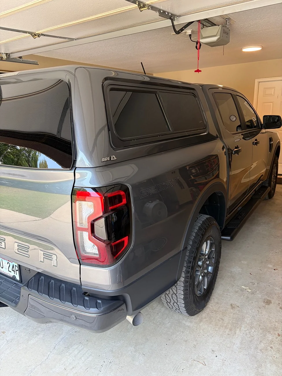

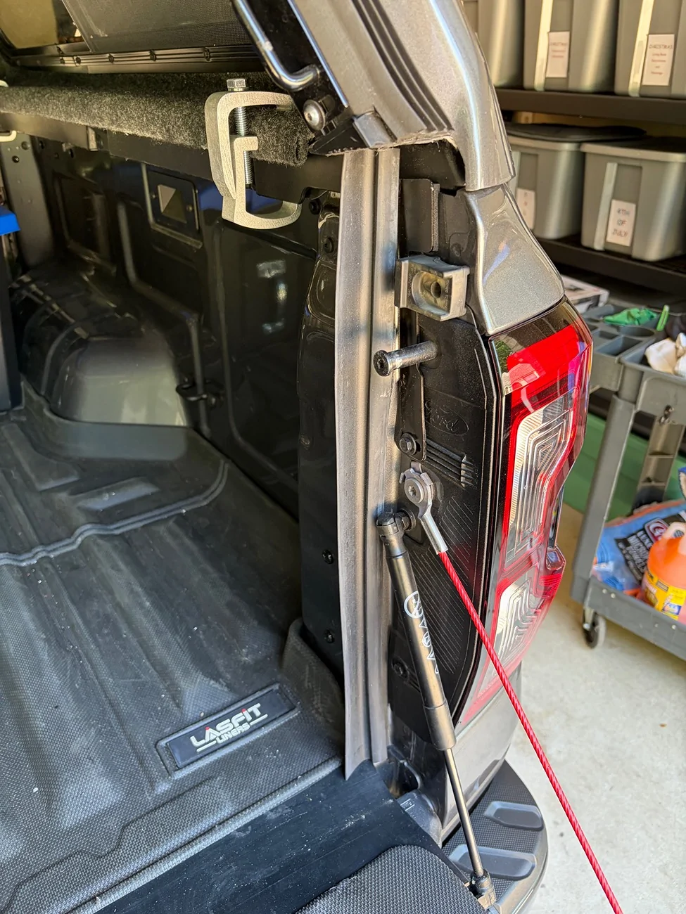

Installed Rok Block and side seals from Keko kit. Flex taped all holes in front of bed. A.R.E. CX Evolve totally eliminated bed rail cap leaks. Sprayed side gaps at tailgate with full force garden hose - no leaks. Recently drove through 2 1/2 hours of steady rain on I-44. Bed stayed bone dry.

im doing this right now. Do you have a photo of the tailgate seal on the tailgate? im not sure how Part A and C are supposed to overlap if at all.
