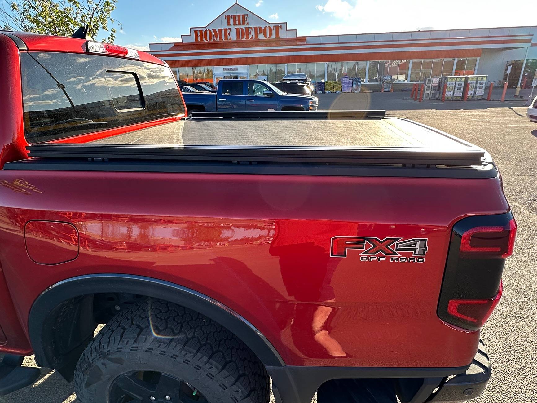

I installed the cover in November. Took some time today to shim it so the top locks in correctly. Still need to sort out the length of the rails and modify the larger/deeper clamps I purchased.

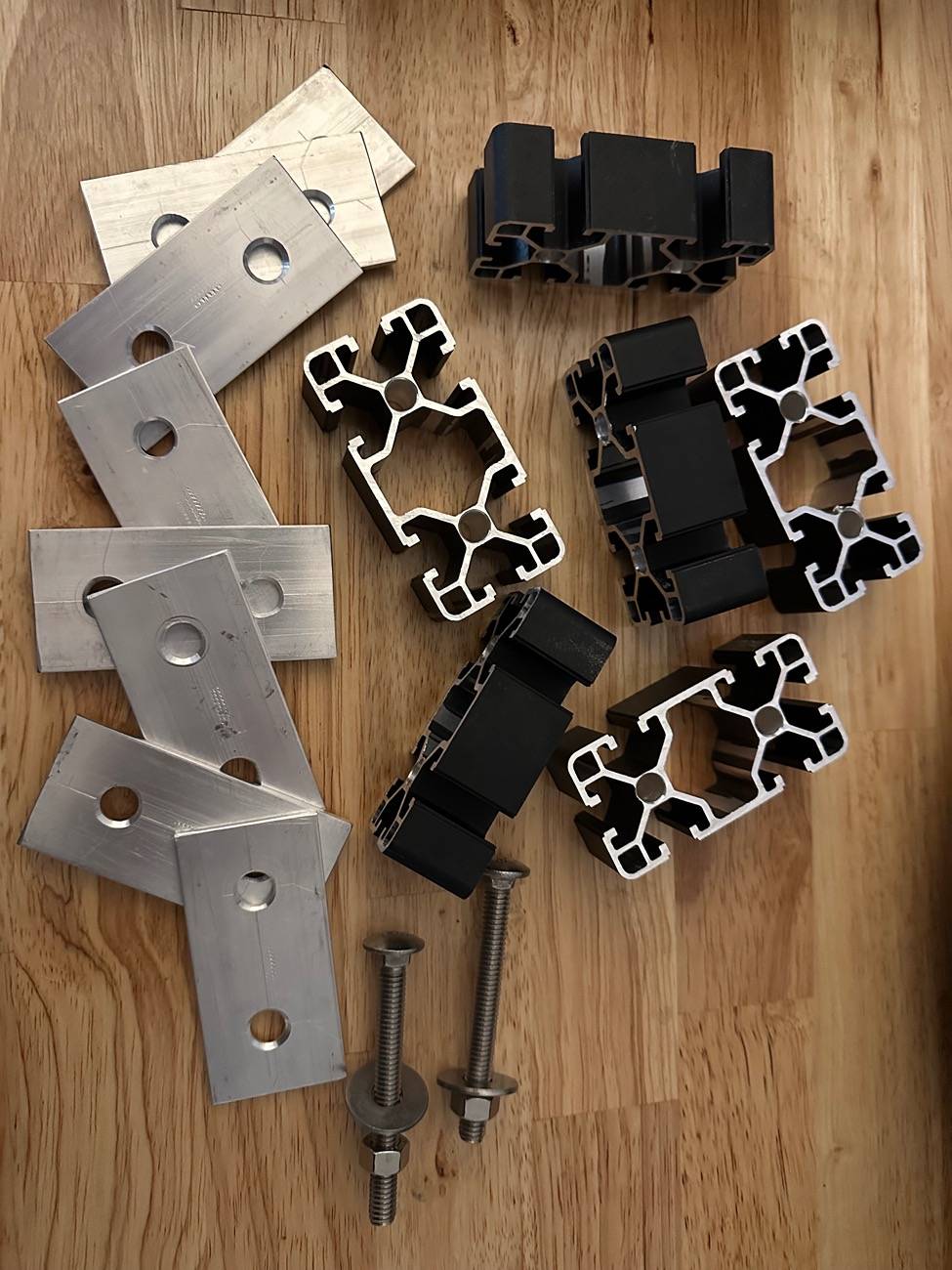

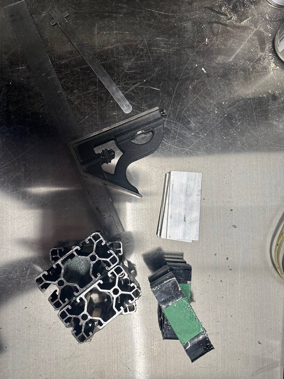

I will be installing extruded aluminum t-slot on each bed rail. This will then support the BillieBars. To do this, I made some brackets to go into the stake pockets. I’ll run stainless carriage bolts drum the slot, through these brackets, and use a washer - lock washer - nut inside the bed. I also cut a few shims as it seems like the bed rails are not flat front to back.

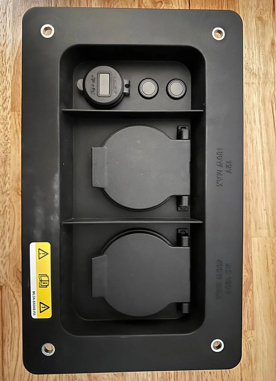

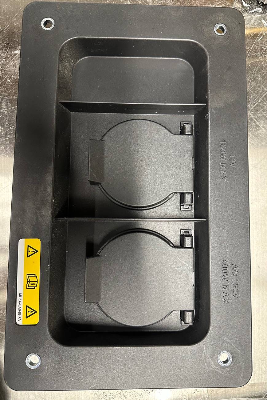

I also added a USB-A QC and USB-C PD outlet and two switches to the panel that holds the 12v and AC outlets. One switch is for some LED strip lights I will add the perimeter of the bed.
A couple pics of today’s work. More to follow once I begin the installation.
Ford Ranger Bed lighting, switches, bed rack IMG_7384
Ford Ranger Bed lighting, switches, bed rack IMG_7381
Ford Ranger Bed lighting, switches, bed rack IMG_7389
Ford Ranger Bed lighting, switches, bed rack IMG_7388

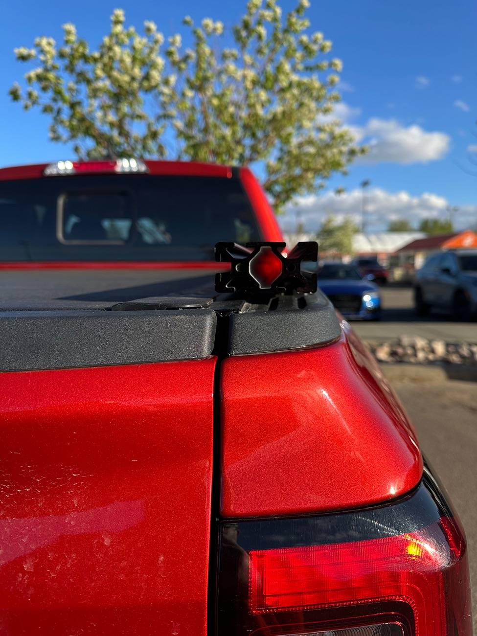

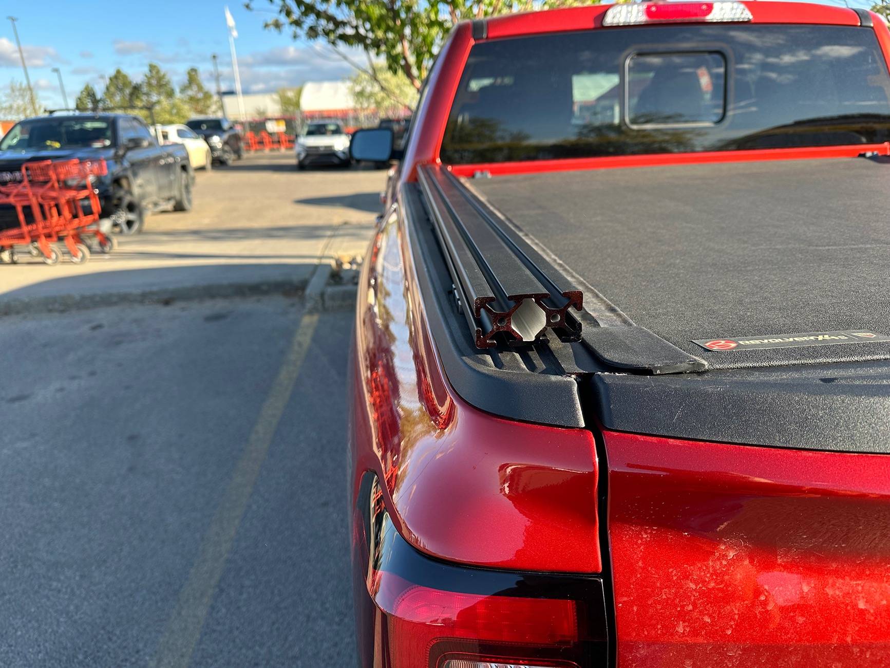

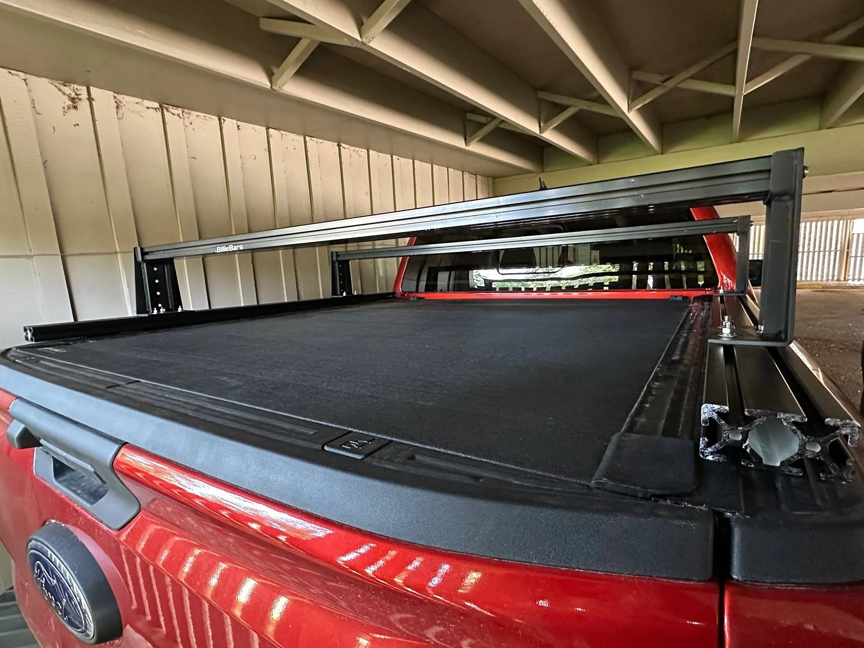

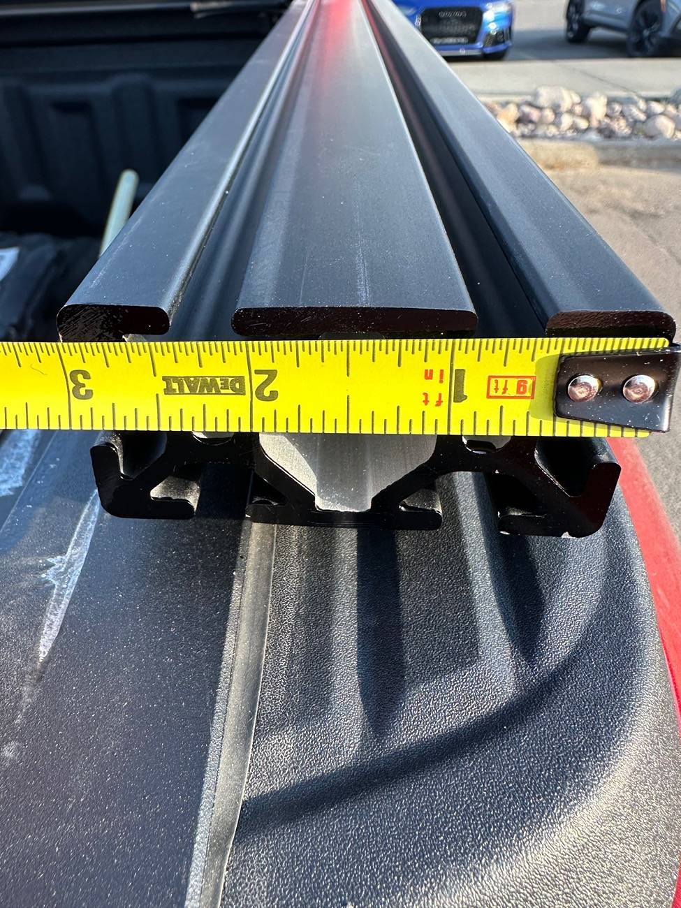

I got the tonneau cover sorted. Also mounted the aluminum extrusions along the top of the bed rails. Each stake pocket has 2 5/16” stainless bolts and a 1/8” aluminum backing plate under. These are pretty solid. The BillieBars will lock it all together even better.
Ford Ranger Bed lighting, switches, bed rack IMG_7398

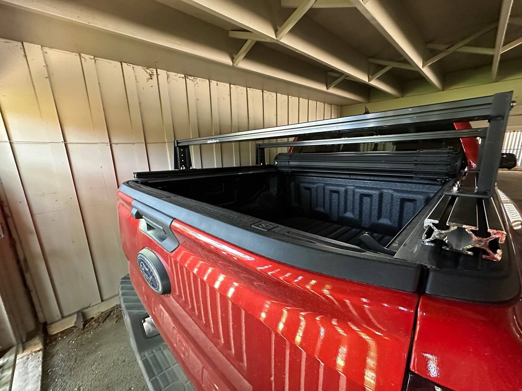

My son welded up the holes I drilled in the brackets to mount to my 2021 Ranger. I promptly drilled new holes! Hit them with some paint and they are better than new. I added a couple layers of high-performance genuine simulated carbon fibre vinyl to the underside.
I had to cut down the cross bars and then tap the holes for the hardware.
Mounted everything using stainless hardware. I’d be happier if the 1” bolts were closer to 3/4”. I might change those, or add some caps.

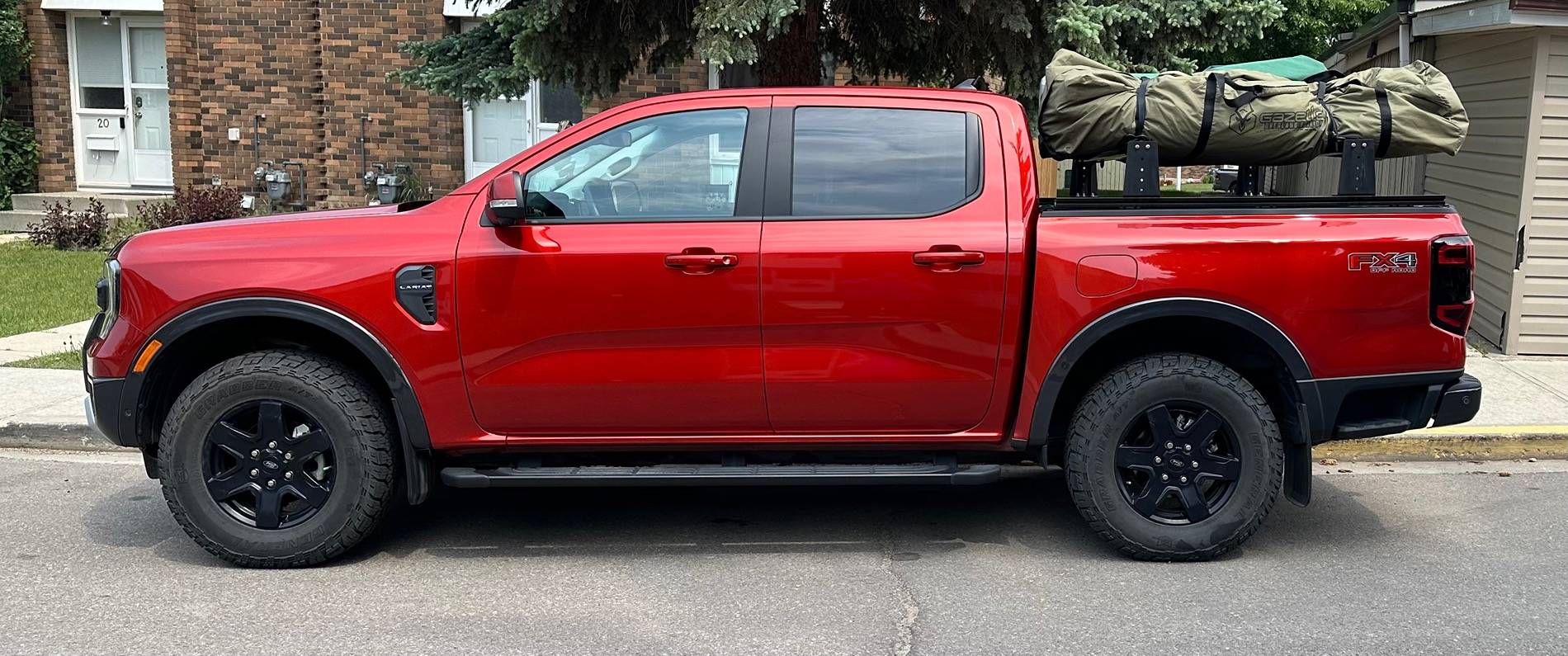

This weekend, we will load this up with camping gear and supplies for a two-week journey in the mountains.
Here are a couple pics. The truck is in the shade. It’s dirty. The bars have a couple scratches. It’s got that lived-in look.
Ford Ranger Bed lighting, switches, bed rack IMG_7621
Ford Ranger Bed lighting, switches, bed rack IMG_7622

Ready for the road.
Ford Ranger Bed lighting, switches, bed rack IMG_7659
