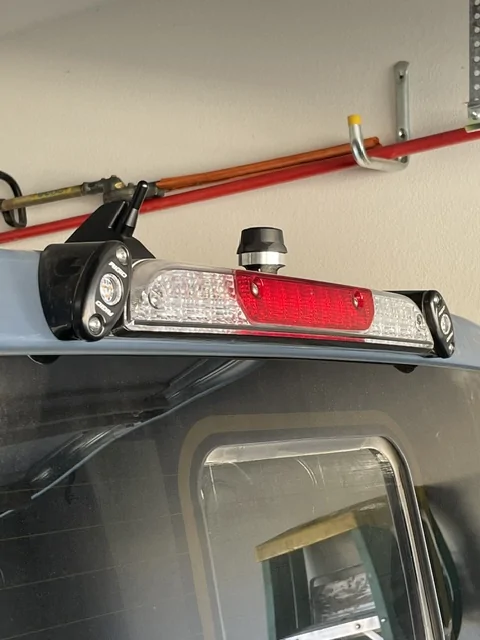

I have the BulletProof Diesel third brake light antenna mount with Rigid LEDs. I have been very happy with it. Picture shows it with Rugged Radio NMO rain cap on. The thing I like about it is no drilling holes in cab, and it uses your existing OEM third brake light fixture which some of the others don't (swarfworks). If I was to do it over now, I would consider getting a third brake light with
1) antenna mount, 2)chase lights and 3) starlink mini mount all in one.

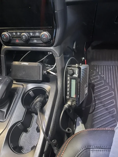

I installed third brake light fixture myself, then had my local Ford dealer run the coax cable to passenger side for radio hookup, and run the power wire for chase lights to driver side. They pulled down the headliner and both A pillar covers (something I did not want to mess with)
I ran the chase lights off AUX switch #1 (5 amp switch.) and ran the radio off AUX switch #2 (15 amp switch).
I used the Rugged Radio mount. This mount attaches to passenger seat bolt, no drilling, no cutting, and holds under the roughest conditions. I assume it would work for PCI radios too?
