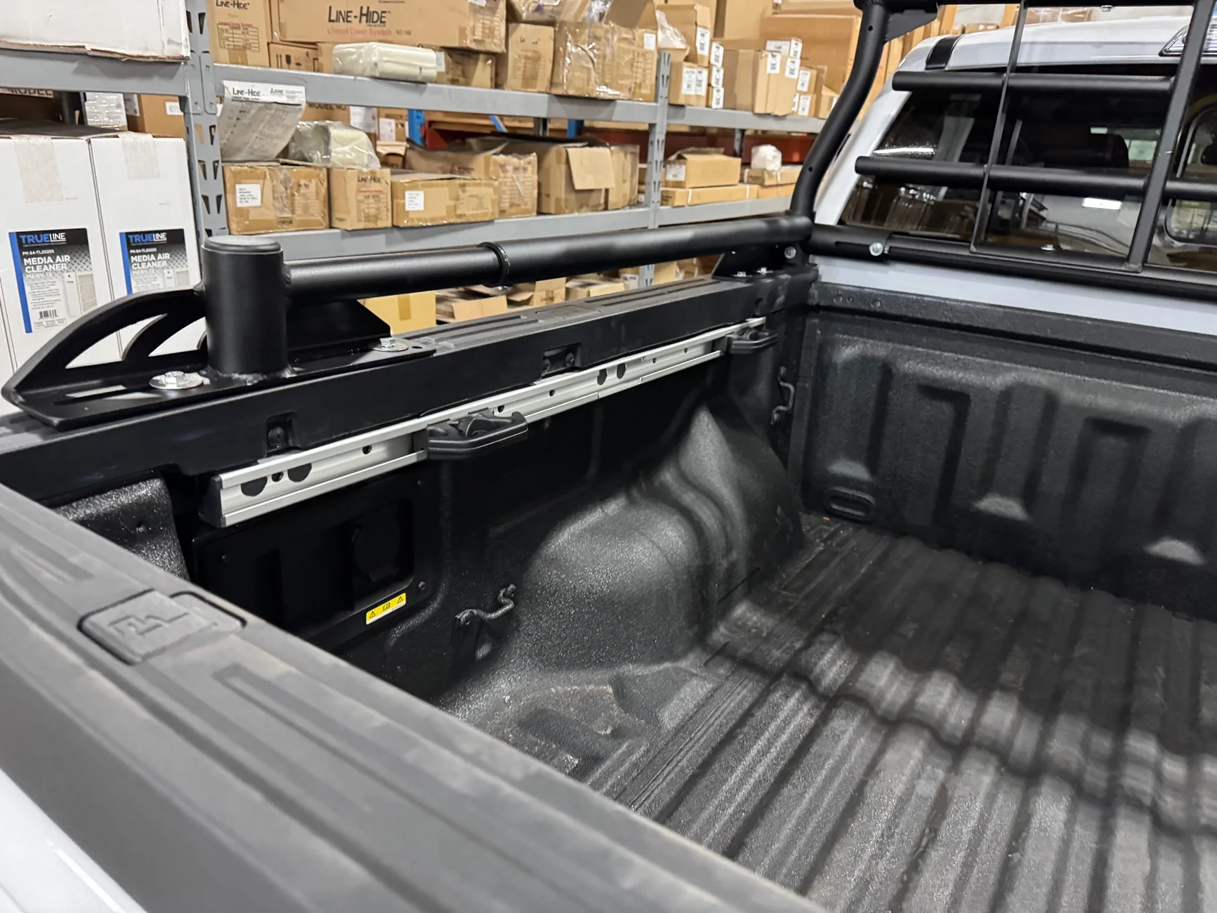

It might work with a drop in liner , I am not for sure.
‘It’s pain to install with a spray in liner. Liner gets in the holes and has to be removed from the holes to be install.
Also know to be in conflict with mounting brackets for many different bed covers as well as toppers.
Also can be a bear to install with bed rails in place.
