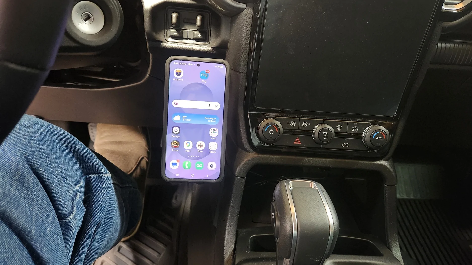

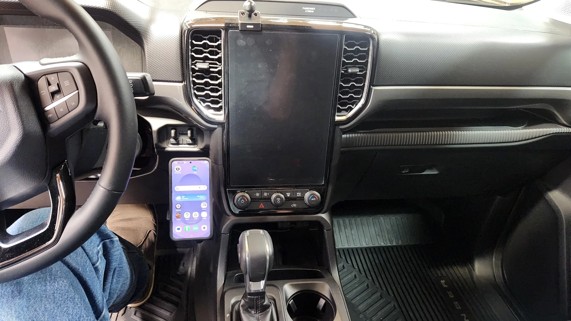

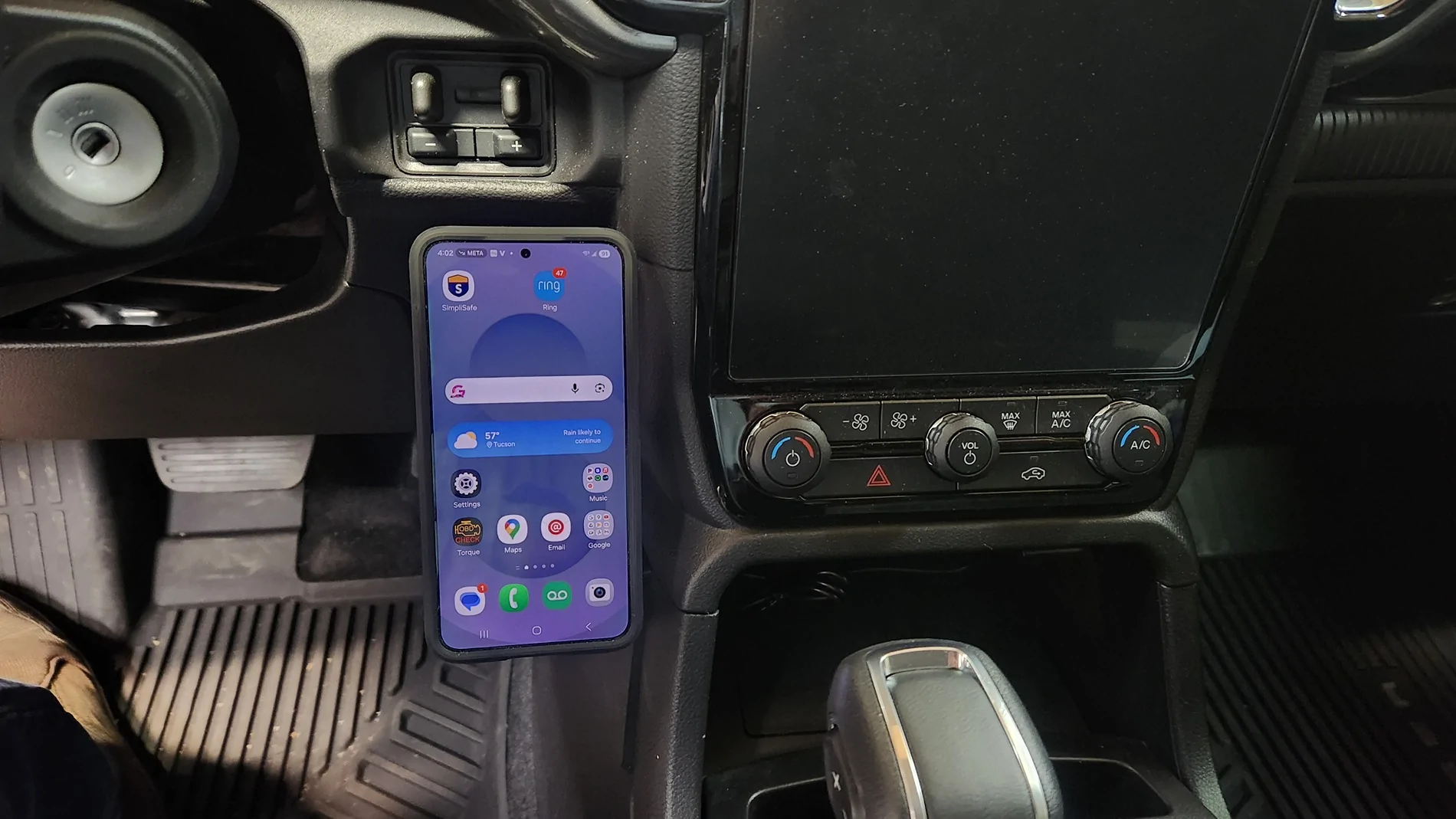

I have the Offroam which is a great mount, but I did not like my phone sticking up on top of the dash and there is no need to be able to look at it since I use Android Auto although it is still very visible from the driver's seat. I wanted a fast, easy way to plop my phone on a magnetic charger, and be visible so I don't forget to grab it when I get out which I tend to do if I leave it in the pocket, plus I have to fumble with the charging cord.

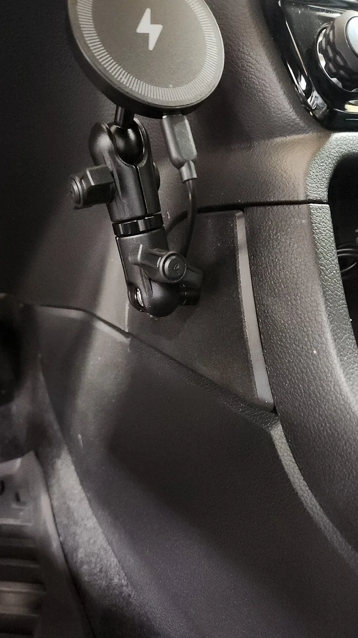

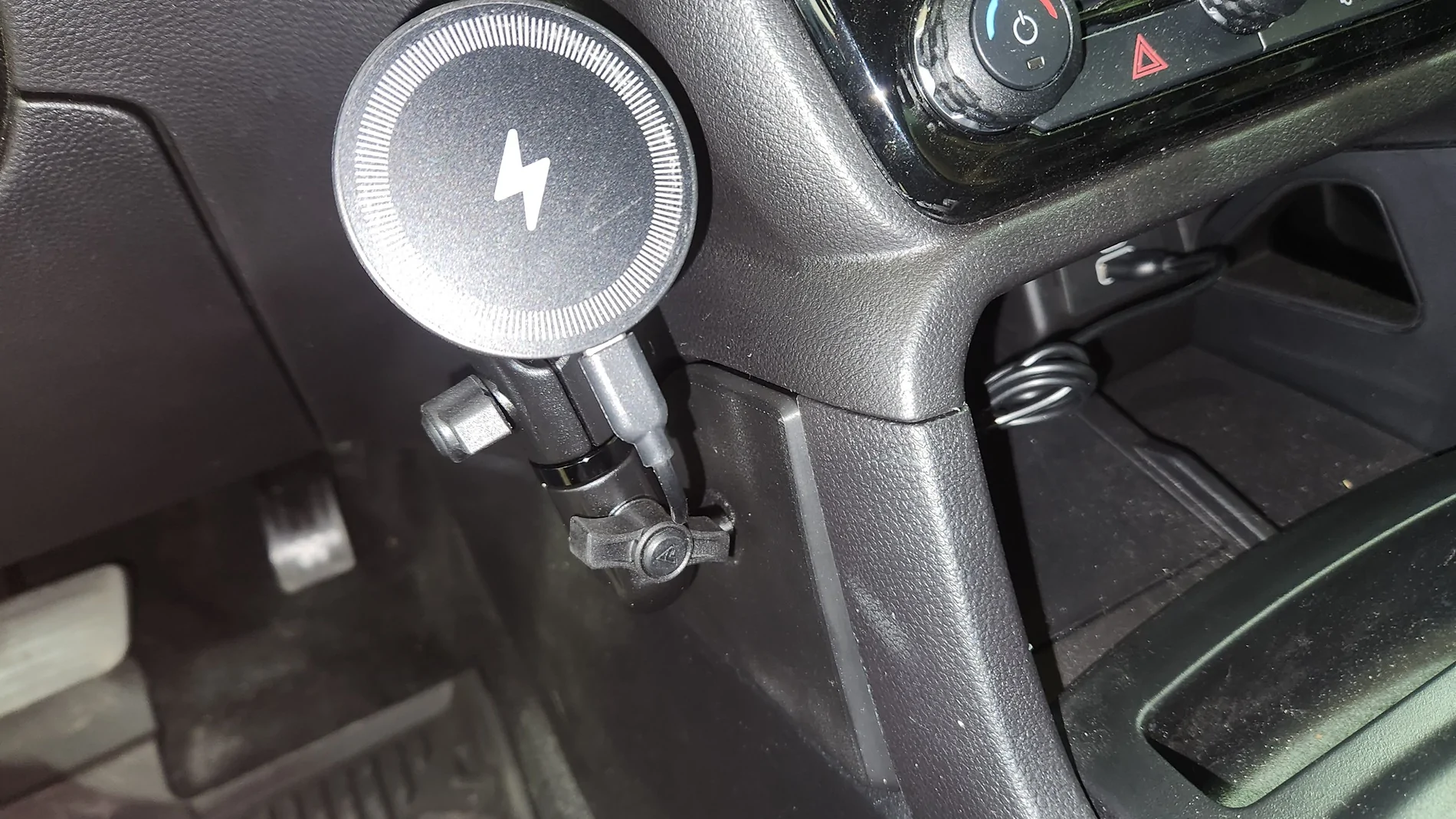

Enter the Digital Twin Development console side mount: https://digitaltwin-developments.co...ptor-everest-console-mount-next-gen-left-side Shipping to the US can be a challenge on this but I was getting their tailgate seal kit anyway and he combined the shipping which helped.
And the Tackform TF-BS-14: https://www.tackform.com/products/m...nnection-enduro-series?variant=15643840610355
Attached to the double swivel Tackform AR20-2070: https://www.tackform.com/products/b...m-with-anti-theft-knob?variant=44089203785902

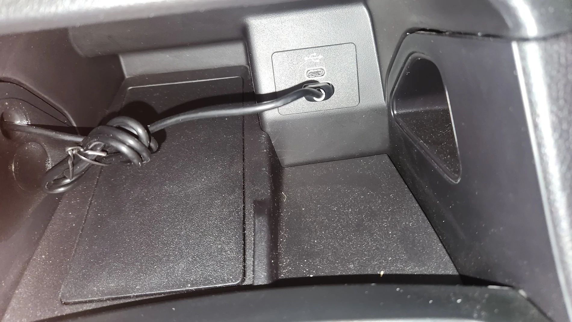

And the charging head of your choice, I chose this one and it is solid, magnet is very strong on my Magsafe case and charging is excellent but not so much that it gets hot (the USB A to USB C cable I use may help to reduce current): https://www.amazon.com/dp/B0FV7WS9RX?ref=ppx_yo2ov_dt_b_fed_asin_title
Put it all together today and I am very pleased. In case you're wondering, no it is not in the way of my leg or knee.

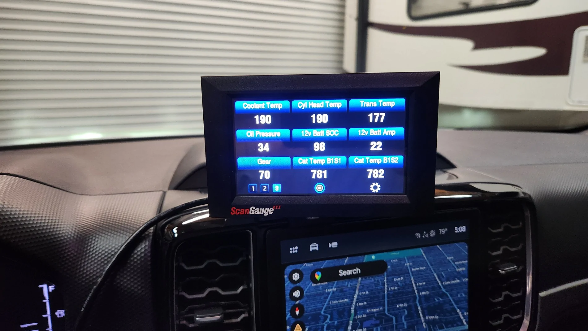

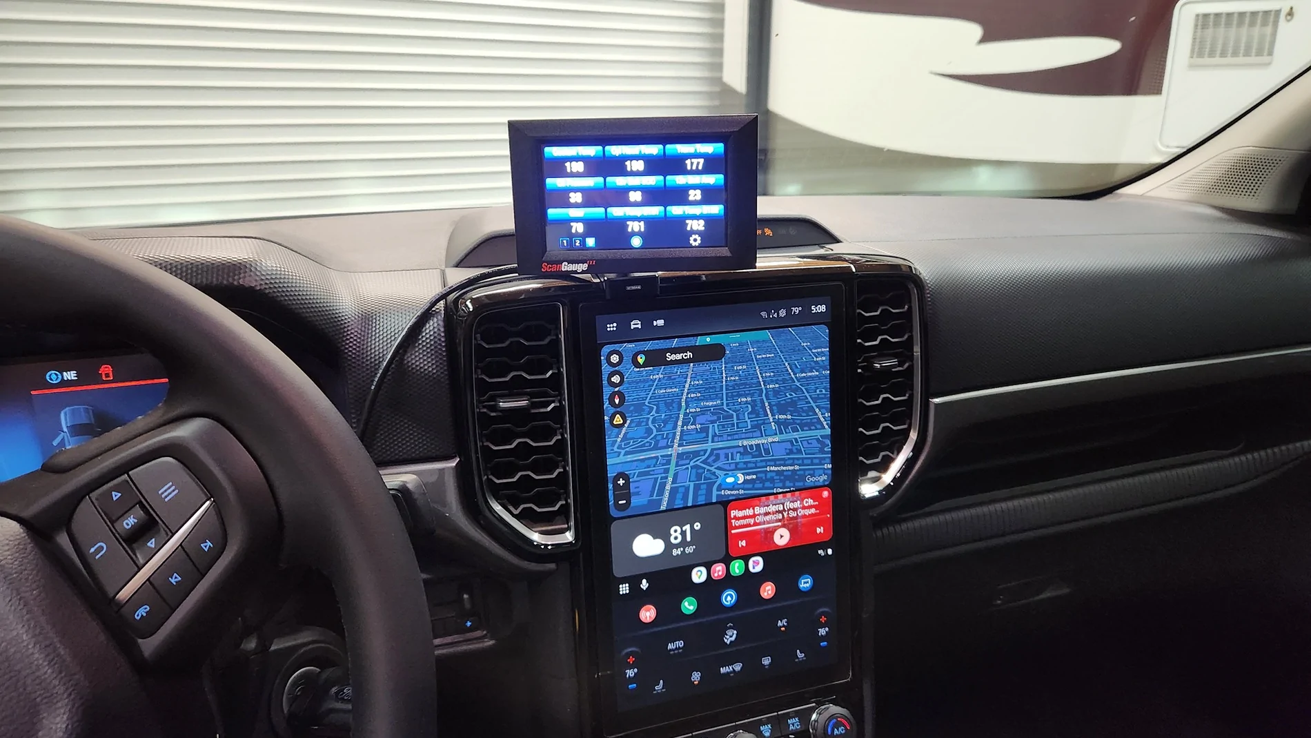

I'll keep the Offroam for when I want to use my Scangauge 3.
