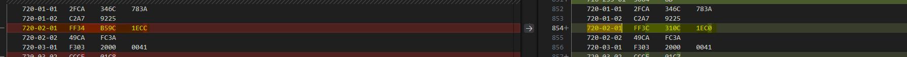

Adress 7D0-09-02 are identical the same i don't think it will be in there.
On the other hand adress 720-02-01 aren't the same. But the bit you're mentioning is the same.
Ford Ranger Disabling overspeed warning chime EU spec vehicles delivered after june '24 1727104336082-1
On the left is my configuration (without over speed chime), right is the configuration with over speed chime.
The bit you have highlighted is one of the two checksum digits, not the * in x*--, but either way, they both are still the same (the E in this case, which would be 1110, bit 1 being 0, or disabled), so this doesn't seem like it's the issue as both still show disabled.
Sorry, then, not sure what else could drive that setting then.
