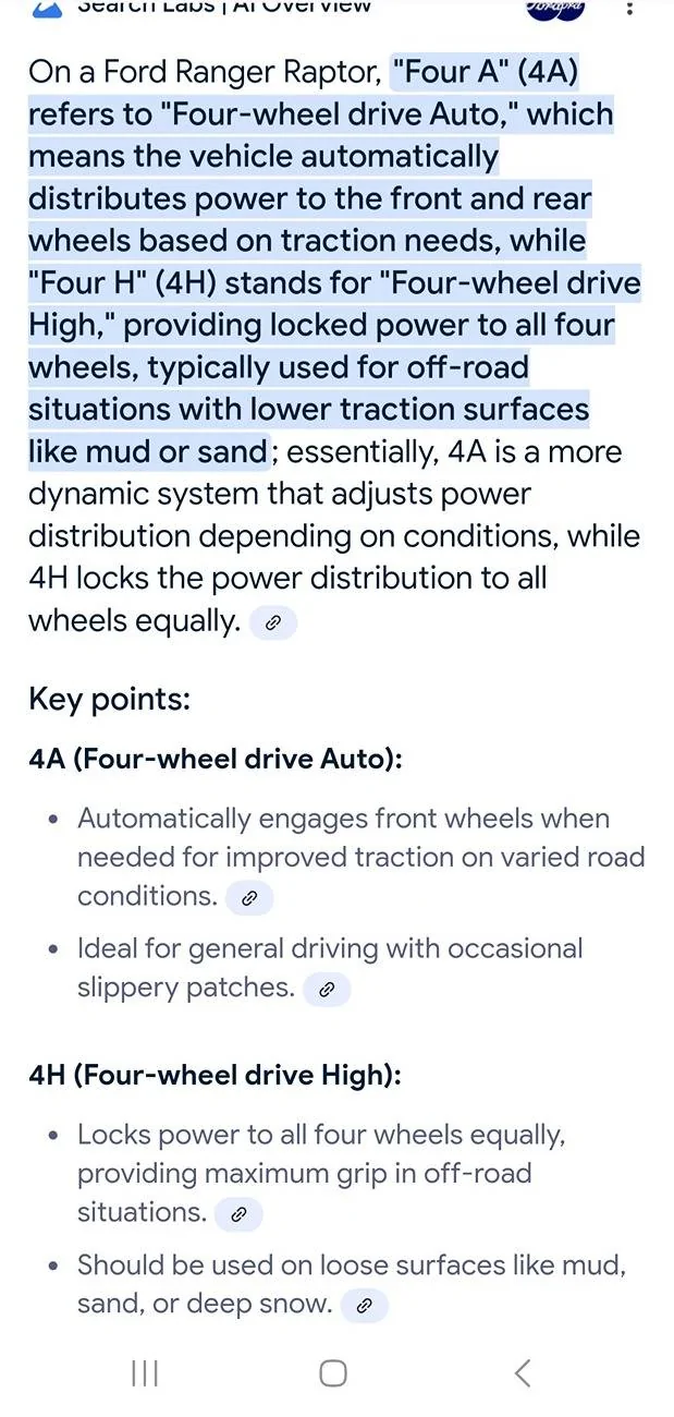

I know this is dumb but I'd rather know, I use 4A sporadically as needed, but I'm guessing it is ok to drive in 4A all the time without damaging anything?
I asked the same question on several of these threads with no luck. So I just now asked Google, and Google used whatever AI system it does on Android, and this is what it gave me.
That's pretty much what I thought all along. I still don't know if this is correct. Because AI can lie to you sometimes. But I would guess if we have 4A and 4H, this makes total sense. Unless somebody else can chime in with some factual information, I am going to believe this to be the case. I do feel more comfortable now that I found this, hopefully you as well. Maybe start a thread "4A vs. 4H" and post my screenshot.
Ford Ranger Disabling auto start stop. Screenshot_20250113_174542_Chrom
