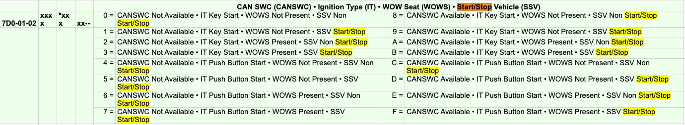

Anyone tried changing the value to one that is a non SSV in the APIM module to try and disable start-stop?
