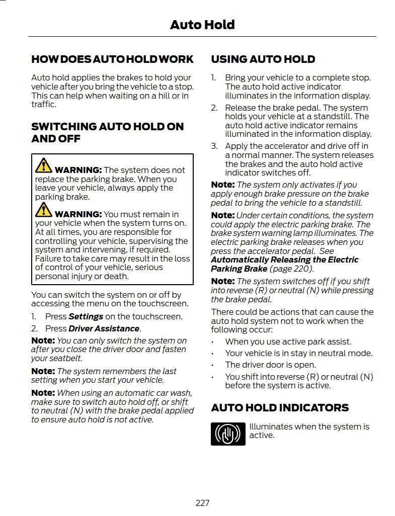

There is a switch in the settings menu that allows you to turn that off. The hill hold function continues to work properly with it switched off.
Does that work on the 2024's ? If so can you provide some guidance on where to find that setting?

In terms of what the manual says:

I have same issue. I just lightly press gas pedal and then brake to move for few inches. Was hoping there is a temporary override workaround.
I just discovered a workaround .If you take off the seat belt while at a idle speed and moving very slowly the auto/hold feature is disabled and the seat belt alarm does not come on .The truck will continue to move in forward or reverse while breaking as many times as needed to park.

Another feature that is bothersome while parking is Auto Hold. Great in traffic, but a pain when pulling into a tight garage. Wish it was activate by a pump on the brakes like some other vehicles, instead of through the menu.

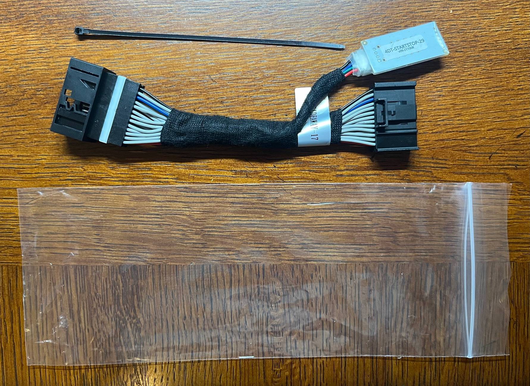

I added the 4D eliminator on Friday. Works a treat and easy to install!
