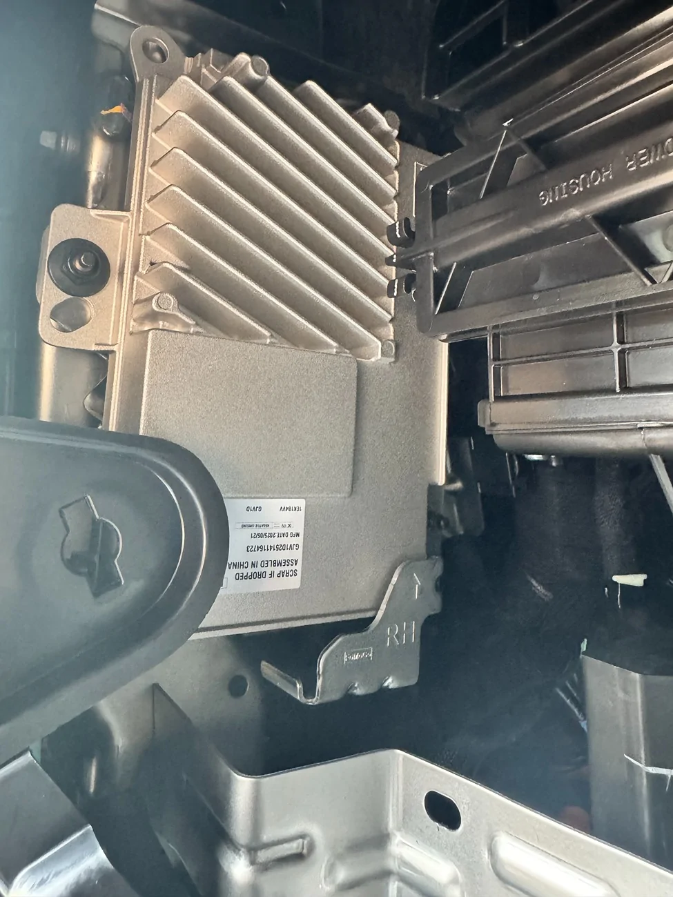

Just got my 2025.25 RR and have tried to install the stop start eliminator i got from RA Ranger.
Seems mine has a protective bracket in the way that prevents the cable from being removed?
Anyone else had this issue/found a good way around it?

The 4D Tech ASS eliminator plugs in where the OP is indicating. My 2025 XL does not have that protective bracket, which would seem to make it nearly impossible to unplug the cable. If one of these other options uses a different connector, I might recommend that route to the OP.

There is a YouTube video that shows this bracket. The person in the video bent it out of the way to install the Stop/Start eliminator.

Woah, didn't expect so many responses.

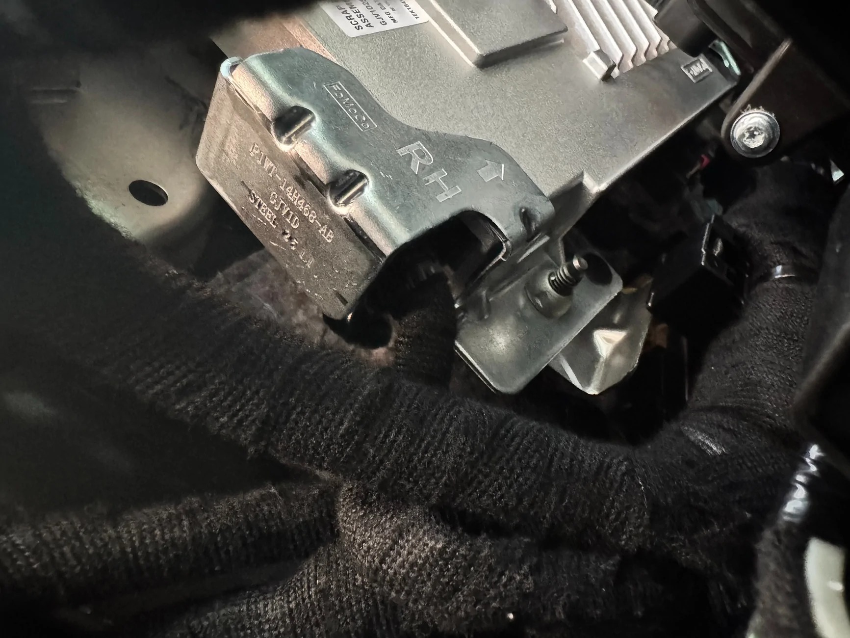

This is the one I got from RA Ranger. Looks very similar to the one from 4D that many of you seem to be familiar with.
Despite it's appearance it's actually quite easy to bend out of the way.
Recommend using pliers at the start to get leverage due to the tight angle.
All installed and working perfectly now!

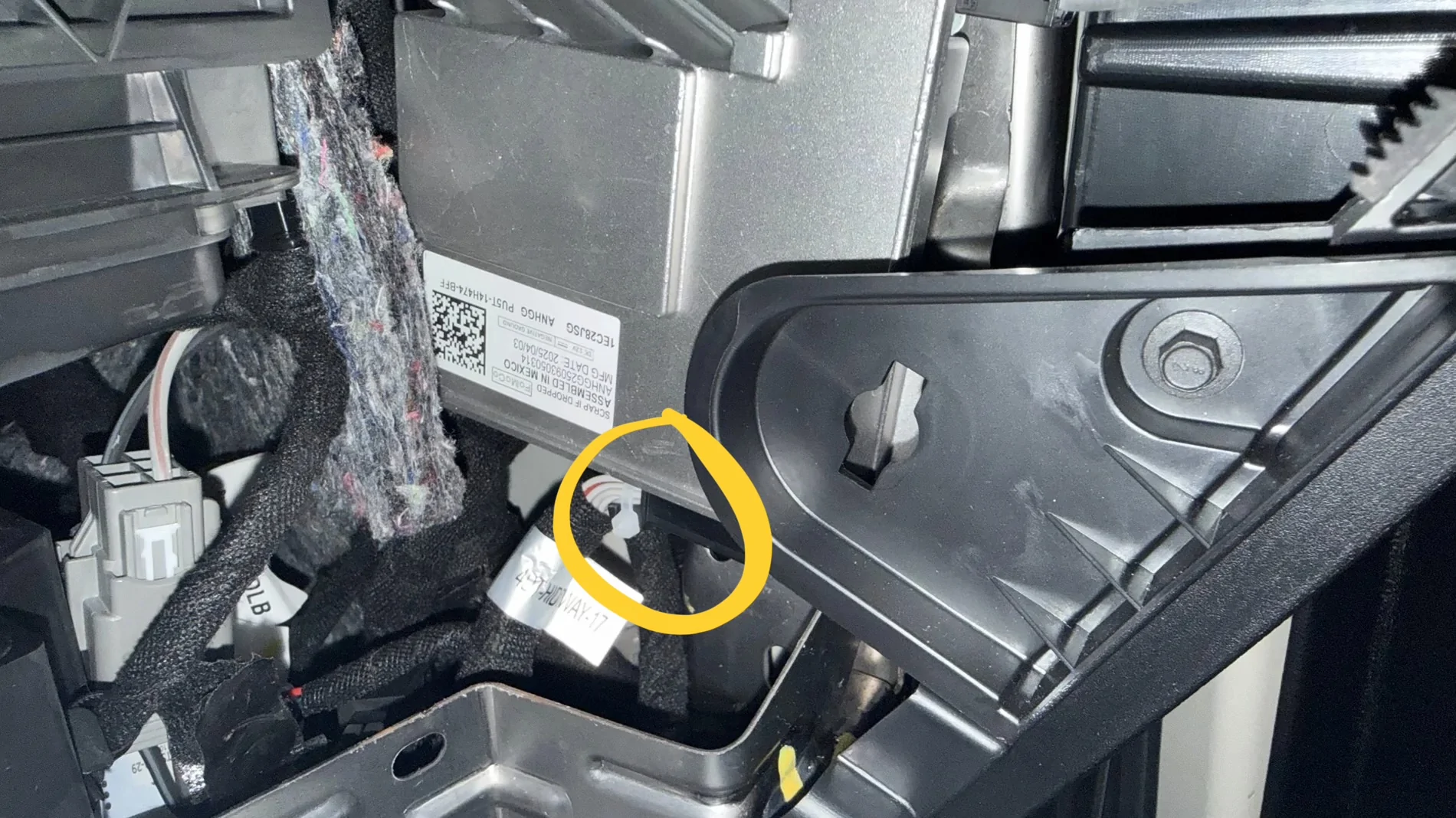

Not a raptor but this is the silver metal box with the 4d gadget plugged in to the spot circled
side of glove compartment.
