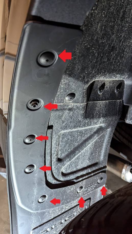

On the rear fender, remove the one torx bolt, I believe it was a T25, remove these pins, they're a pain in the ass. It helps to stick a pick behind the center philips head and pry up slightly while unscrewing them. If you booger them up, don't worry, the guards should have come with plenty to replace them. I hung the guard with a pin in one of the round holes and once all those were in I screwed the torx bolt back in.
Ford Ranger Ford OEM Molded Mud Flaps installation instructions? PXL_20240901_200549899
For the front, remove the pins the same way as the back, except there's not a torx bolt this time, remove the plastic fender corner guard thing, install the splash guard just like the rears.

Ford needs to pay you for these pictures and include them with the splash guards :)
Thanks for the pics! It really helped.

I installed the factory ones today. The instructions and pics @engel762 posted above were great. I had no problems other than one of the new screw thingys wouldn’t tighten, so picked a nice looking one from the removed ones and used it. I don’t know how those little screw thingys can hold them, but they seem secure enough. I did use a 1/4 socket wrench and socket that the torks and screwdriver bits would fit. Made it easier working next to the tire.
