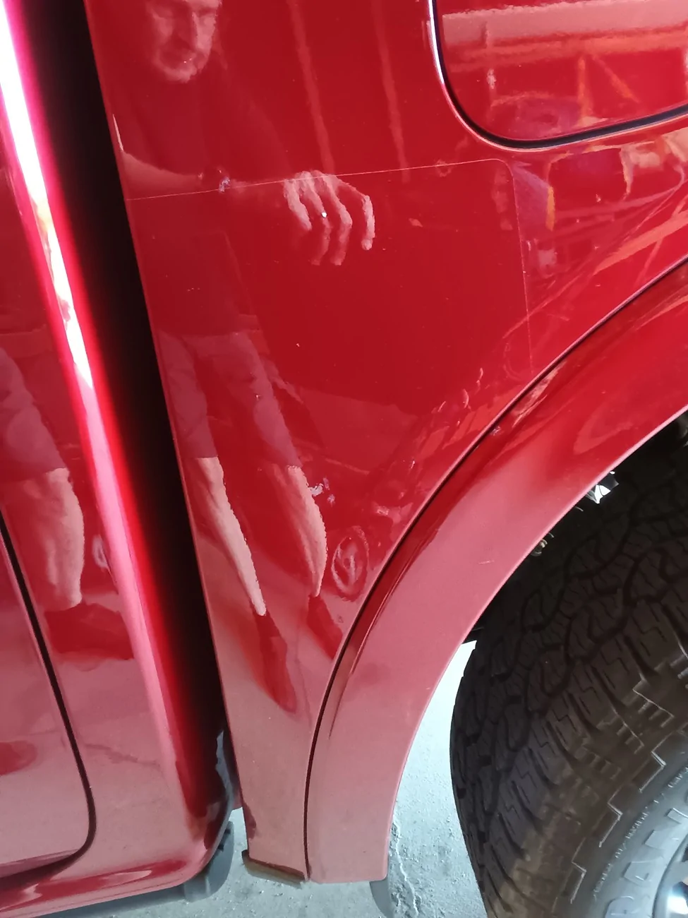

I ordered mud flap on my '26 RR. Will I also need paint protection film if I remove the running boards?
Yes, I would, and I did and didn't use enough after removing my boards on my 2024 model.
Largely why I have kept the boards on my 2025 models.
Ford Ranger Mud Flaps, yay or nay? {filename}
In this pic you can see the paint chips up above where I stopped with the PPF thinking I was plenty safe. LOL

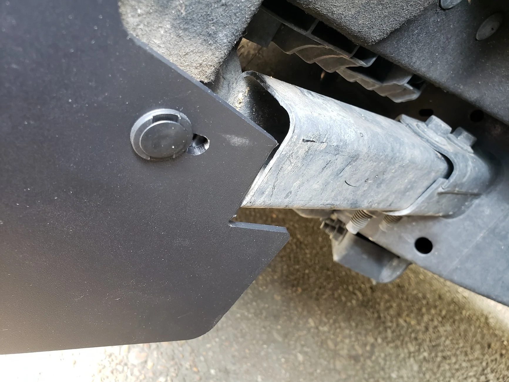

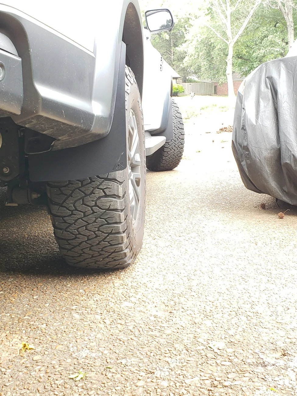

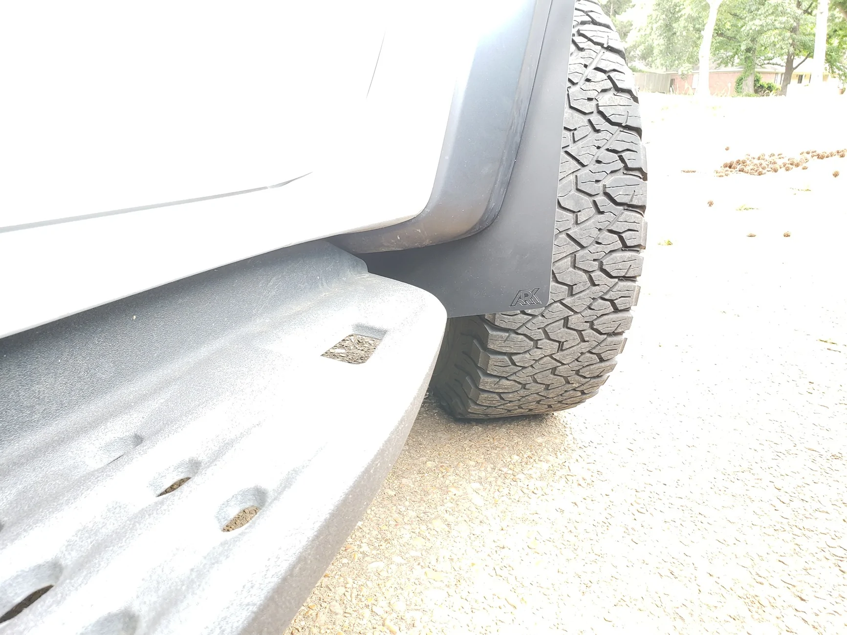

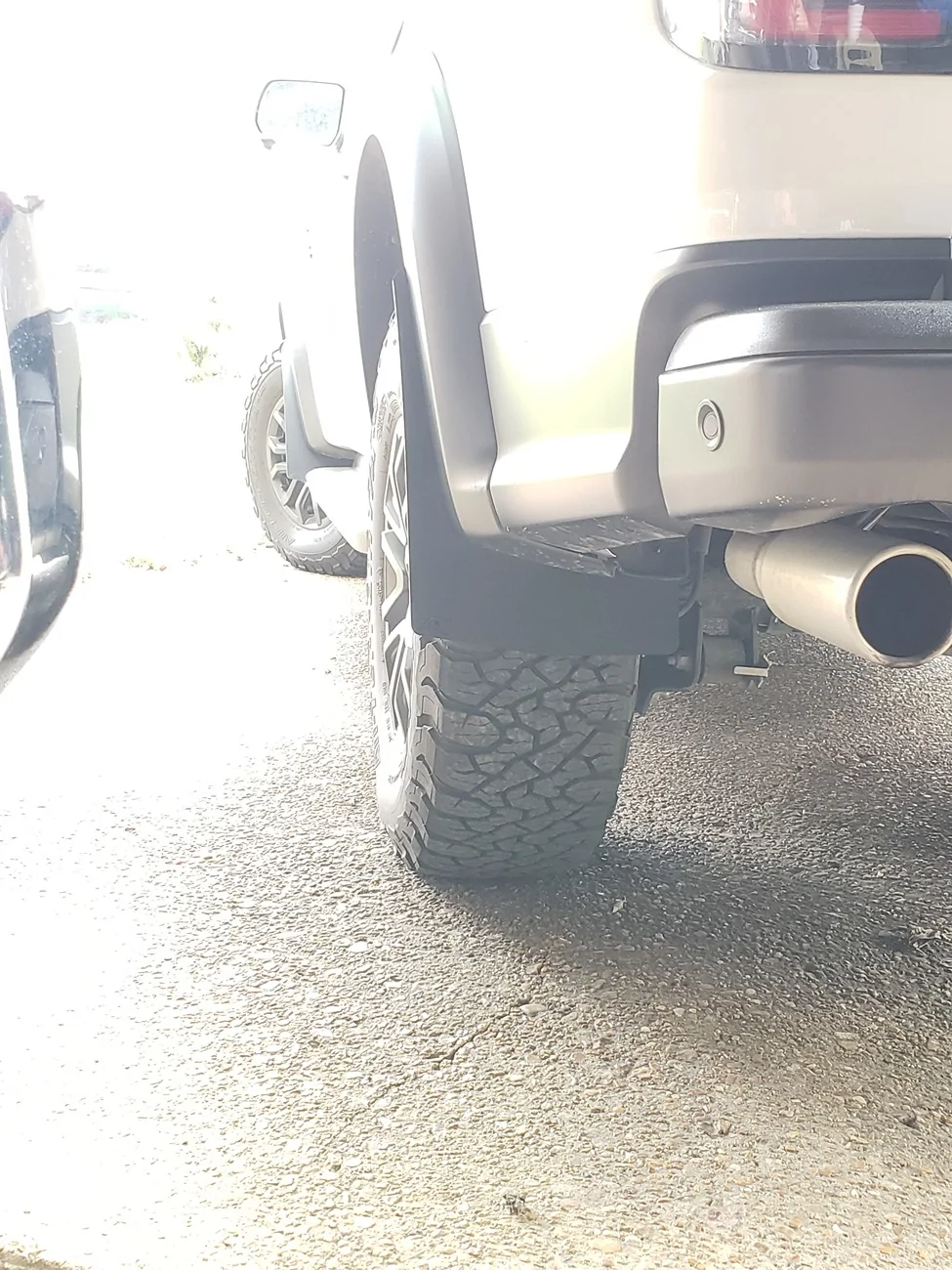

Terrible pictures because of the lighting, but I think i captured the look of the Ark mid guards on the Raptor decently. They look to sit about flush with the bottom of the running boards, and should provide just enough coverage to keep the truck cleaner without being full size guards. I have mine installed as far in as the slots allow, but you could adjust out easily for wider tires and offsets, or trim for a more tucked fit (something I'm considering).
Only negative I have: they have a flap in the front guards that can be slotted into the rear crash guards, but it's a little too wide and offsets the spacing just enough to make them not work as shipped. I just cut those off as I felt it'll only act as a funnel for crap to end up in the crash bars, but if you wanted to use them, you could easily trim 1/8" or so off the bottom of the flaps with a box cutter or rotozip.

Crash bar area. You can kind of see where it's a hair too wide and why I removed it.

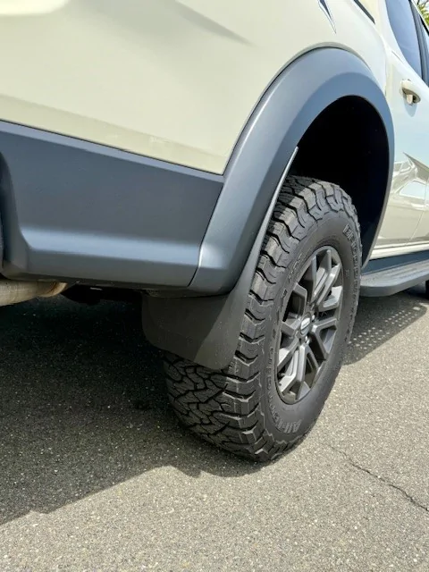

I took a chance on these, ebay mudflaps/fp reps, and they fit perfect. They look just like the factory ford performance ones, have no branding or logos on them and are cheap enough that if you hate them you can rip them back off and toss them out. Took me probably 20 minutes to install in the parking lot while my kid was in martial arts class.
