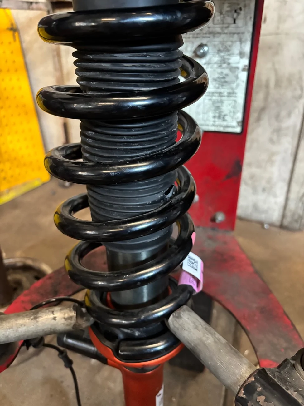

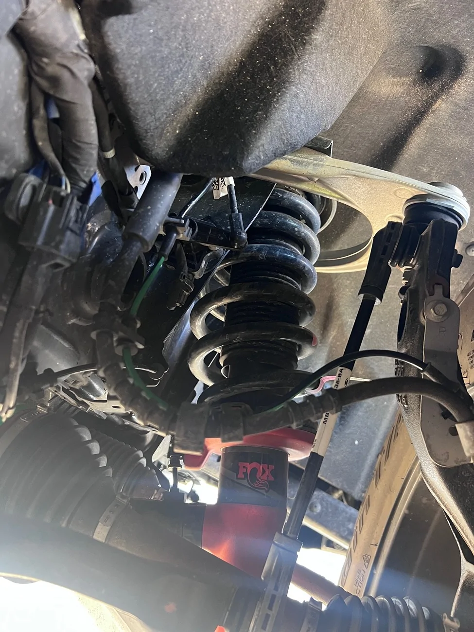

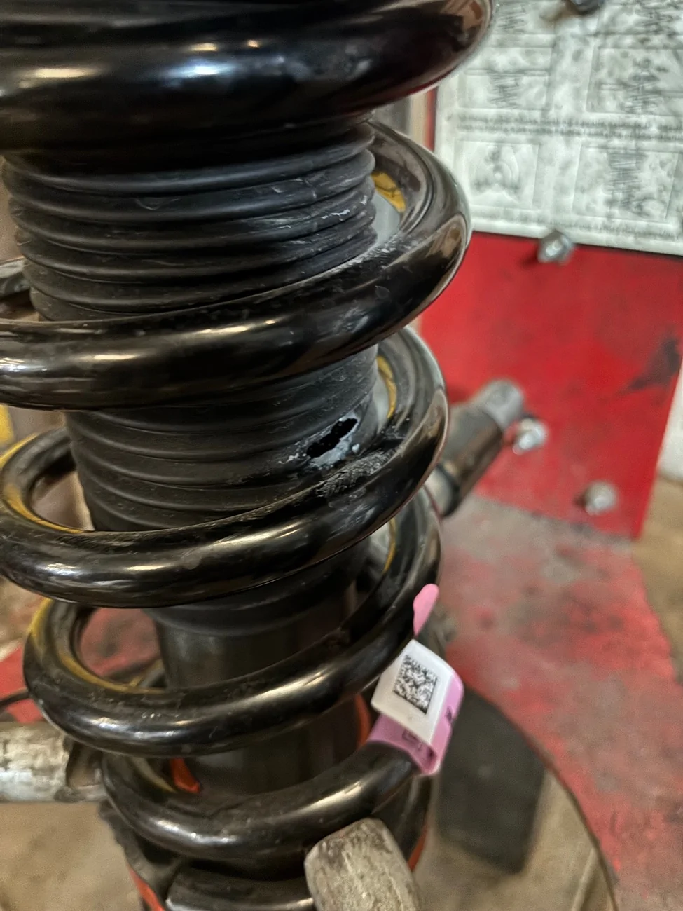

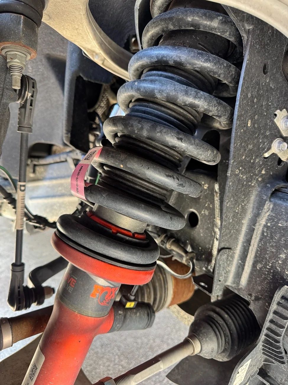

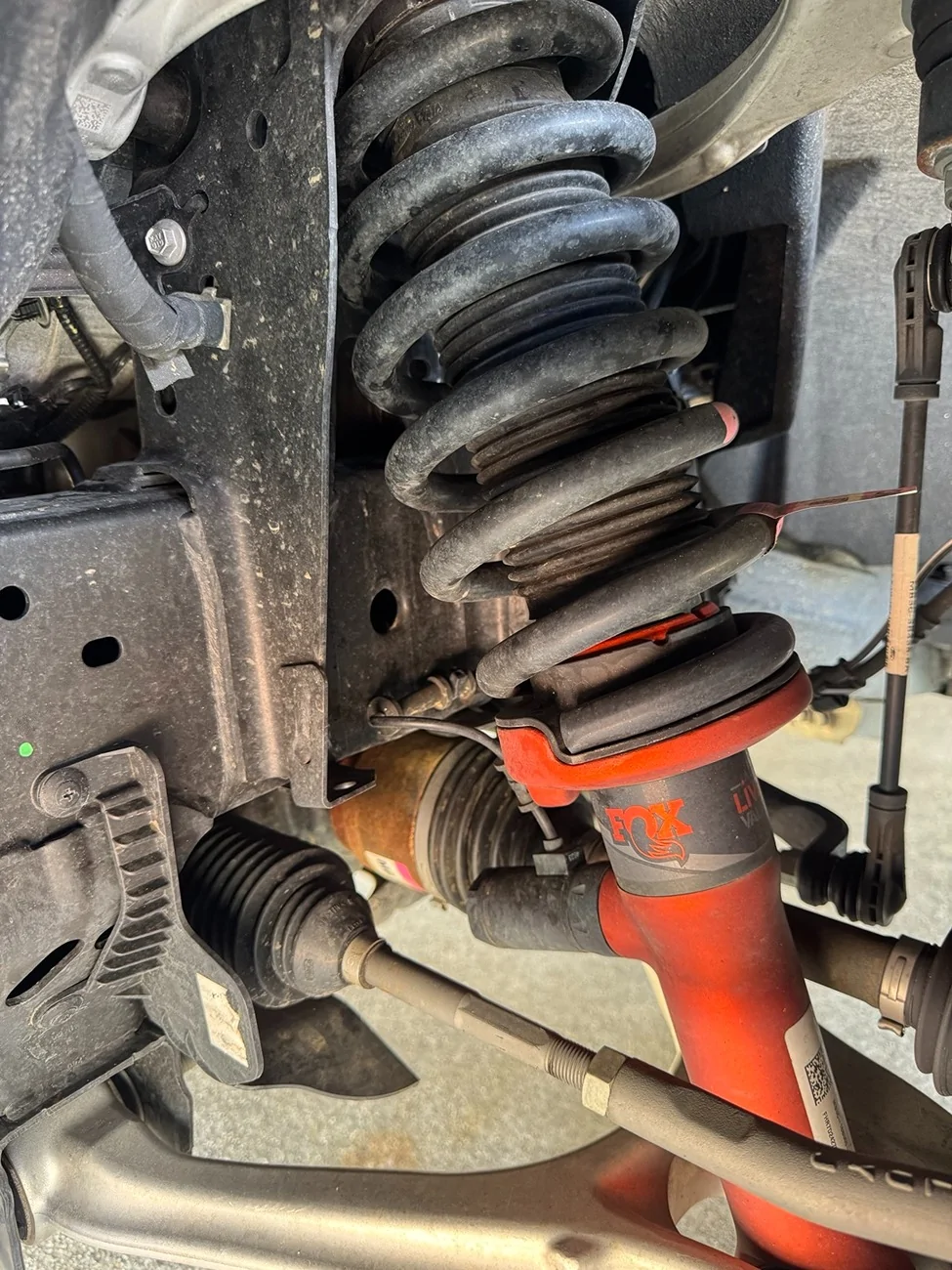

(update): I pulled the front shocks/coilovers to install spacer lift and noted that the springs still had slight bowing without any vehicle load (ie shocks fully extended length but still compressed within shock body). But at least i didnt see any rubbing marks on the shock shaft covers.

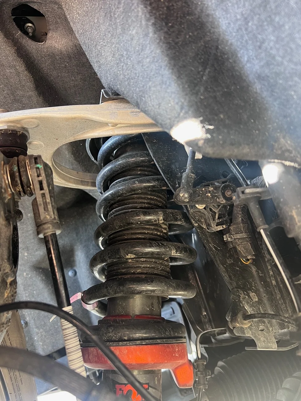

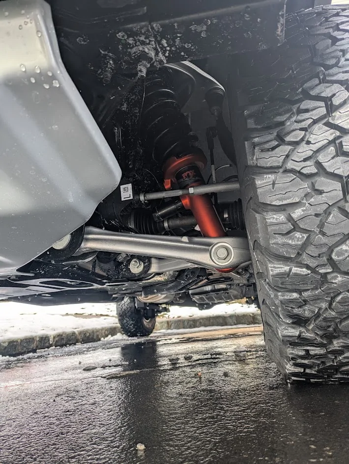

Mine have been bow legged since day 1. ALL of them are. I've yet to see any that are not and it's normal for this shock design. Not sure why they designed it that way, could be cost or packaging limitations (maybe to add clearance to the UCA?).
