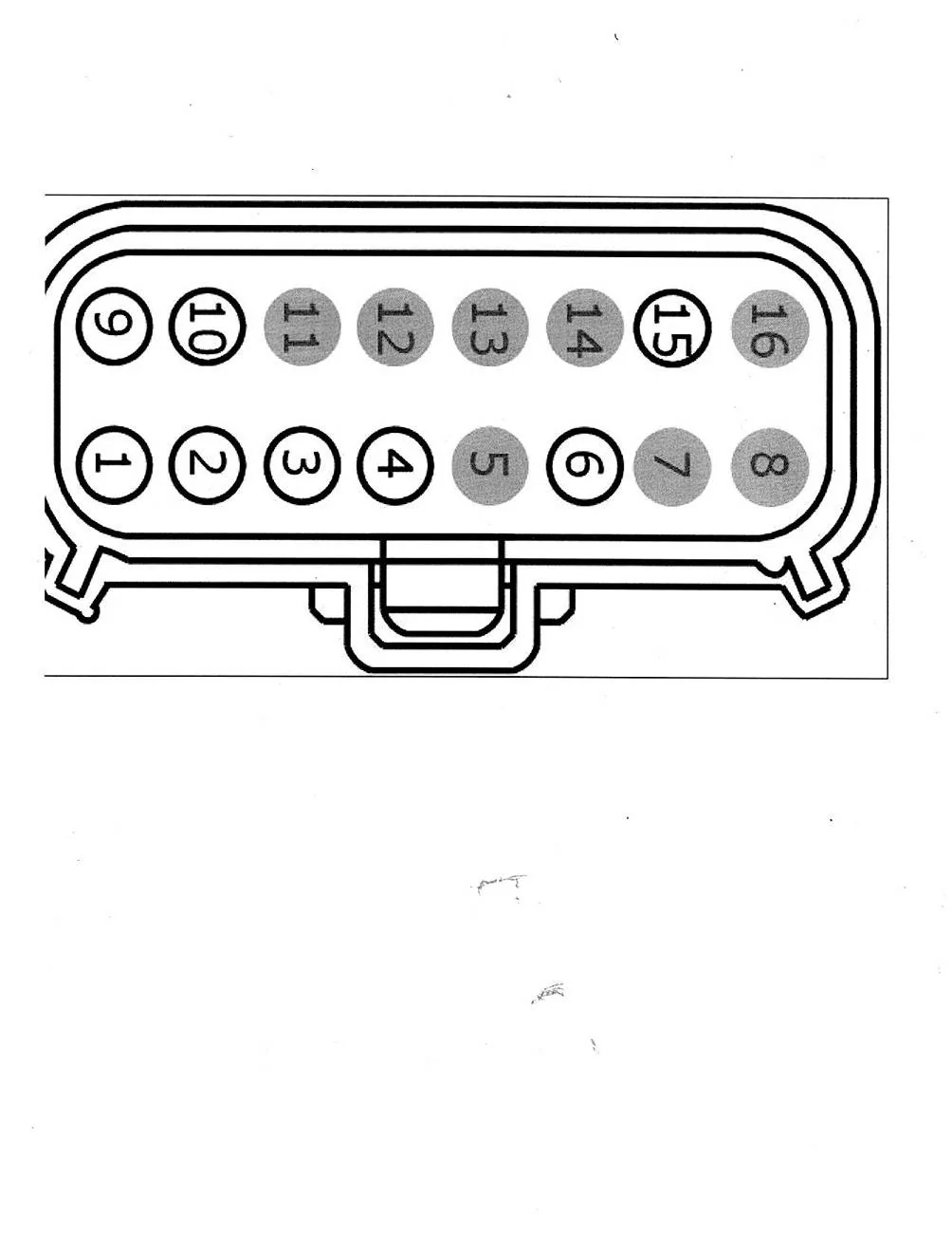

I already got put a spade connector on the negative and grounded it to the chassis. I’m just trying to figure out how to get the power connected to the headlights lol
Ok, if you already grounded it, easiest way would just be to splice into the power wire for the low beams. Should be Pin number one for either the base LED lights or the Higher trim LEDs going by the wiring diagram I am looking at. This is the headlamp connector itself. Pin number one shows it is the low beam power
Ford Ranger Honestly, I'm not even mad. connector
Or you could install it how it's supposed to be installed and tap it into the low amperage accessory fuse as intended. There is no easy answer to your question because it isn't how they are supposed to be installed.
When you start talking about wire stripping, splicing and pins -- you've gone too far off the reservation. Just micro 2 tap it into the 139 and enjoy a clean install

My thing is I don’t want them on 24/7. I just want them at night when head lights come on
