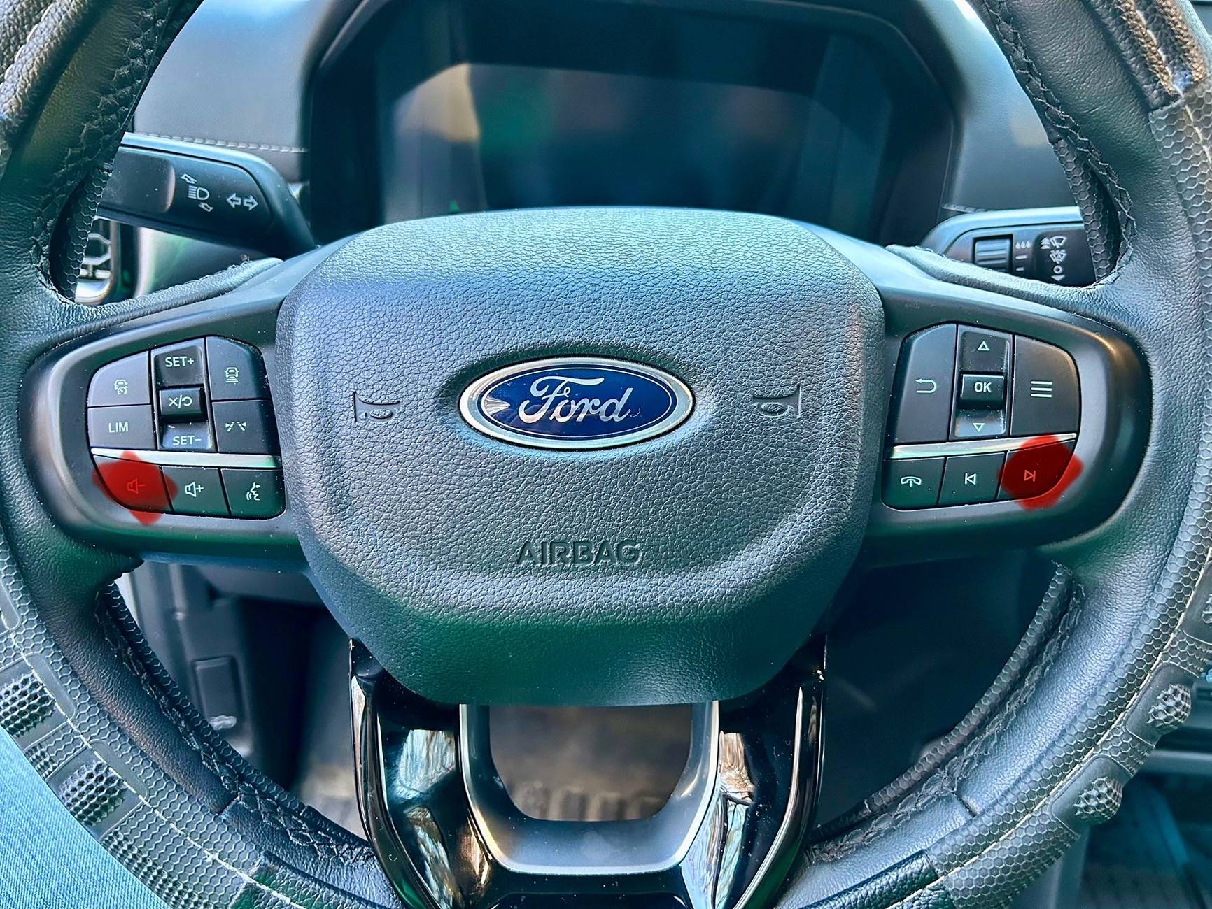

Is there a sequence to reboot the infotainment system when it freezes while driving the vehicle? The whole system froze while using CarPlay… I searched and could not find any info online.

yes volume down and forward track hold together for a few seconds or so

Press and hold the two buttons highlighted in red
Ford Ranger Infotainment system reboot procedure? IMG_1850
