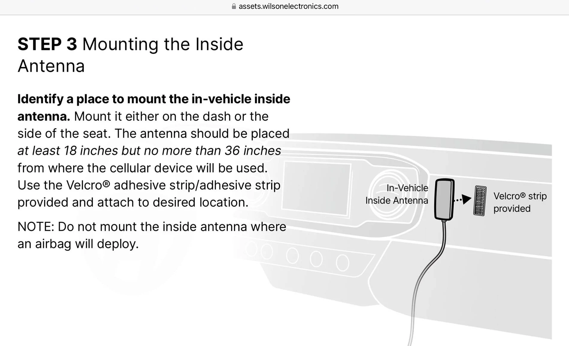

I want to add a weBoost Drive Reach Overland cell booster to my RR, mounting the antenna on my truck cap is straightforward and easy. Where would be a good place to mount the inside antenna? It must be “at least 18” but no more than 36”” from the phone(s). That is pretty limiting, considering the lack of free dash space above the center display stack on my Raptor.

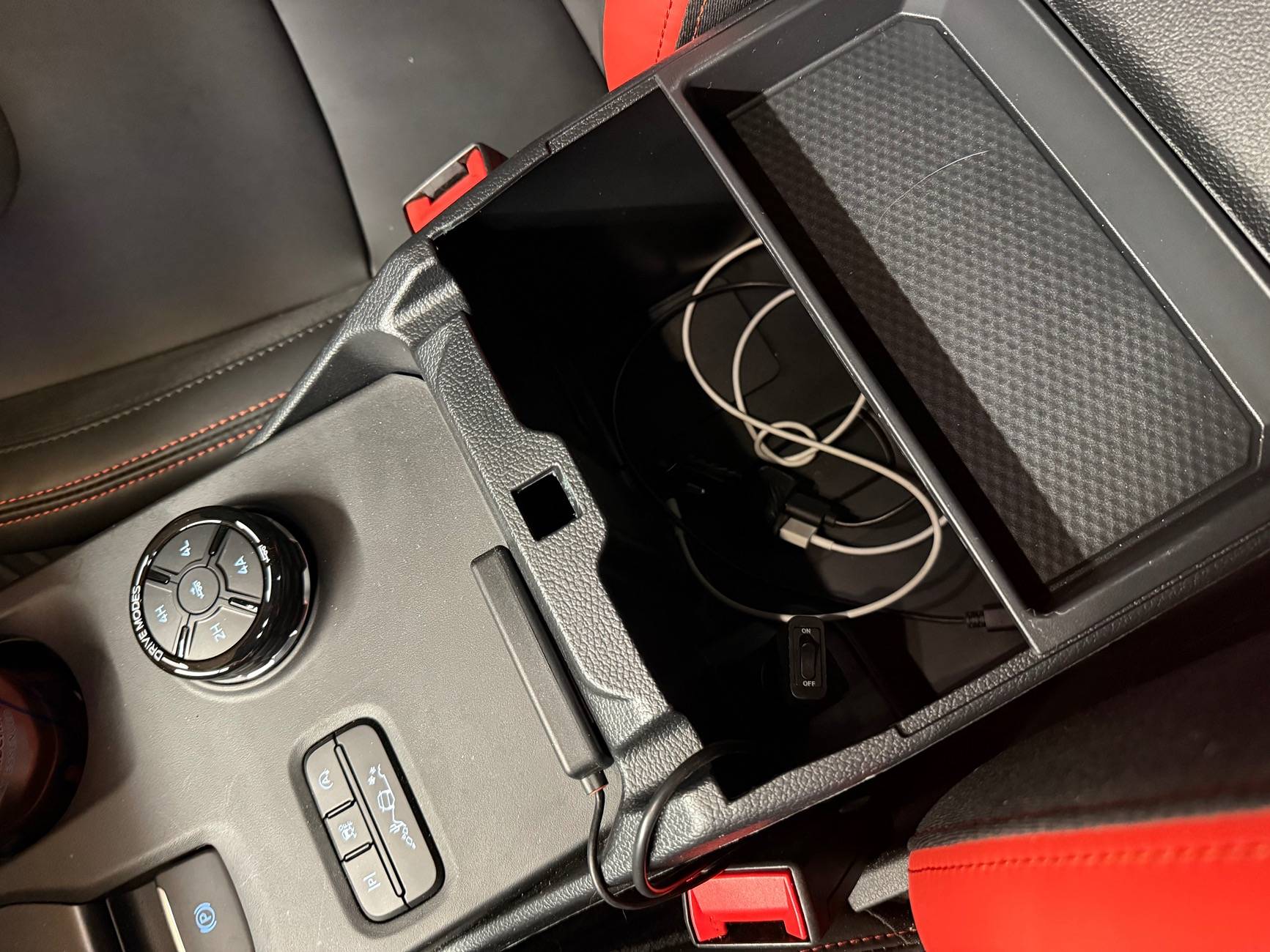

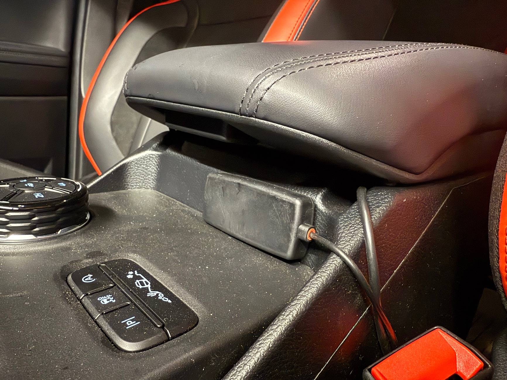

I mounted the inside antenna on the center console under the lid latch. Works very well for phone in a cup holder or on charger. I'll post pictures shortly.
edit: pictures
Power switch is in the center console 12v for easy on/off. Bulletproof Diesel dual antenna mount for WeBoost and GMRS.
Wow, I am not sure I would ever have located that position for the antenna! It looks pretty close to perfect. Have you tested data speeds (down and up) with it hard against your phone? I guess if there was a big difference, having Velcro attachment and extra cable length would allow me to plop it underneath my phone, if absolutely needed. Or just rest my phone up against the antenna as it sits there..

The location has worked great, especially having the power switch right there.
I have not tested it that close to the phone, nor have I speed tested. I can try that on a drive this afternoon. Anecdotally, it seems like the sweet spot for me has been 12-24".

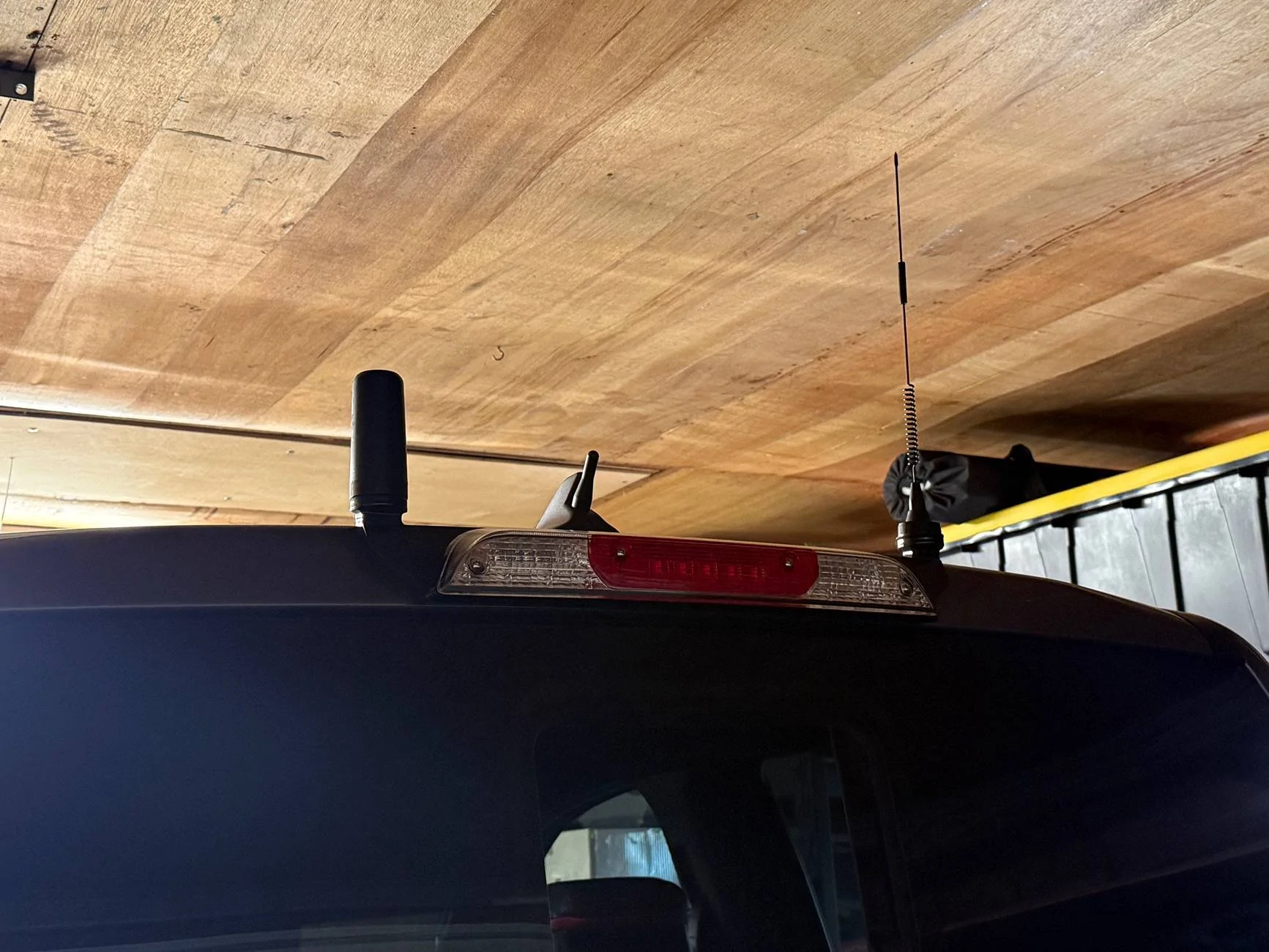

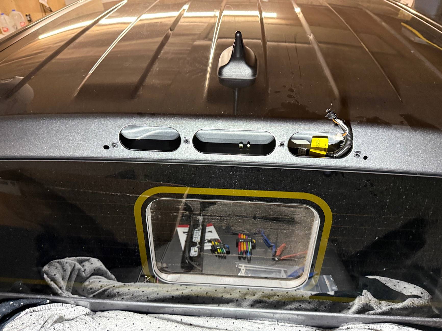

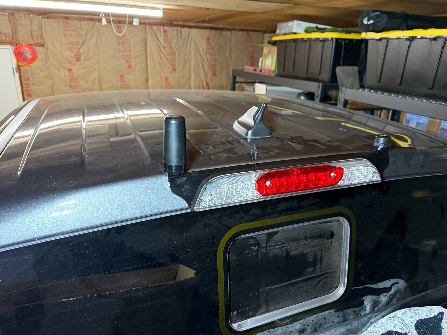

The antenna cables are routed through the brake light opening, under the headliner and down. The Bulletproof mount gets sandwiched between the cab and the OEM brake light. I'll see if I have install pictures. Pictures below. I followed a couple install videos from the F-150 crowd. Easier install on the Ranger, in my opinion.
Third Brake Light DUAL Antenna Mount - 2019-2025 Ford Ranger
