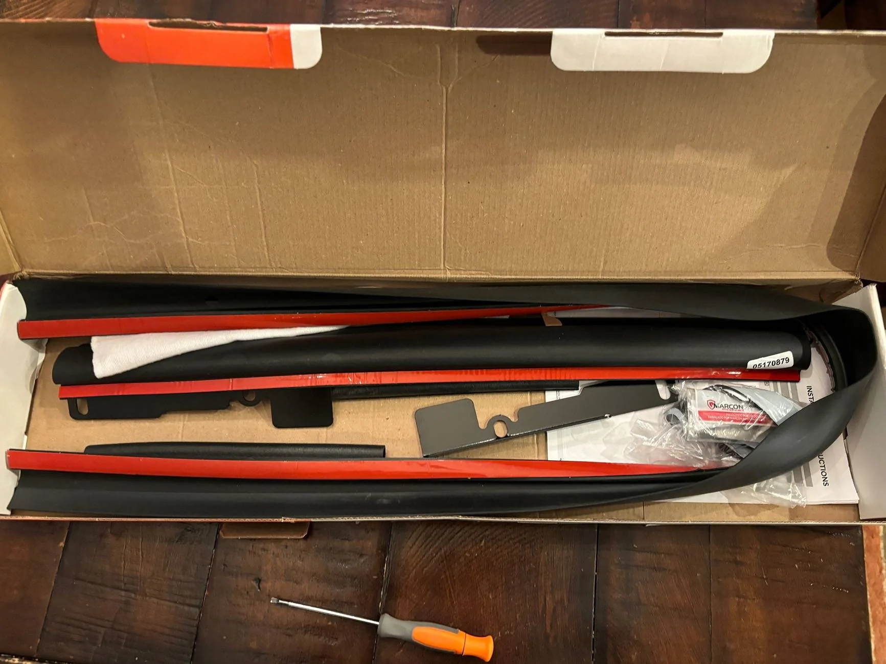

I installed this kit last Friday after work on my 24' Lariat. There is a seal supposed to go on the tail gate, I glue mine to the end of the box as I have a spray in liner and that's were a bare painted edge was available. It took a bit to figure it all out, but once installing it all made sense. I have a retractable cover and it now seals up the box nicely. Drove through pouring rain on the highway and had a slight bit of water in the back lower corners of the box, but nothing else. I'll be adding a little foam tape to seal those up, then be trying it out on gravel. I want it sealed up so that it doesnt fill with dust on Gravel roads.

I installed mine today and followed the instructions. It did fit well even with the EGR Rolltrac bed cover that has seals of it’s own in the back. I followed the instructions but the side rubbers lifted after a few hours. I will reach out to Keko, maybe I didn’t use enough primer or it needs an additional glue? I also have the ESI kit and may mount parts of it for additional protection as that kit mounts in a different area on the sides.

I installed the kit today and it took less than an hour. No interference with the tailgate dampener. The side seals will need a few warm days to form to the tailgate. Much better than the one size fits all type and well worth the few extra dollars.
