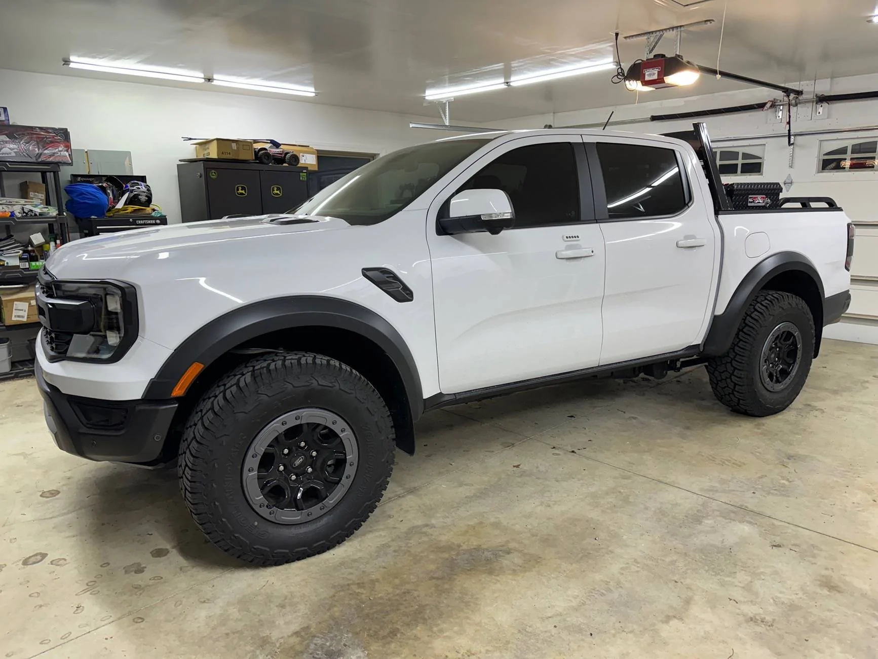

I am running a 34" tire on Bronco SAS rims. I do get a slight front crash bar rub on hard right turns, especially when in reveres is the most noticeable. I have been meaning to remove my crash bars just have not got around to it. Same sort of scenario with the Bronco's that Ford puts the SAS 35"-wheel tire combos on, only Ford removes or never installs the crash bars on SAS spec broncos.
I am thinking if I wanted to get rid of the rub and stick with my SAS wheels, I could do so by putting the stock 33" tires back on, or put the 34" tires on the stock OE offset rims.
More details and pics of my setup can be seen here.
My current setup.

Yes, they did rub the crash bars.
Mainly when cranked and backing up.
They were a good tire for all terrain including some mud, rain, rock, snow etc.
I changed them out to the Falken AT4W in the stock 285 size.
Which the Falken 285 is almost the same width as the 295s were only a slight bit shorter.
That solved the Rub and since the Falken tire I went to was P285 not a LT E, load 10 ply it is much lighter weight, and my fuel mileage came back up quite a bit.
From 13 mpg to now 15 mpg on average same mixed driving as before.
The 285 in the Falken is significantly wider than the 285 in the OE BFG.
Always best practice to study the mfg specs. For whatever reason I see this all the time,
where the width measurment in the tire size like 285 is noticably different from one tire brand and model to the next. The Falken AT3W the prior version is not much wider then the BFG, only the newer At4W had the width I was after.
