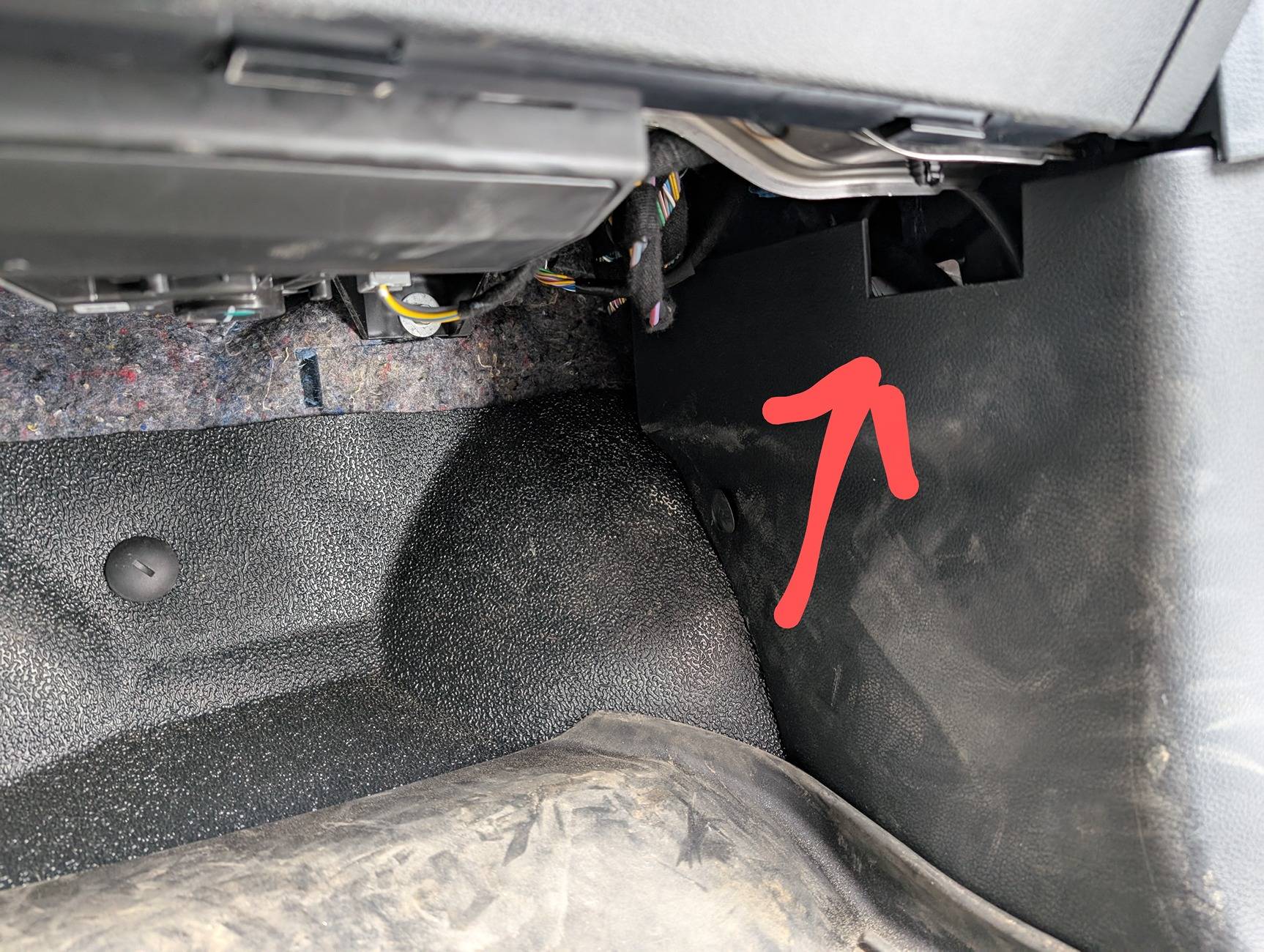

Hello is there a list with all the prewired stuff inside the cab?
for example the camera wires for a trailer camera on the passengerside or the high beam and switched 12v wires on the driver side?
i only find stuff for the aux switches but nothing for the inside only a radom tiktok or youtube video about these

It works without a trailer attached
on mine its prewired under the glovebox near the door
On the wires a labels camera +/- and power/ground
Ford Ranger Location of wire for trailer camera, switched 12v and more 1000023808
