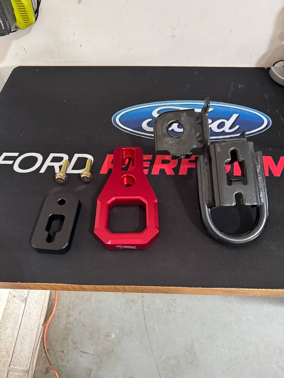

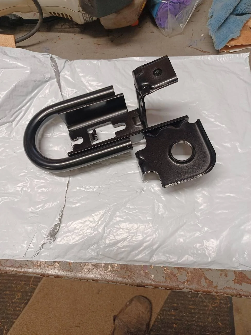

I’m looking for replacement front tow hooks for 24-25 Ranger Raptor. I’m not finding anything that seems to be compatable. I’m specifically looking for something that is this style:

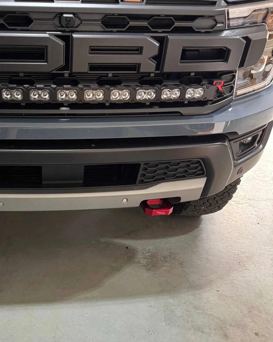

The stock tow hooks have brackets on the inboard side to support the intercooler. It looks like that kit from Rival4x4 comes with brackets that addresses that issue.
Yeah, that’s my issue with compatibility. I may have to Frankenstein something together and chop up the original bracket to get what I’m looking for.

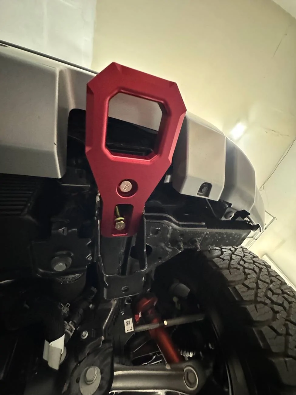

I’m actually looking at these. I’ll have to get some measurements though to see if the bolt spacing is the same as an F150. If it fits I could probably cut off the bracket for the intercooler from the OEM mount and weld it on to the new one. It is aluminum though. Probably would need to have the spacer fabricated out of steel. I can weld steel to steel all day long.

Those would certainly be rad. Is the mounting location strong enough to get the benefit out of them, though?
It looks like the Rival offering might be reinforcing it's mounting location. I'd have to look under the truck to see what's supposed to go where. I've only had it for a couple of weeks, so I haven't fully explored it's undercarriage.
I did question the utility of the factory recovery points just from looking at them but, seeing how they mount in this thread, I want to replace them. ?

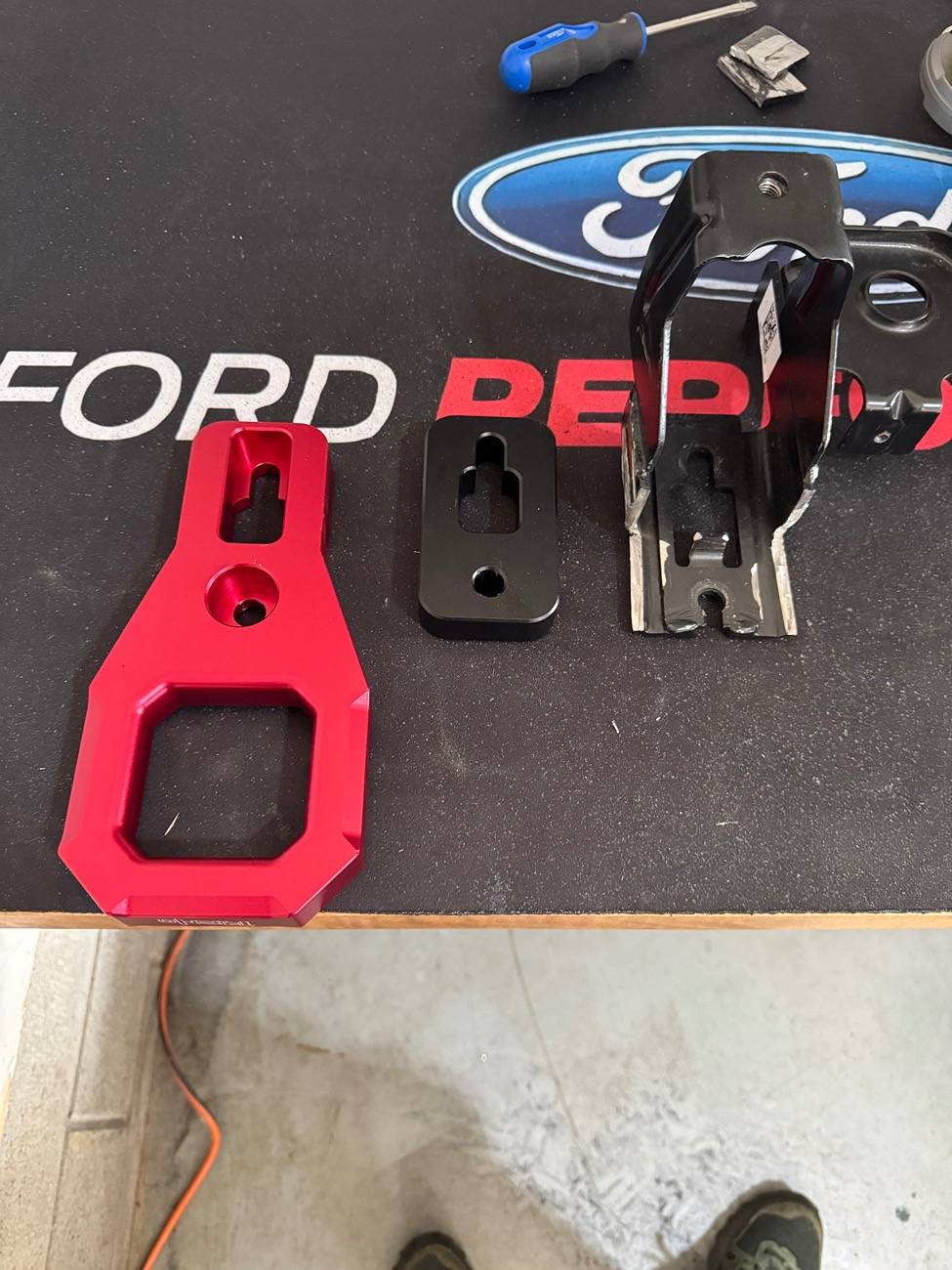

I installed an intercooler from CVF today and while I had the tow hooks off I looked into if I could install the F150 tow hooks from Reno I purchased.
Ford Ranger Looking for replacement tow hooks IMG_9908
They don’t fit, but the mounting holes are spot on. I decided to do some modification. I cut the tow hooks off at the welds to remove them from the bracket. The spacer fit in the bracket fine, but the taper on the red hook part wouldn’t allow it to slide far enough back to line up. Made another modification and everything lined up perfect.
Ford Ranger Looking for replacement tow hooks IMG_9909
I modified and installed 1 at a time so my new intercooler stayed in place. Torqued the bolts to 100 ft lbs, don’t know what it should be but I figured that would be fine.
Ford Ranger Looking for replacement tow hooks IMG_9912
I think it turned out really good. It was getting late and it was in the garage without much space so couldn’t get a good full on view of both of them. I’ll post another picture in the daylight. I will have to take them back off this weekend so I can paint the bare metal spots on the bracket black for rust prevention. As far as strength, the bolts screw into the frame and it’s solid. The cutting of the bracket has zero downside. The bracket is just a layer sandwiched in between, doesn’t have any impact on the tow hooks. Just supports the intercooler and front 2 bolts for the skid plate. The support for those wasn’t compromised. With the stock hooks you’re relying on 2 welds to the bracket. This setup is way more robust now.
