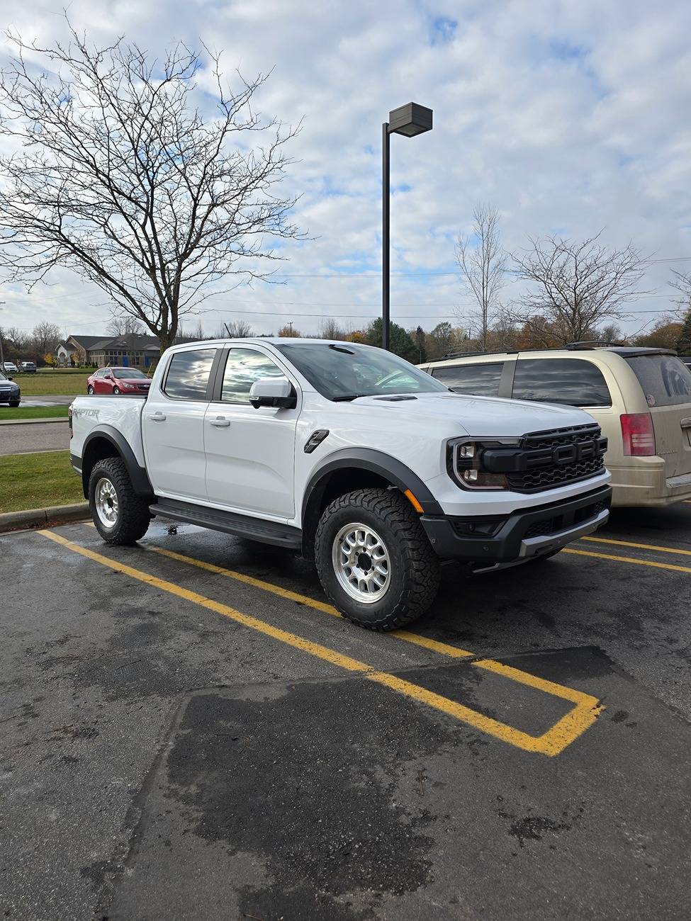

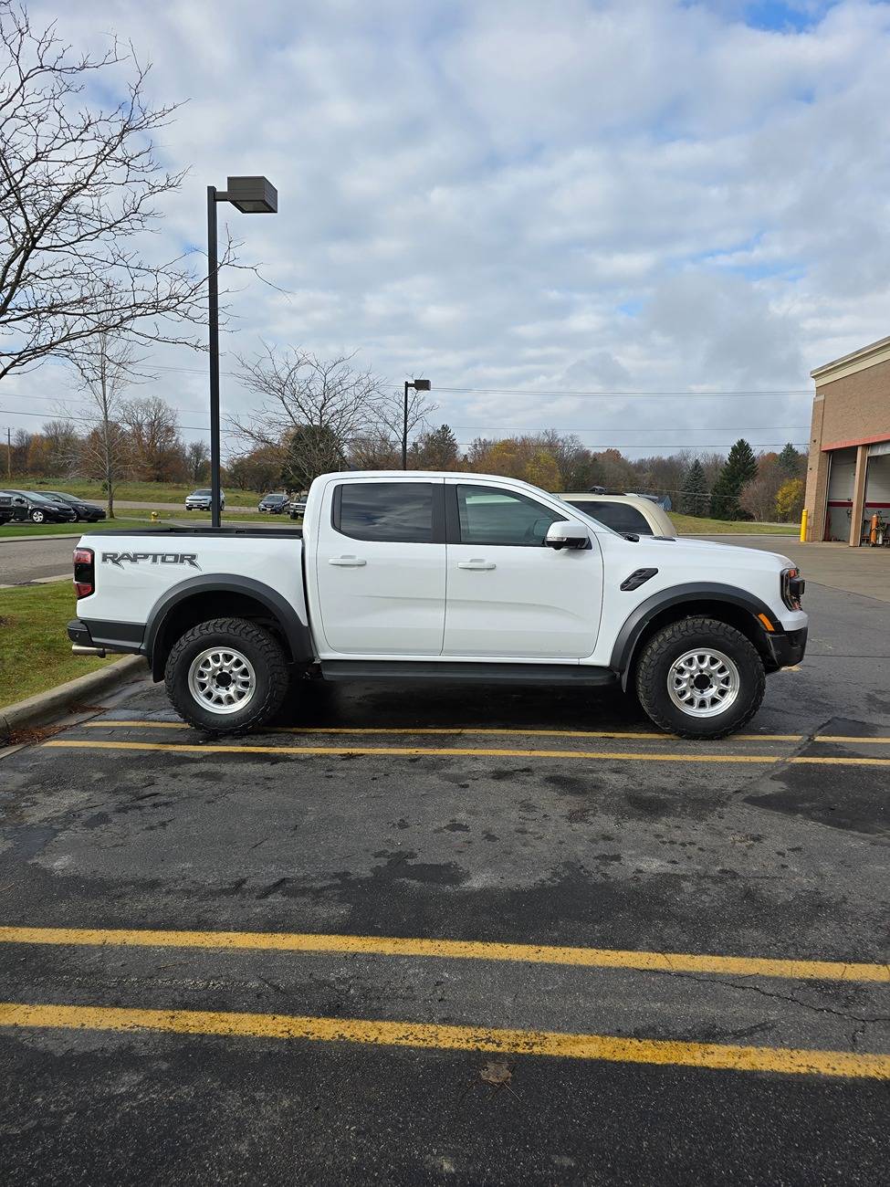

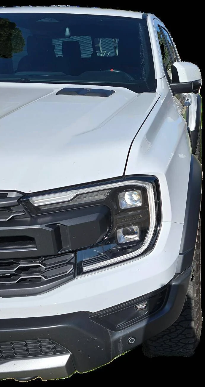

Offset measurements should be same between brands. Width is a factor as someone else said when it comes to poke, and tire width as well.
I have RTR 18x9 +30 with a 12.5 wide tire and it pokes modestly beyond the wheel arch molding. A 0 offset will poke another 1.2" more. 20mm would be roughly 1/2" more.
18x9 +30 with 12.5 wide tire:
Ford Ranger Manufacturers and offset IMG_0257
For the 17x8.5s it is a narrower wheel so a +25mm is going to be pretty flush if you use OE tire size 285/70R17. Wider tire means a bit of poke. (I ran the stock wheels that are +55 with a 30mm spacer so effective offset was +25mm).
17x8.5 effective +25 with 285 wide:
Ford Ranger Manufacturers and offset IMG_2450
