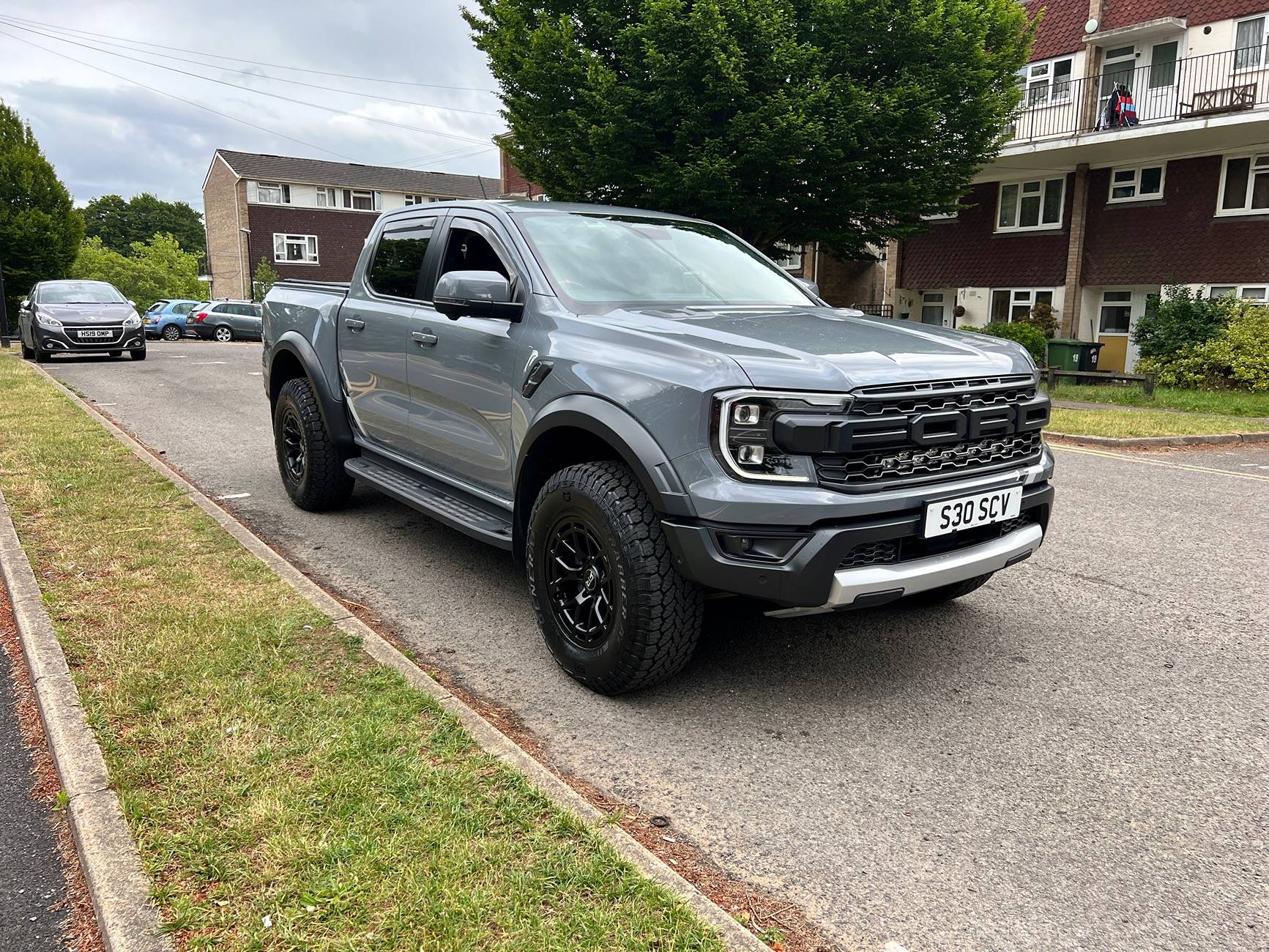

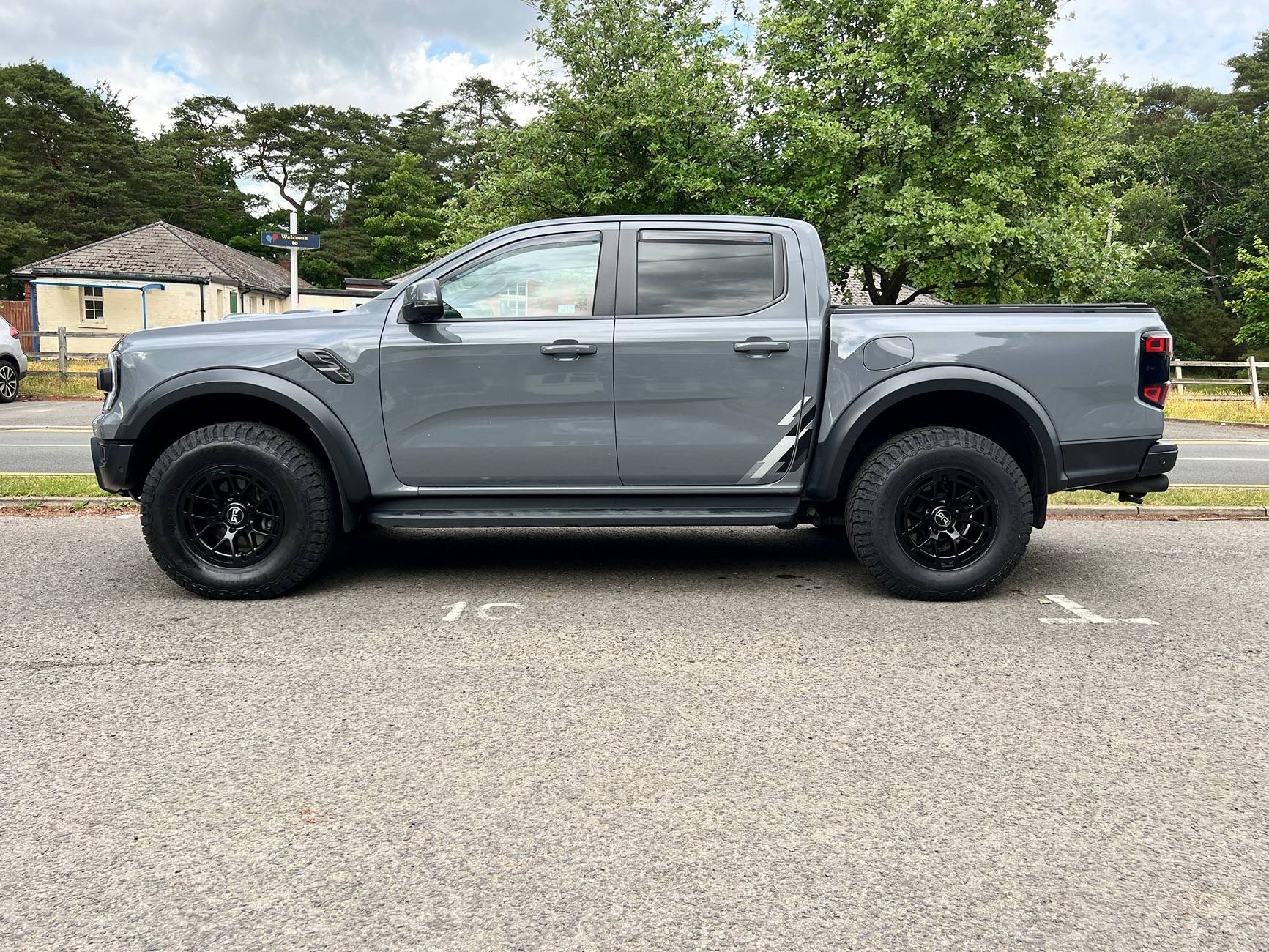

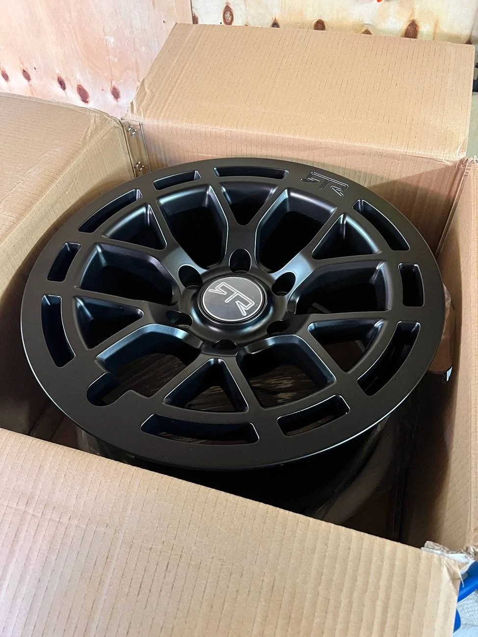

Hi all, my RTR Tech 6 17x9 Wheels have arrived. Have ordered some General Grabbers 285 70 R17 to wrap them in.
However, just though I’d seek some advice in that the stock wheels are 8.5 not 9’, assuming I shouldn’t have any issues with this tyre size?
Thanks in advance

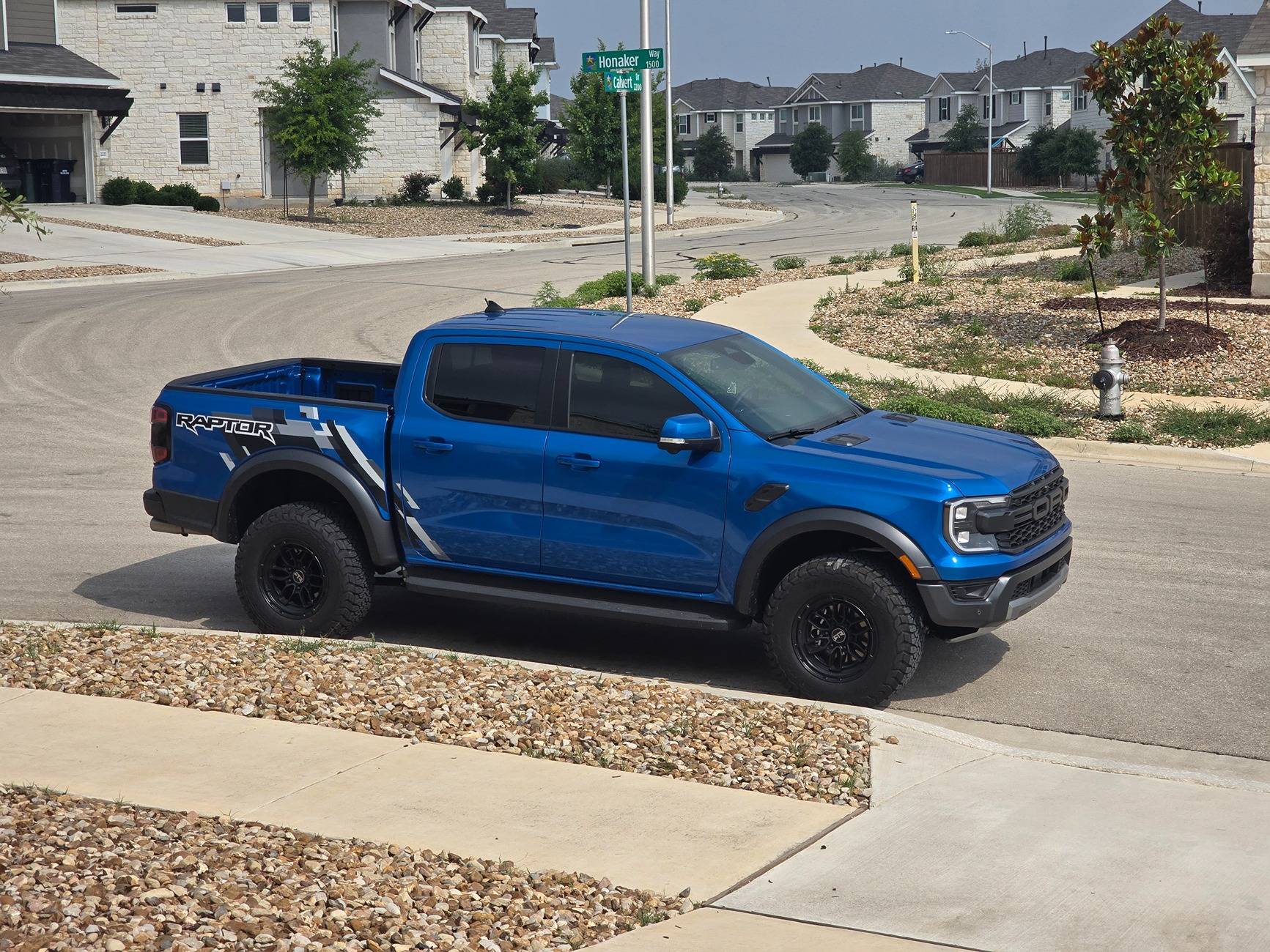

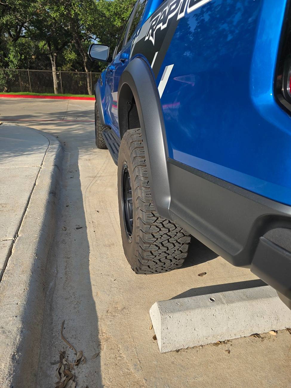

Yes, the 17x9 will be fine on stock tire size. I run the RTR EVO 6 17x9 30mm. Basically these offer the same stance of 17x8.5 25mm in terms of "poke" if you factor in that extra half inch of wheel, so 30mm+the extra 1/4th inch of wheel on the outside.
Ford Ranger RTR Tech 6 17x9 +30 Offset 20250517_102322
Ford Ranger RTR Tech 6 17x9 +30 Offset 20250517_102315
Ford Ranger RTR Tech 6 17x9 +30 Offset 20250524_182607
Ford Ranger RTR Tech 6 17x9 +30 Offset 20250524_182551
Thanks mate, bang on the info I was after!

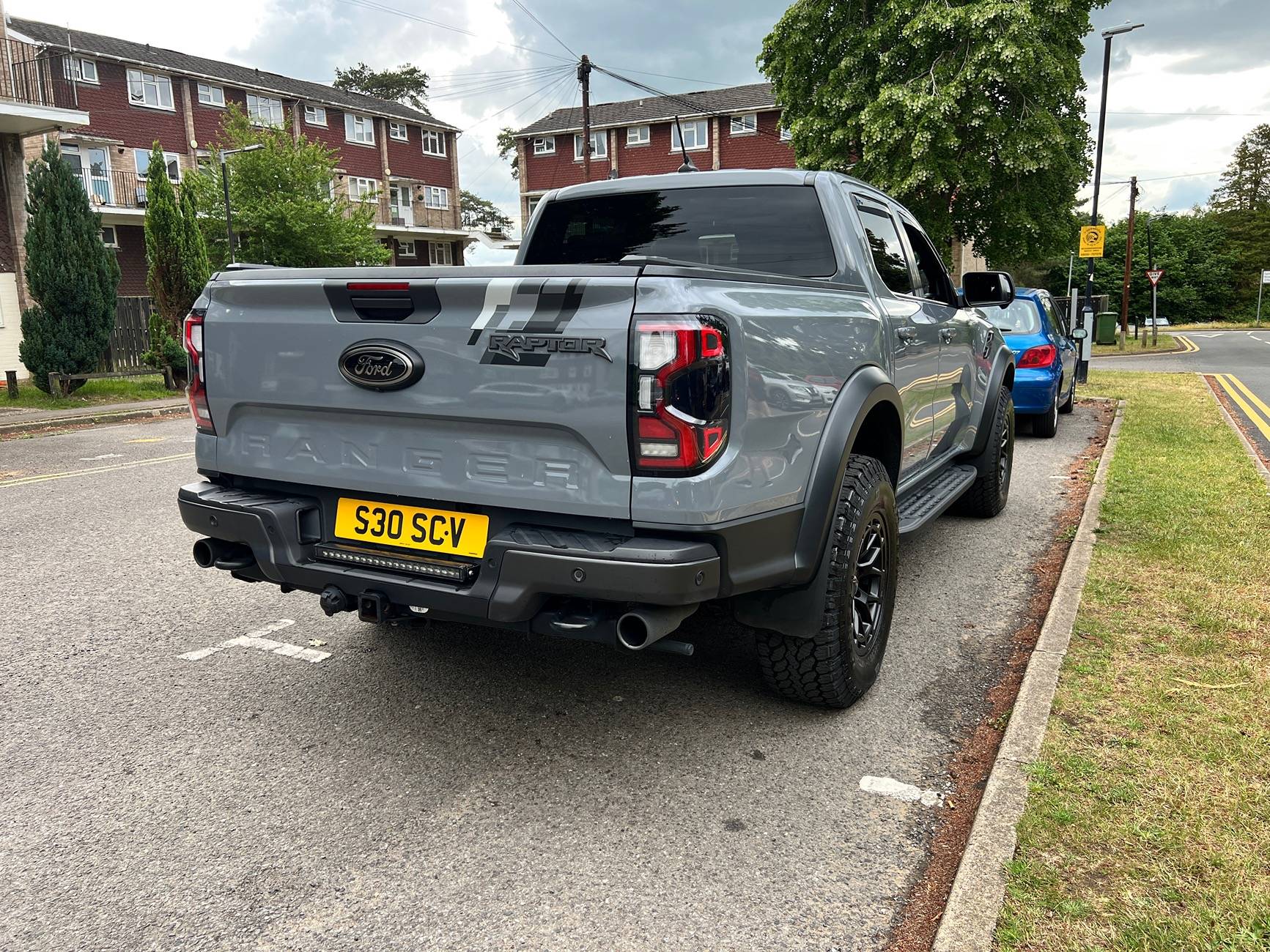

Got them fitted, some difference to the way it drives. Much smoother, lighter feeling
Like the rear light bar location. Here it wouldn't be allowed as it would block the plate.

You can close this gap on that trim piece by giving it a nice pound and it'll seat properly. Mine came like that from delivery and I just smacked it and it was flush.

That bits my fault, tried lifting them up to help waterproof the bed - ended up permanently bending it. Need some new caps so I can finally get it more watertight. These new rangers are shite for that, my old shape ones were always much better.
