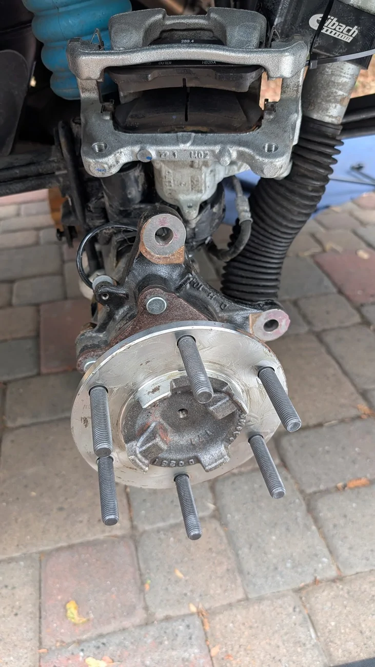

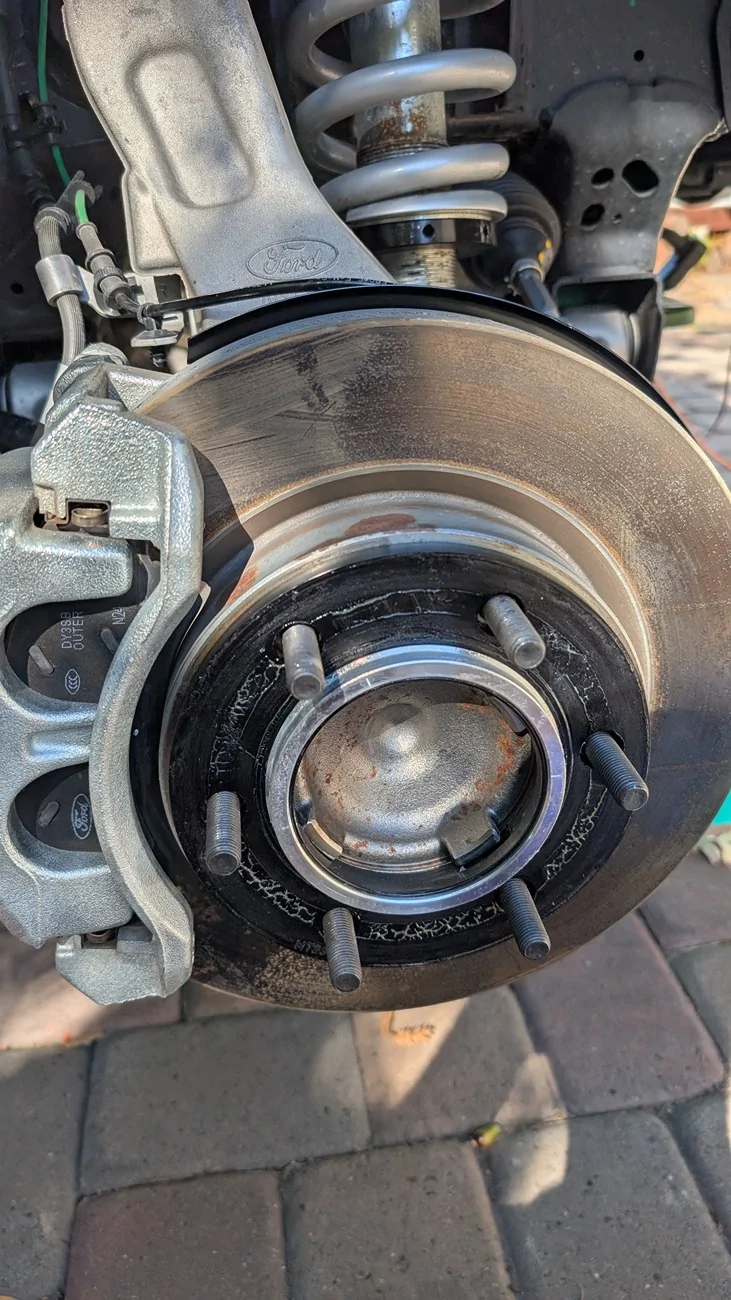

After looking at stud options I could get 25 ARP studs for $175 or 30 Moser 8255 studs for $79, I wanted the ARP but the cost was a bit high so just went with Moser. Interesting note is stock fronts/back measure same overall 52mm length with ~4.2mm thick heads, Mosers have ~3.2mm heads(not highly accurate calipers used). ARP told me they have 5mm thick heads. OEM stock and Moser have exact same knurl/spline width as I can measure but maybe Moser seems just a hair wider at splines because they are new. Everything went together very well but based on the labor to do all corners it maybe the ARP are worth the additional $96? Hard to say but the Moser seem quality out of the box
