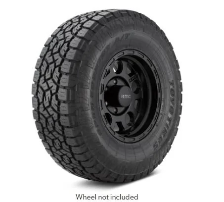

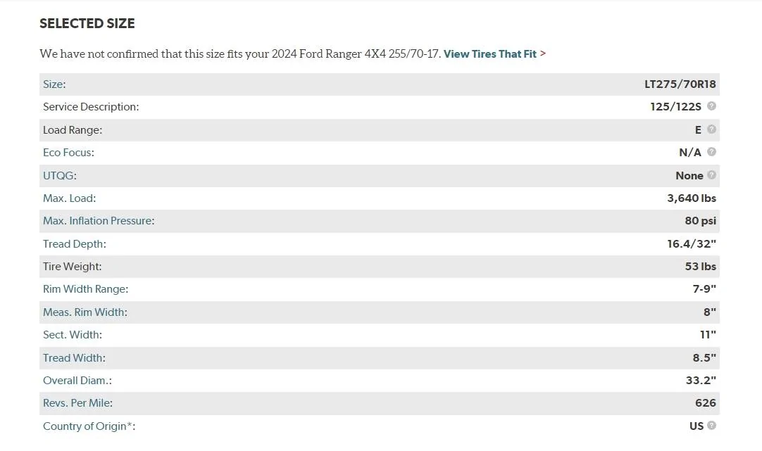

The next size up Toyo its still light and narrow'ish but not sure it will fit at 33.2" Its crazy light for an E load rated tire of this size, at 53 lbs. Its pretty spendy though.
Ford Ranger My overlanding end goal for my FX4 Toyo Open Country 275s
Ford Ranger My overlanding end goal for my FX4 Toyo Open Country 275's 2

for my lariat, i’m thinking +35 or higher. still mulling over 17 or 18 and to level or not.
I think +35 is a safer bet than +40mm, I'm pretty nervous about fitment. We know a 285/70R17 K03 fits on a +35 and that's 11.5" section width. So on +40mm I'm pretty confident 32.8X10.7 and under will fit but not sure about anything bigger. 18" wheels give you the option of going with a narrower tire.
