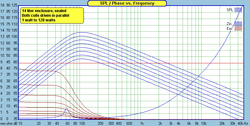

Ford Ranger My Subwoofer Build Kicker-43CWRT82-14liter_sealed_sim_1ohm
We see a single line at the bottom with a peak and a rising portion. That is impedance in the enclosure. The peak is the resonant frequency in the box (it rises when enclosed) and the rise is due to coil inductance. The next set of 8 lines is power doubling frequency response (blue) and excursion (brown). The blue response curve rolls off on both ends - upper end because of the woofer's large inductance and this curve shows that. The brown curve is how much the cone is moving - lower in frequency it moves more in mm, and higher in power it moves more also. For the 8 line sets, bottom is 1 watt. Then 2, 4, 8, 16, 32, 64 and 128 at the top.
The problem with this sealed box is extension. Power handling is fine, this woofer is +/- 8mm Xmax and I'm just using all of the amp's capability below 40 hz. But while the amp won't overpower the woofer in this configuration, There's not a whole lot of depth there. However there is a solution. The DXA125.2 has boost available at 40 hz, up to 12db. This could be used to bring up the drooping low end response if needed.
What it's not going to do however is solve the problem that this woofer is woefully inefficient on the low end, and you are going to use up both your power reserves and your Xmax very fast in this configuration. It's why I stayed away from the Kicker 11HS8 all in one powered sub. It's going to have the same issues. So with this in mind I started looking more at vented options.

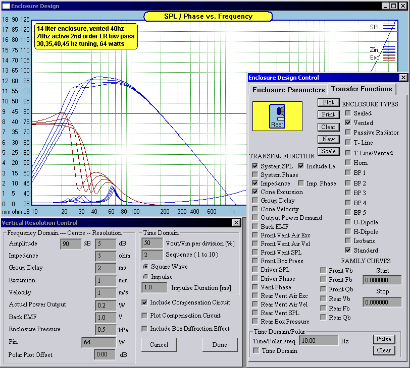

Ford Ranger My Subwoofer Build Kicker-43CWRT82-14liter_vented_40hz_sim_1ohm
Now this is a vented enclosure tuned to 40 Hz. What I like about this is the massive improvement in output with the lowering of excursion in the 35-55hz range. This is effectively giving me the output of two 8" woofers in the operating area of the tuning. The downsides are that the cone is unloading below the tuning frequency at 30hz and running out of excursion, and there is still a mild amount of upper bass peaking with this enclosure size. Both of these however will be addressed.

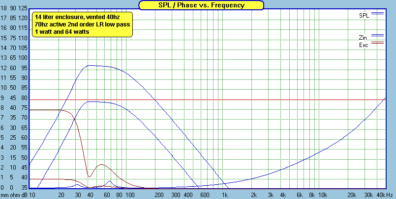

Ford Ranger My Subwoofer Build Kicker-43CWRT82-14liter_vented_40hz_LP
Now what I did here is added the low pass subwoofer crossover filter and integrated it into my sim. I built the active filter crossover cad section of my design software. It's a 2nd order Linkwitz Riley filter and I put the center frequency at 70 hz. Considering the rise in response there, effective crossover frequency (which would be the 6db down point) is about 120hz. At this point we're getting a very usable, deep response curve. The only concern is that I reach Xmax below the port's tuning frequency with half the amp's power. Everything is ok though. This amp has a 25hz 4th order subsonic filter. Let's see if I can model that and what it does to low end excursion with this tuning in this box.

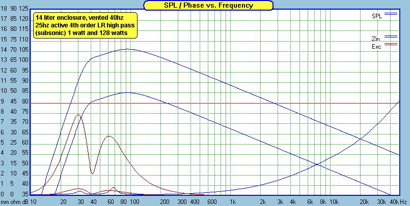

Ford Ranger My Subwoofer Build Kicker-43CWRT82-14liter_vented_40hz_subsonic
There we have it, with the subsonic filter this design is protected against overexcursion at the amp's maximum power and does not exceed Xmax at 30hz. Plot shows 1 watt output and 128 watt output. I think we have a winner here.
I have not been able to get both the active subsonic filter and the main 70hz crossover onto the circuit at the same time, but this software is complicated and I haven't mastered it. Plus I don't use it much anymore. I'm a mechanical engineer, not electrical.

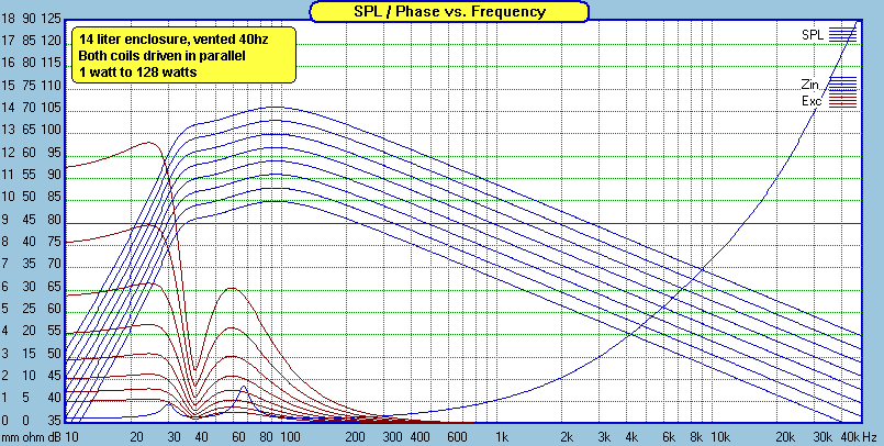

I played around with the tuning frequency to see if I liked any of the options, but I'll probably stick with 40 hz. Remember that the lowest string on a bass guitar is 40 hz and there's usually not a whole lot of music below that. This is with the 70 hz sub crossover, and varied tuning from 30-45hz.
Ford Ranger My Subwoofer Build Kicker-43CWRT82-14liter_vented_varhz_LP
I know the challenges await, like how to get the proper port length without making the vent area so small that vent mach speed becomes too high and chuffing and turbulence becomes an issue. The ports may be external of the enclosure, run along the bottom back corner of the cab and will likely have elliptical openings to smooth airflow. I may have to adjust crossover points, tuning and boost to adjust for cabin gain and for total overall response smoothness once I get an in-cab response curve.

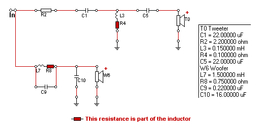

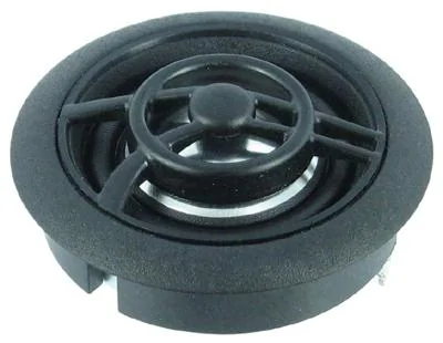

These are the tweeters I'll use. I've used them in car audio before and they are very nice. Low distortion, smooth response both on and off axis. I will remove my pillar pods, the OEM tweeters in them, make an opening with a hole saw and surface mount these. I assume the tweeter does not have it's own dedicated filtered amp channel, and likely just has a simple passive filter. (probably a single capacitor) I'll look into that when I get there.
Ford Ranger My Subwoofer Build h1397
Ford Ranger My Subwoofer Build h1397-freq
This is a crossover filter I've designed for this tweeter previously. (shown also with a woofer section) I will likely have to adjust sensitivity and corner frequency to work well with factory woofers.
