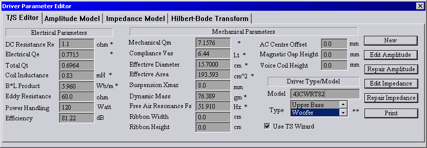

Kicker actually did list full T/S parameters on their web site, along with Xmax. I needed at least a little something to make a buying decision. Actual T/S measurements came out close enough, with Qts a little higher and Vas a little lower as is typical for most drivers and would probably be a bit closer after breakin. This one is only 2.7" depth. It's an inset magnet style of driver.
I haven't bought Kicker speakers in 25 years. Back then they held up ok but who knows how things are today. In any case they are cheap. If it falls apart I'll buy another one. I was tempted to go with a quality home audio woofer, but I just can't get one with suitable T/S parameters for a small enclosure. In my closet full of drivers I've actually got one of the best 8" woofers on the planet, (Scan Speak Revelator) but it requires a huge enclosure.
