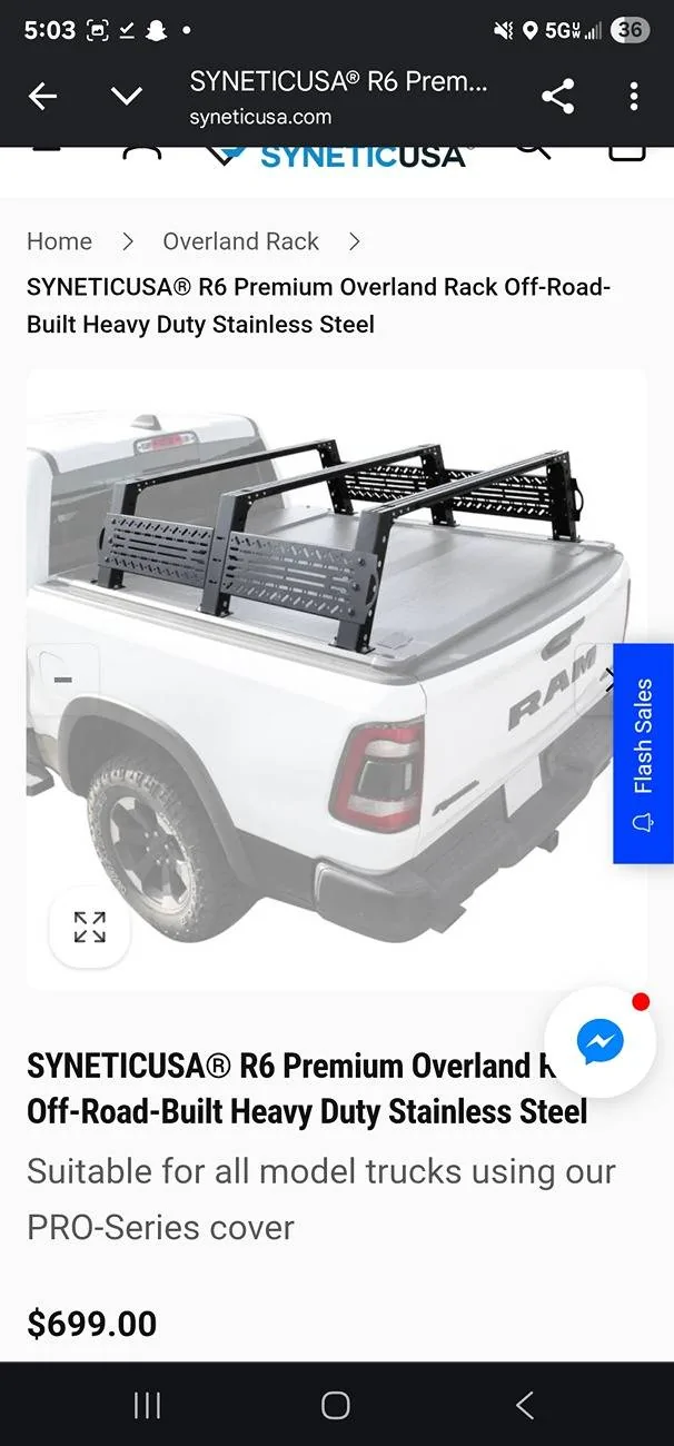

Hey guys, know it's been a while! Life is crazy like that. Reaching out to y'all for help.

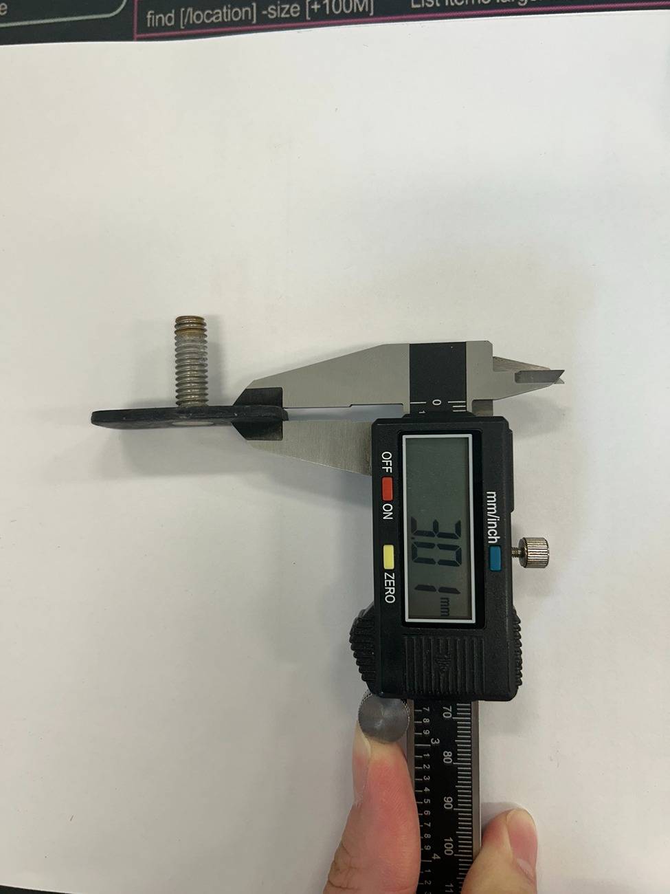

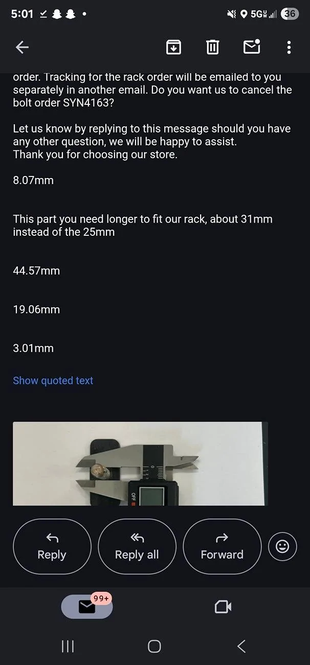

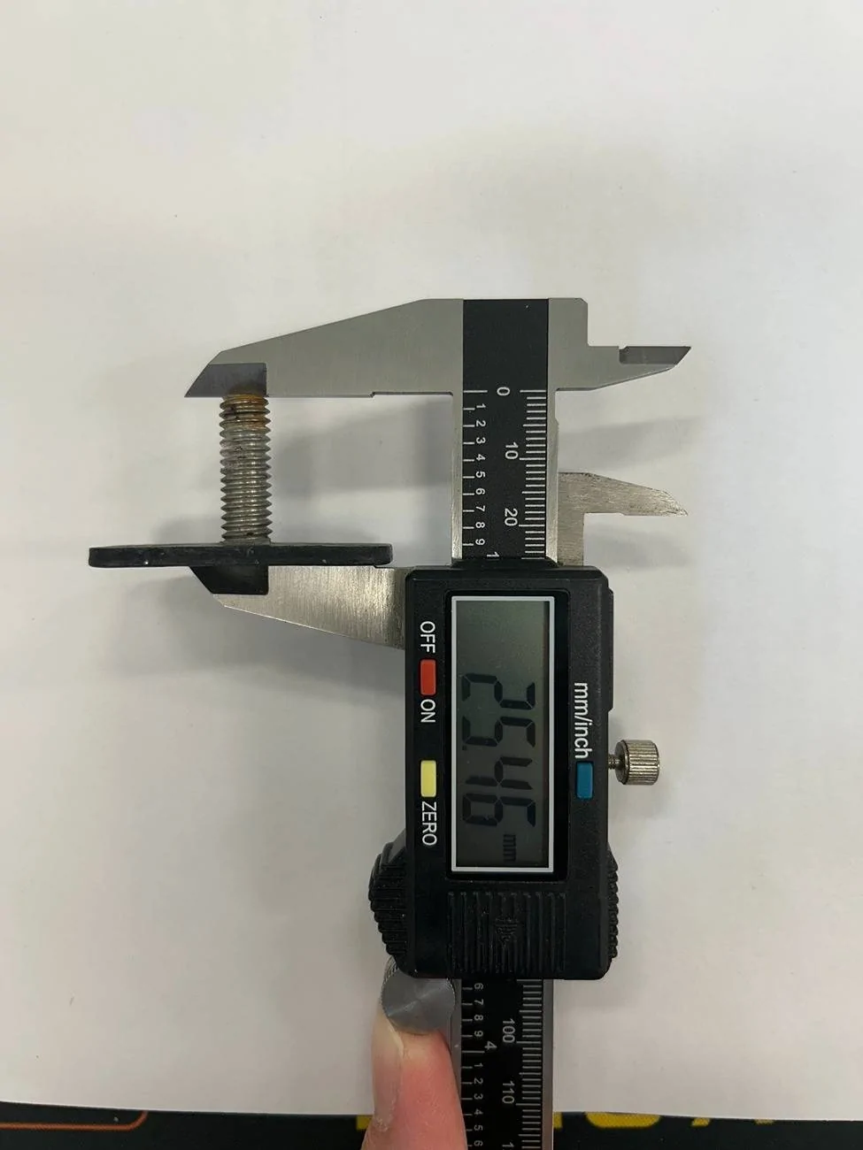

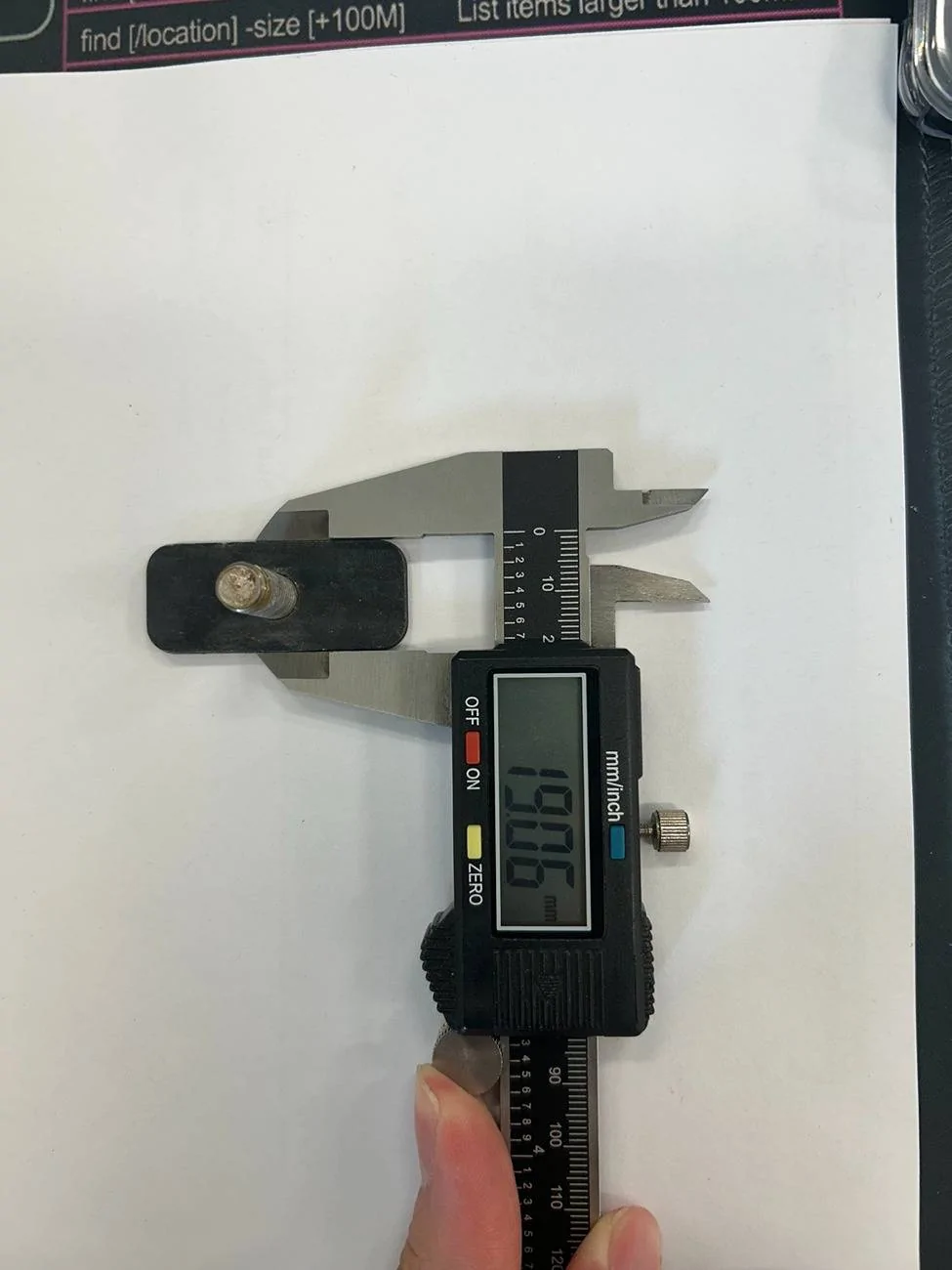

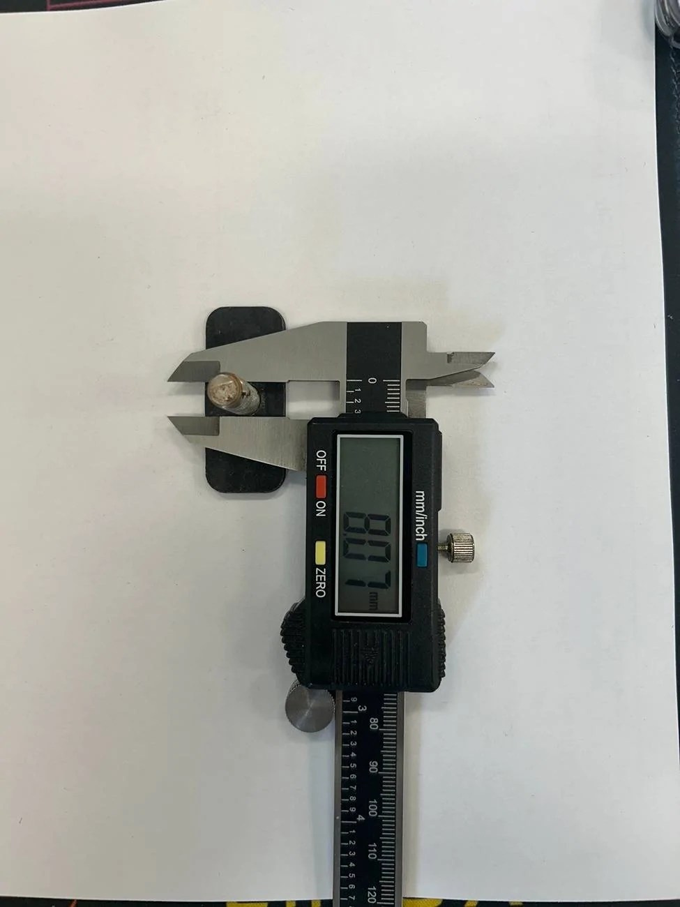

Ordered a synteticusa usa rack to go on my retrax cover. When ordered they initially had me order a kit to work with t slots. Have since been told that would be incompatible. Any help with some research would be appreciated

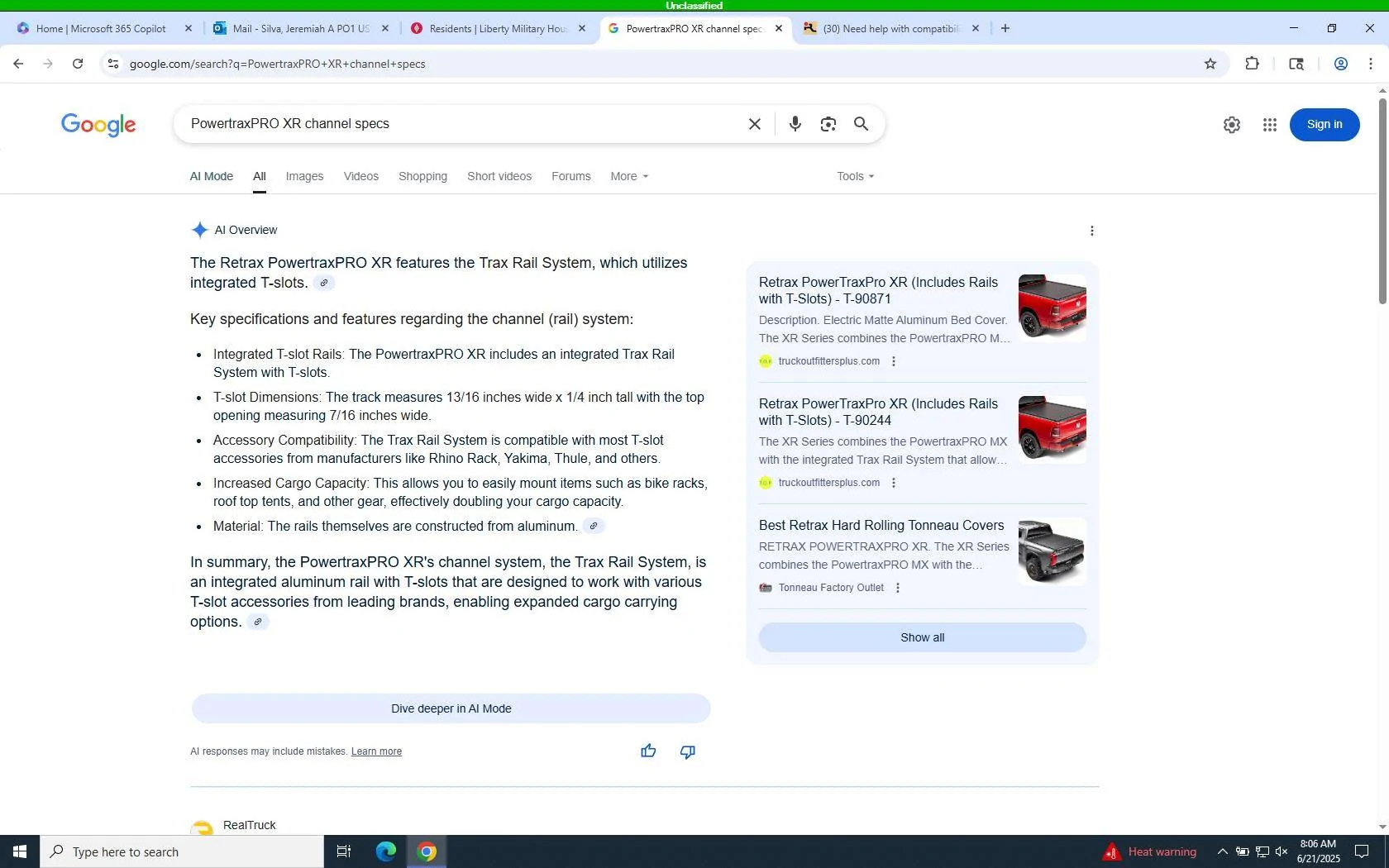

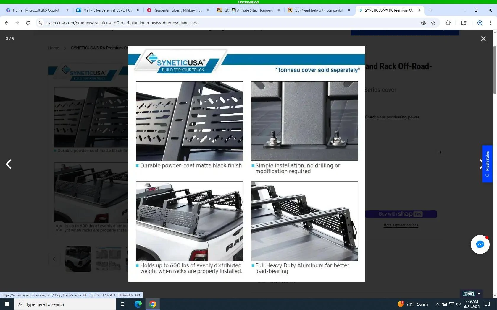

I believe it can, but it is designed to be installed using T Slot channel. that is the goal to utilize the channels on my retrax PowertraxPRO XR. Main reason I am asking for help, is because I am hard core Mr. Momming right now as well as working 80+ hrs a week. So wanting help researching for compatibility and utilization. That and i havent done alot of moddingyet and would like advice.
So far, i have found the following:
https://framingtech.com/products/t-...BcAuKsPmmALVRg2uDjEuaQ7l4zwWJb6fE18F_GWWj2SRf
https://www.amazon.com/Platform-Stainless-Adapter-M6x35mm-Thickness/dp/B0CKLVHPP4?th=1
https://www.amazon.com/T-Slot-Slidi...ontext&ref_=fplfs&utm_source=chatgpt.com&th=1
Any advice or suggestions is welcome and appreciated!

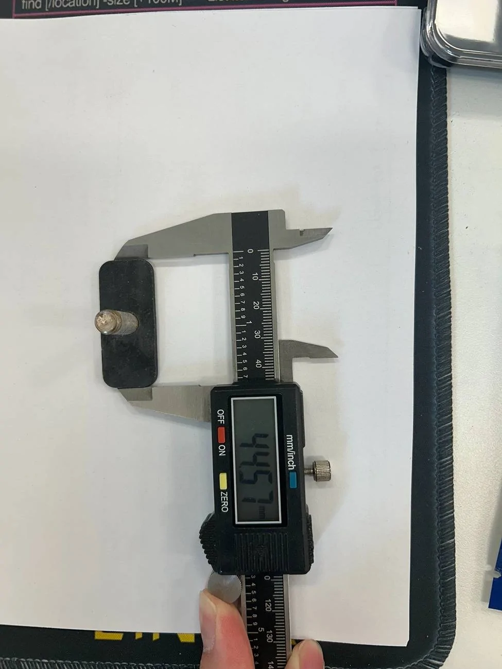

Well, first half down. Next figure out the how lol
