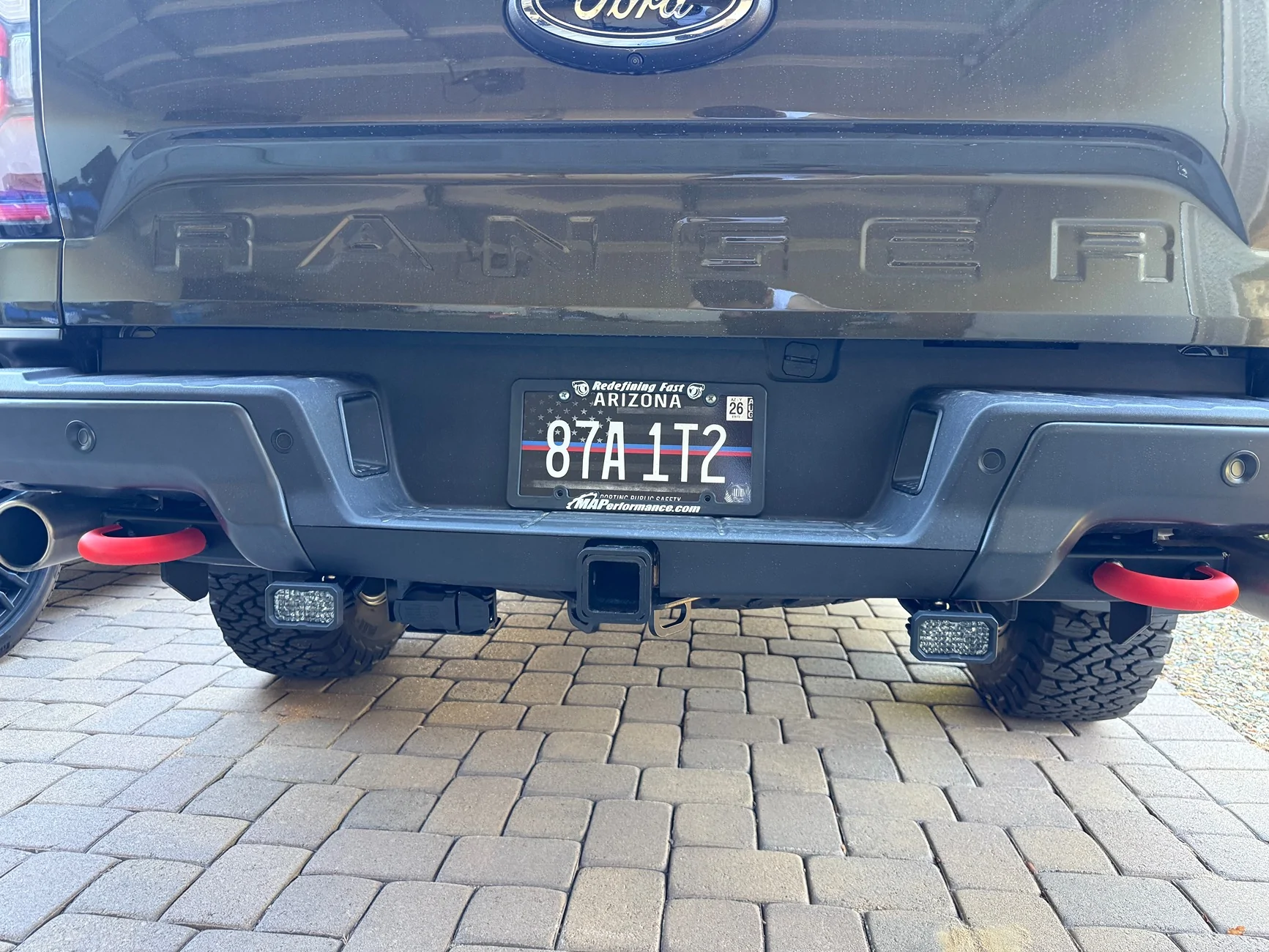

Now on the 4 backup lights here.
What is important is the light focus and Aim.
The Rigid SRL models are a wide spreader pattern. They aim wide and LOW. So they wouldn't aim up at another vehicle when on or backing up. So these are good safe courteous lights.
The Baja S1 and S2 lights are called "Wide Cornering" so they are basically similar in that way.
Both should be safe as far as if you wanted to have the automatic backup trigger (tail light adapter)
The one out of this mix that IS NOT fanned out low are the Diode Dynamics. They are called a flood. But they are a diffused pattern. Meaning the light goes UP, DOWN, LEFT, Right EVERYWHERE.
So if concerned. You would just stay away from those on the automatic trigger.
In any case. You can always just do the option to switches. This way you can turn them on and off manually when wanted. Such as to see behind you or to hook up a trailer.
