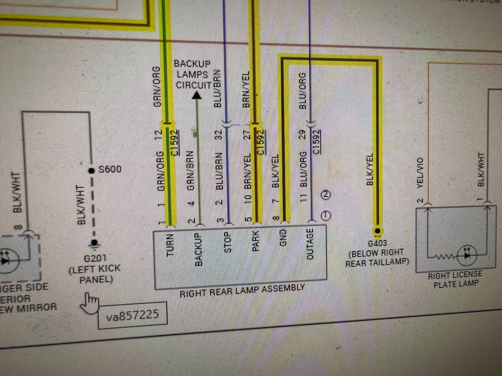

I want to add aux reverse lights with a relay triggered by the oem reverse light signal. It doesn’t appear that feature is specifically fused (tell me if I’m wrong) so since I can’t fusetap the relay im planning to tap the wire directly. Does anyone know the wire color for the reverse light? I should have gotten it when I paid for 24 hour access to the service manuals but I didn’t ?
Also, anyone know if there’s enough fuse capacity to tap a couple amps power from that wire or would I be better off just wiring to the relay and using aux power?
assuming I only need to tap one side.

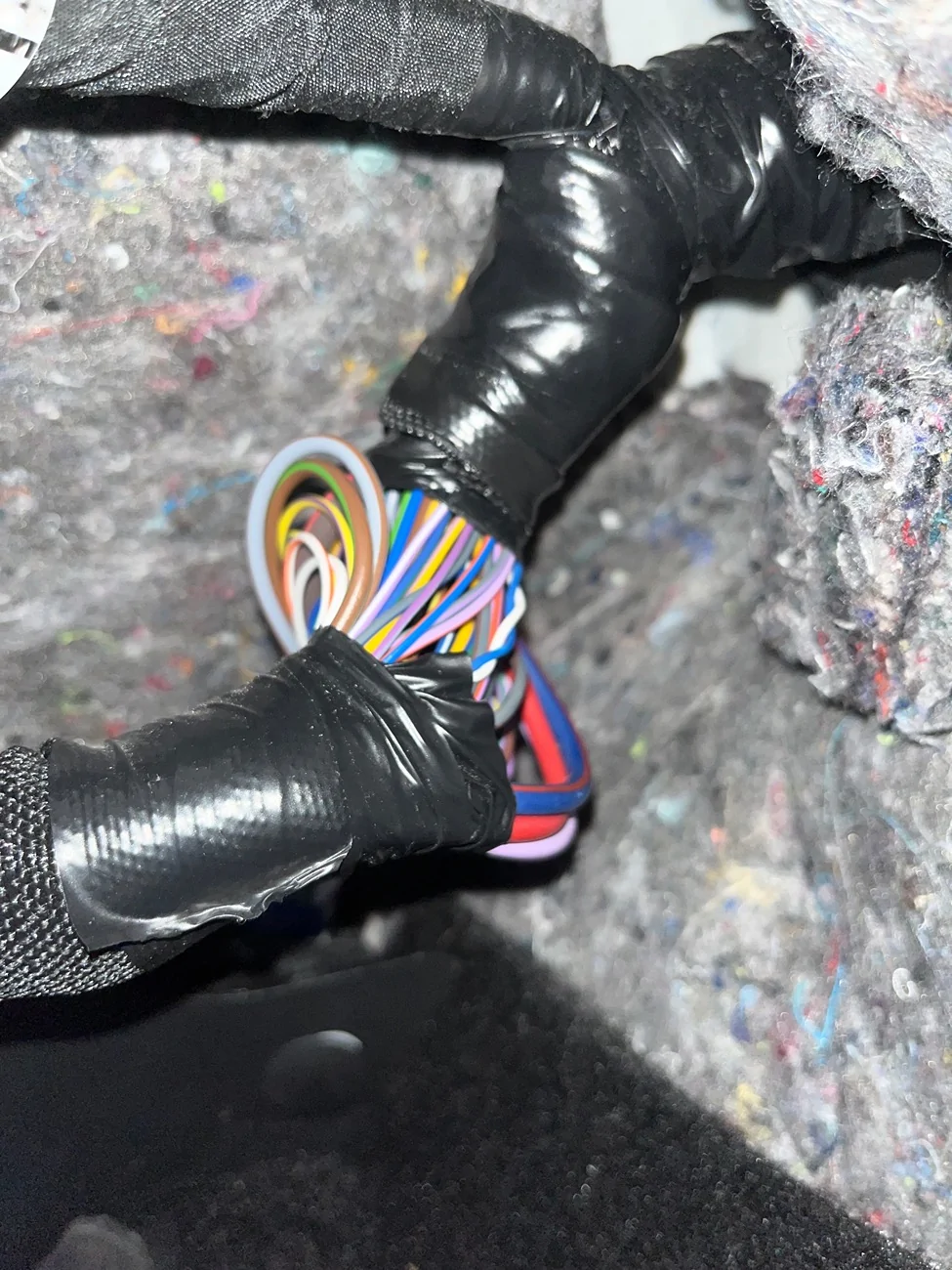

If you look down by the hitch on the outer side of it you will see a harness you can tap in there. The harness leading up to the tail lights it’s not going to help you, all the wires are black.

Thanks a lot. Looks like I’ll tap the green / brown wire there.
any idea if it’s fused with enough headroom to tap another 2 amps, or should I just play it safe and tap it to a relay and run power separately?

The harness comes straight from the BCM. I would run a relay and power.
